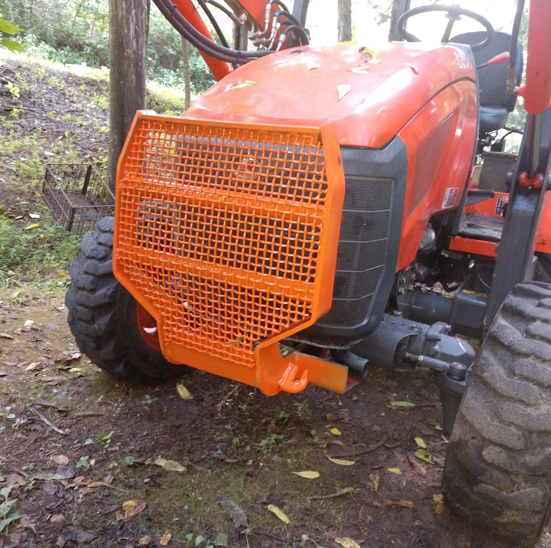

Quarry screen is some tough stuff and comes in different mesh size. Much stronger than expanded metal. Found my piece at the scrapyard too. Grapple lots of brush and trees.
I paid $40 for a 4x4’ piece which was enough to build the brush guard, fix the back window guard on my dump truck and still have half or so of it left. I was pretty happy with that purchase.

BIL made a grill guard from the quarry screen drop.

Not that I have seen but haven’t asked. They probably don’t carry it but know who might. Specialty metal, abrasion resistant, AR of some type. 1/4” wires easily cut with side grinder cutting wheel. No problem to weld.
Quarries, top soil sellers, mining or cement plants might be a source. Surprised at the variety of metal and tractor stuff on marketplace. The inventory at the scrap yard changes to. $0.30/# I bring too much stuff home.
Had over a hundred trees damaged by tornado last year. Have had several stems spring pole and hit the tractor while stacking and pushing piles. No damage to quarry screen or tractor.

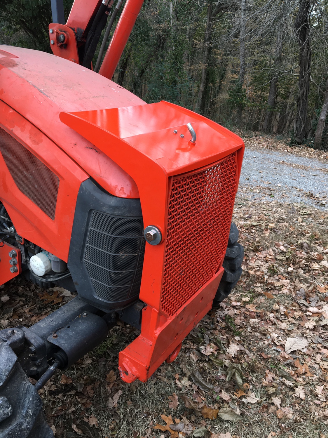

They may have 10ga. lobster pot wire, and that could work for me, since I already do have a very robust radiator guard, for it to be mounted on.
I just need an inexpensive way to cover that guard frame with something, to keep the smaller branches/sticks well away from the radiator.
   / Grand L grill guard #29
I think I used 9ga 3/4" flattened expanded on my previous tractor. Very sturdy and small enough to keep sticks out but you can still see through it. This has yet to bubble up to the top of the priority list on the current tractor...Probably until it is too late!
