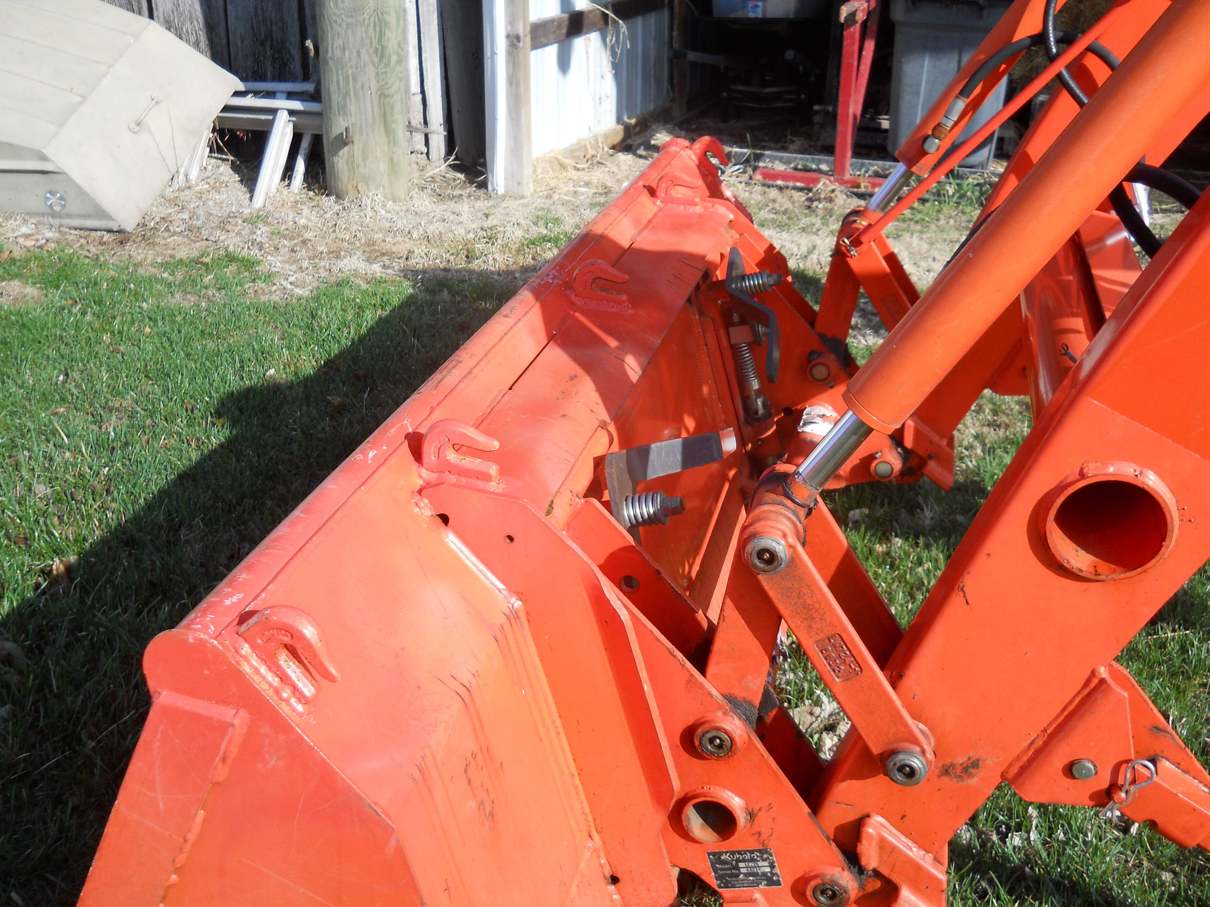

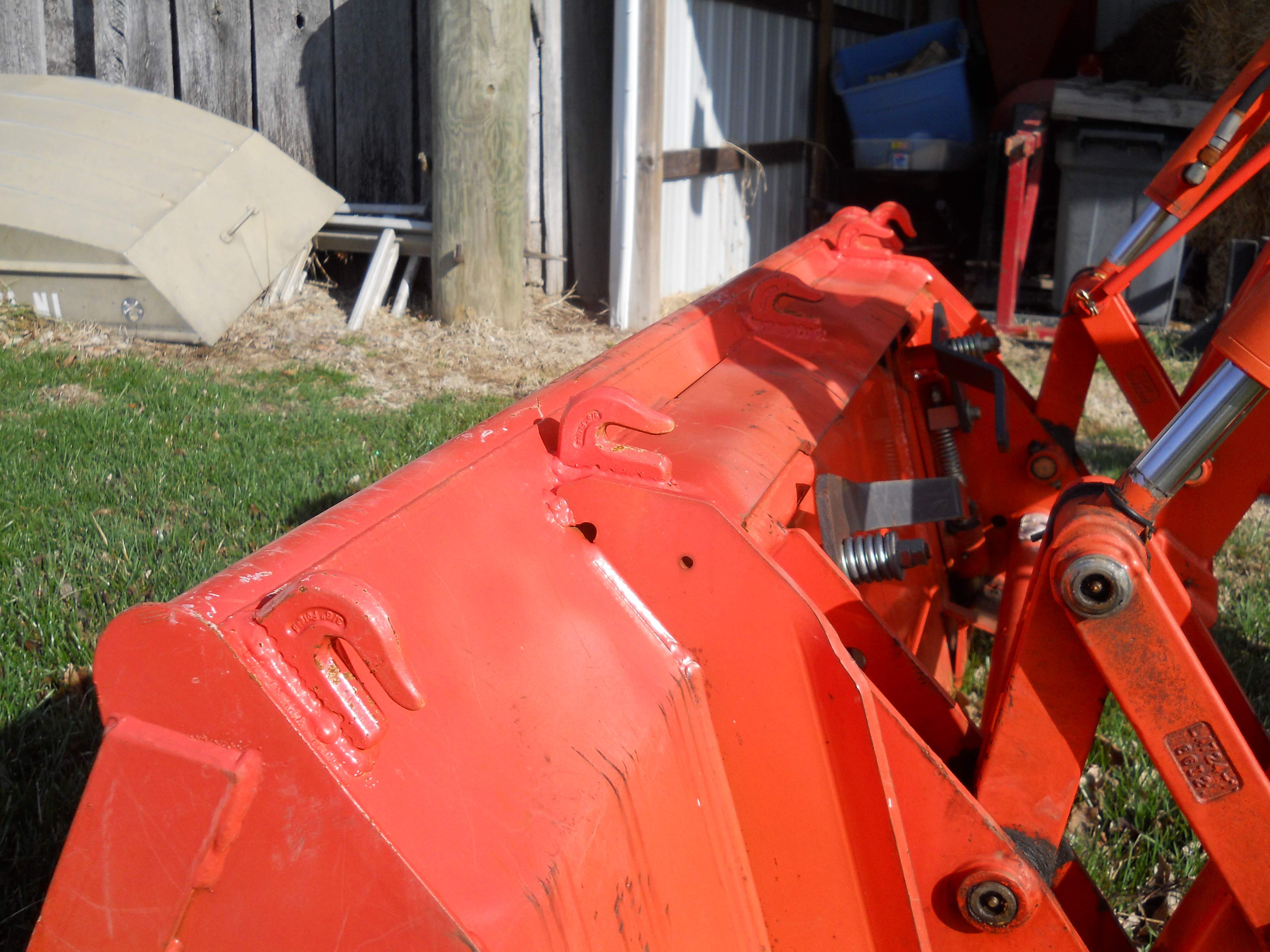

I was looking at another thread and found pictures and specs on the buckets. The standard duty and heavy duty are the same capacity.
Another question I had is what kind of couplers do they put on the loader for the 3rd function?
   / Grand L #10
The heavy duty round back bucket is same capacity, but built much stronger. Here is mine. Philip.
