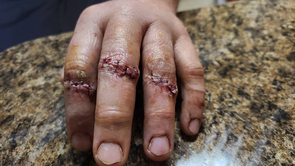

5 min of inconvenience would have prevented this mistake. So far I am lucky in that no fingers were severed just lacerated! And so far feeling and movement is still there.
This happend on Saturday from a chop saw of which I just put a finishing blade on to make a few cuts. Thinking ill use it for a few cuts and take it back off for the ripping blade. After my cut I let off the trigger and went for my cut wood and when pulling back I caught the blade with the top side of my fingers.
Stressed wife, stressed kids, ER visit. And now going to hire a helper to finish my flooring project.
5 minutes, folks! Perhaps even less to make it as safe as it could be. All please be careful in our usage of tools that we use often, I think we get complacent in their use and disregard the dangers from time to time.

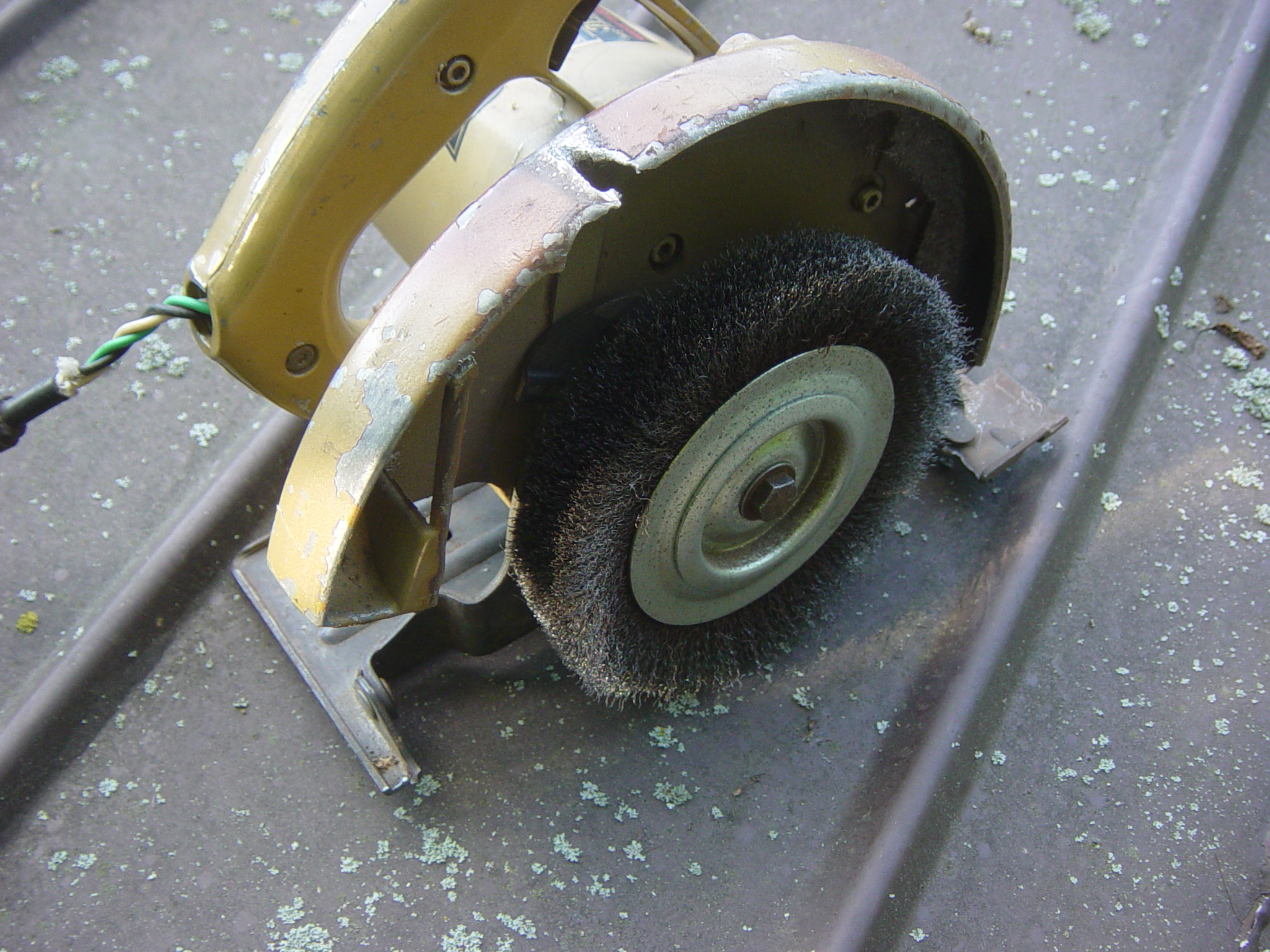

This DID have a saw blade on it and was my go to saw for many years. Replaced by a cordless. Now this was used to clean up seams on a steel roof. Friends always called it my OSHA saw!

Don't wear a hoodie with strings dangling while using that. Eeek
   / *graphic warning* Saw safety, replace guards! #4
rule of thumb on any rotary saw....
always wait till the blade stops before removing wood or before putting hands in the blade area.
most all saws have some kind of brake to stop the blade after power to the saw is cutoff (like the finger switch on a miter saw or circular saw
   / *graphic warning* Saw safety, replace guards! #5
Especially on mine! Always knew to wait for the blade to stop, before setting it down. Keeps the mind sharp though! No wiggle room for daydreaming. YET, I don't like getting within a mile of a table saw!
The outer insulation missing off the wires are a nice touch!
