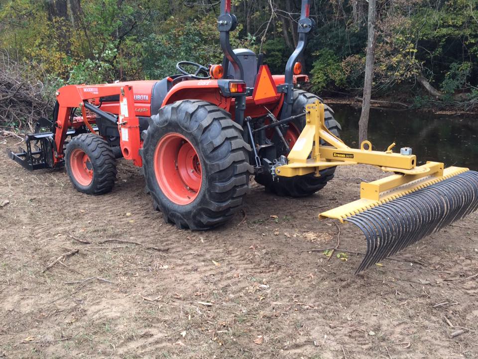

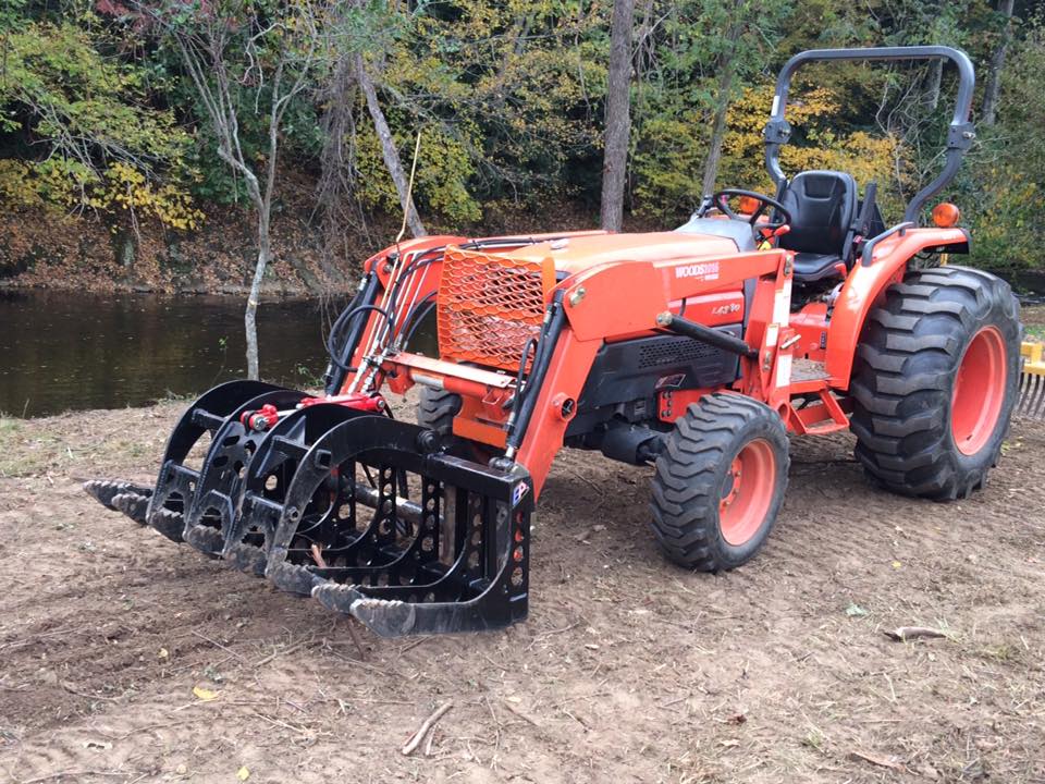

These pics of a 4330 with a 60" Single Lid Wicked Grapple were recently shared in there.
Wicked Grapple on the front and EA Landscape Rake on the back!
The ULTIMATE combo for cleaning up!

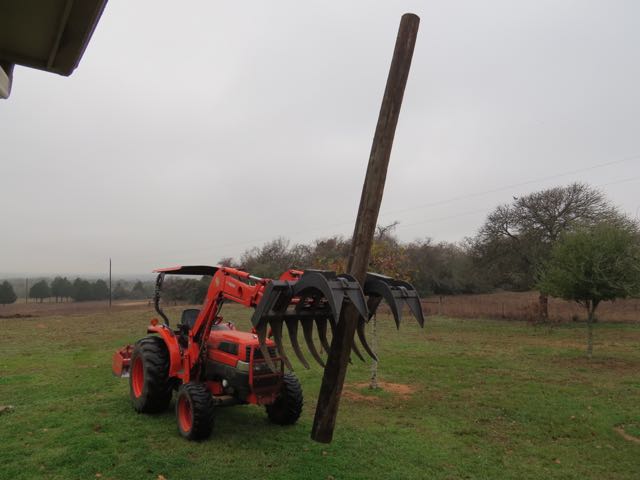

Most of us like a grapple the same width as our FRONT tires, Which is less than bucket size so I would go with the 54". My bucket is 72" my grapple is 52" on my Kubota L5030. The dual lid, like I have, is good for setting tall poles/post and secures off size loads better. Here is a pic of my dual lid grapple setting a tall post. The lids stabilizes the post side motion so just one chain is required.
