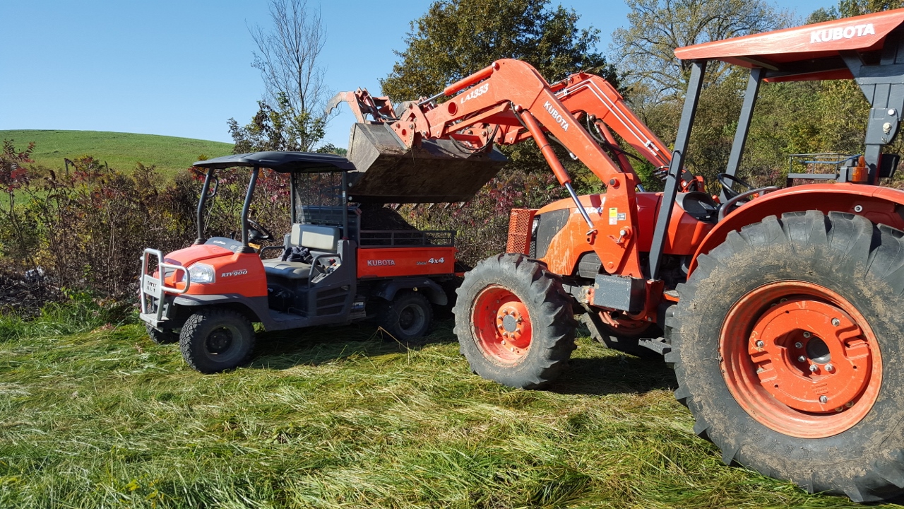

The pict. you show, is of a bucket dumping "dirt"... Mine won't hold water either. lol
That's 1. thing I can't do with my pallet forks/grapple, but you don't have a dedicated grapple, you have a bucket with a grapple...
I thought were comparing my combo to a dedicated grapple ?, yes, no?

Txdon, as for raking, I can see you have never used a set of GOOD pallet forks... Keep in mind, mine aren't on one of my tinker toy tractors...
I list my tractors in the my avatar. Please list yours so we don't have to guess the size your tinker toy tractors are as opposed to your real tractors.

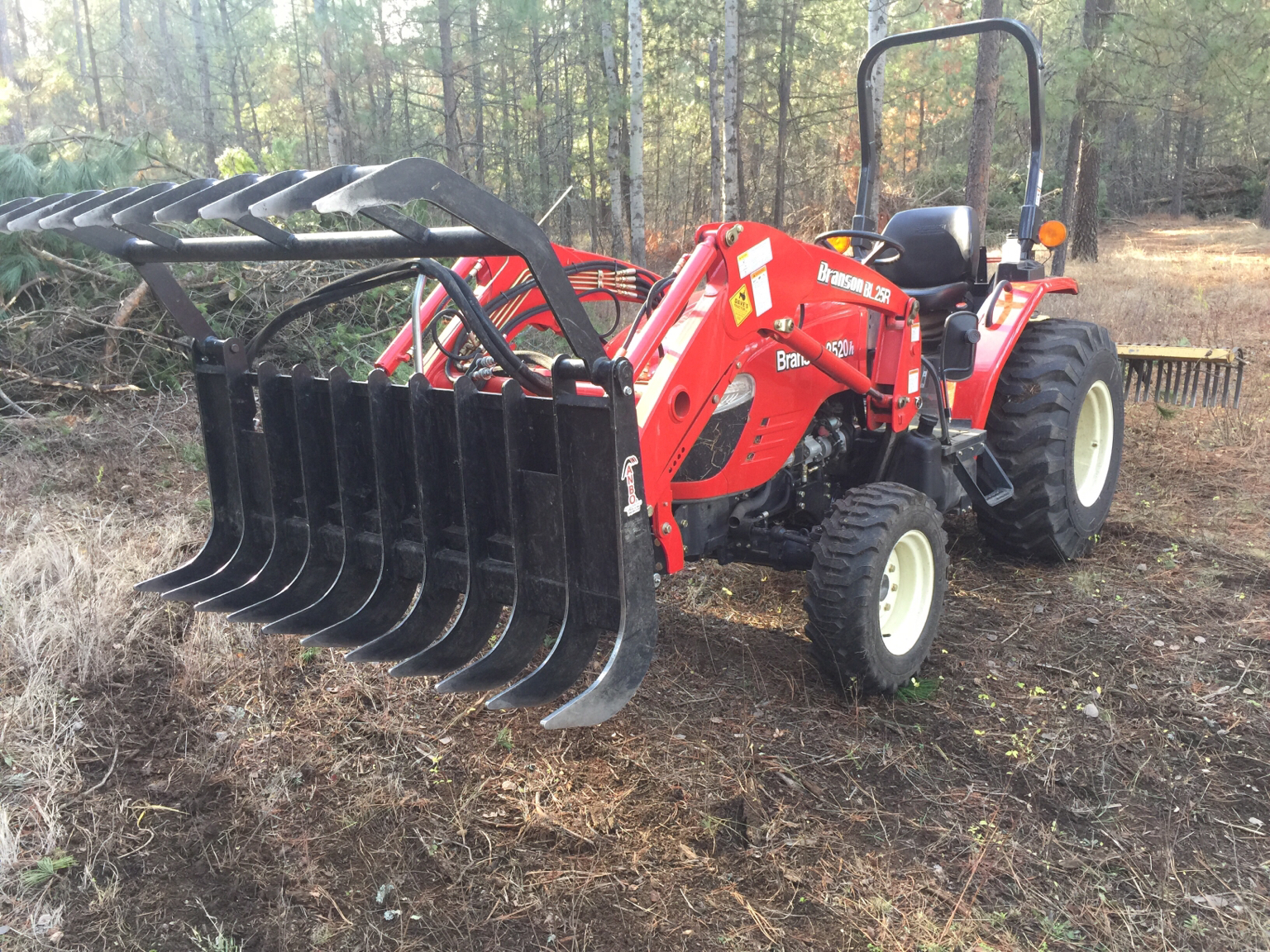

I found a "new to me" style of grapple tonight. It's a conforming grapple.
Bruce
   / Grapple Advice: single lid or dual lid? #58
I have a 60" single lid, full width grapple by Anbo with 6" teeth spacing. The steel is of importance, it's AR400 steel which makes it lighter yet much stronger. I've picked up stuff that puts ridiculous twisting forces that I thought would deform the teeth but it remained perfectly straight. Raking it using the top teeth is what this grapple is designed to do without damage to the cylinders.
My advice to you is to ask yourself what your grapple is expected to do for you. I needed mine to pick up slash piles (picks up EVERY branch) and move logs, sometimes from hard to reach locations so the AR400 steel comes in handy to bite a corner of the log for me to drag/position before picking it up squarely.
Don't choose based on price, choose the RIGHT grapple you need.
