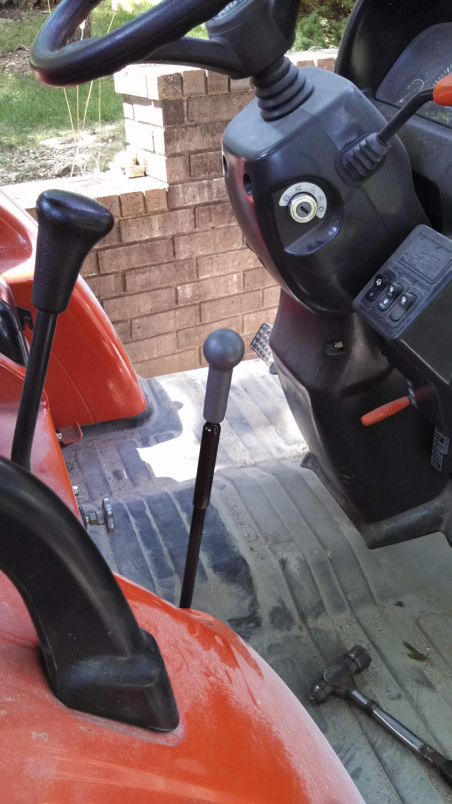

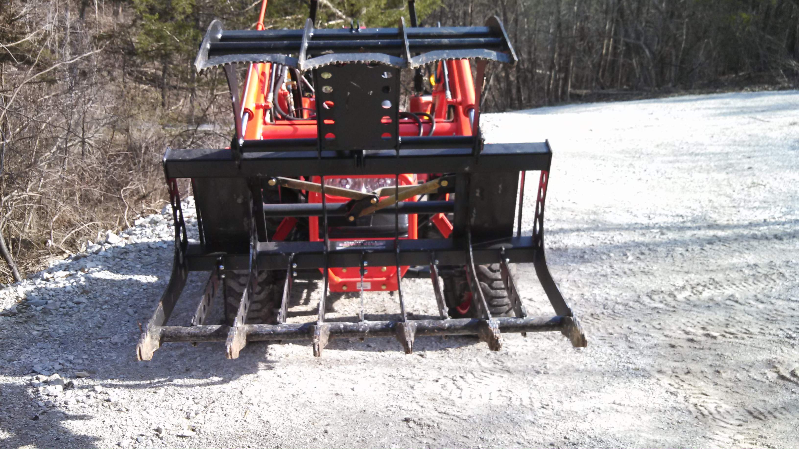

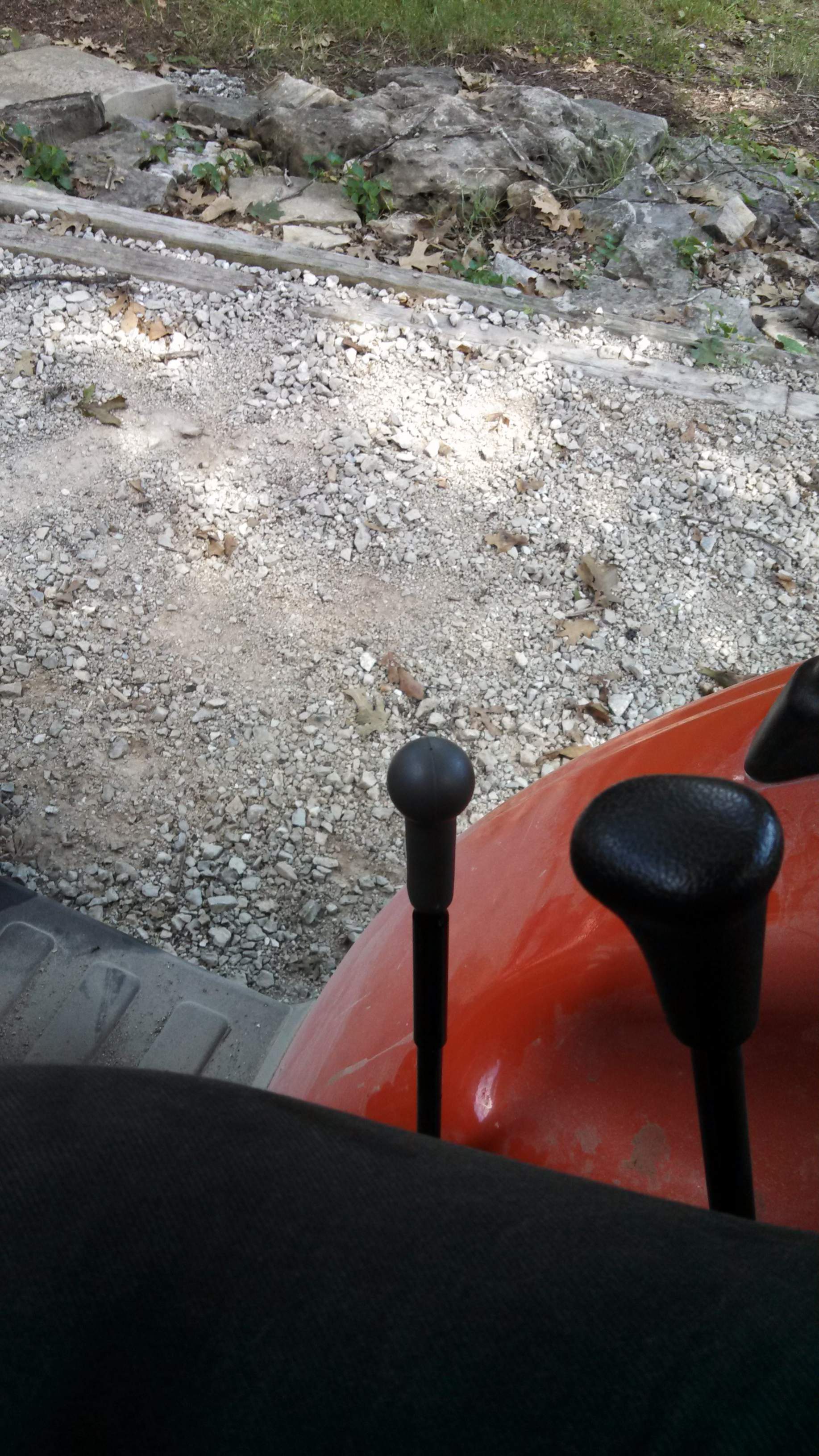

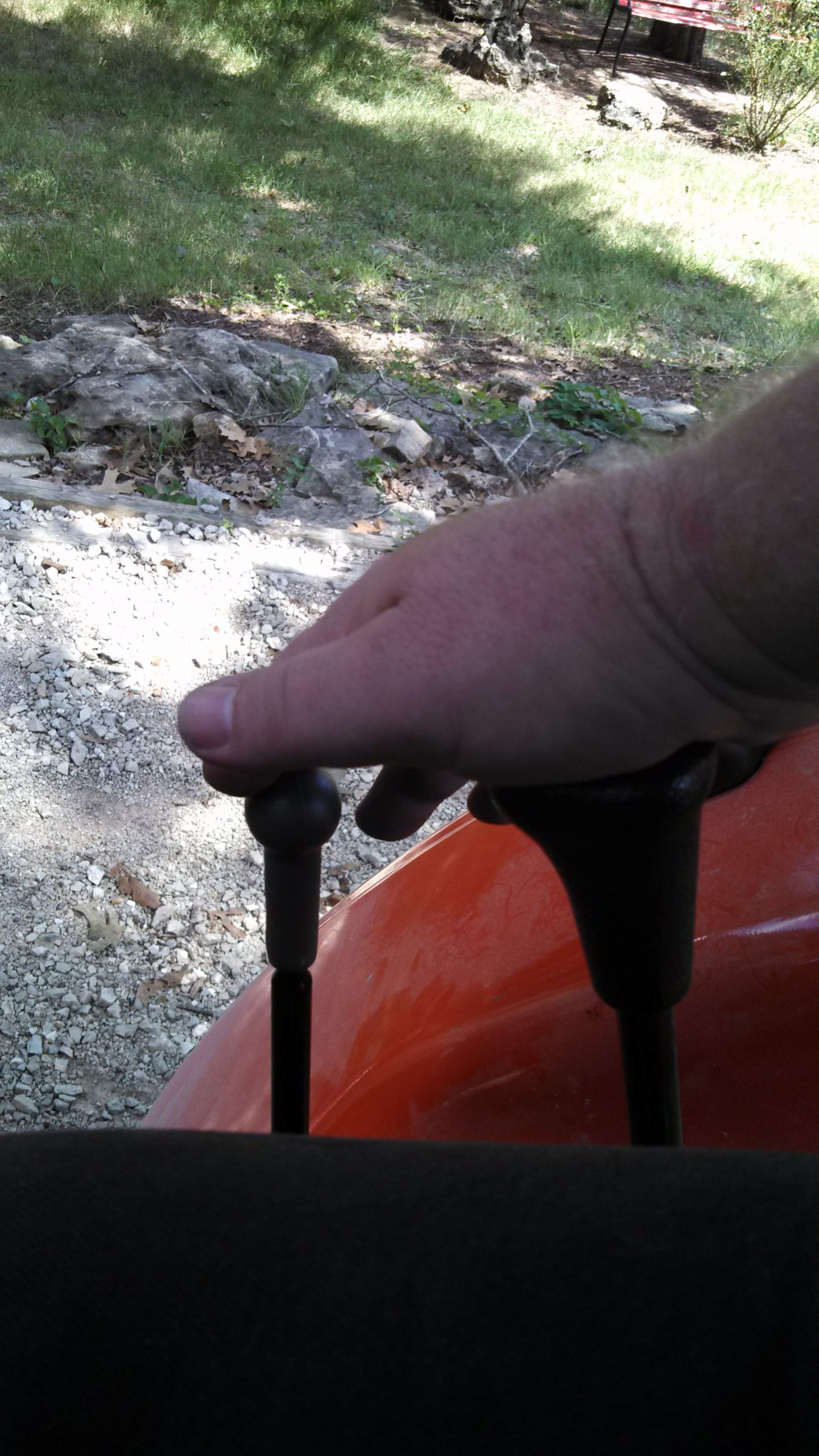

L shaped grapple. Narrow width. Single lid. Run hoses from rear remote on a Kioti as its control valve is convenient to use (especially after you lengthen it.)

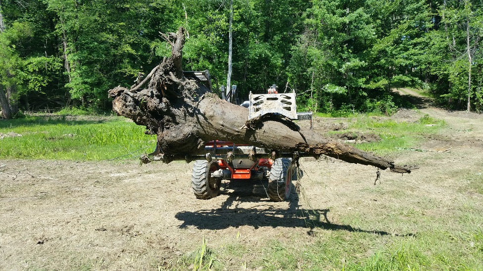

When I choose a grapple I looked at what others in the area had and how they were using them. I got a Land Pride SGC1560 and had a new joy stick installed with the controls on it. It has a WR Long third function valve installed. Its a single lid grapple and has done everything I want to do. I never have the occasion to move a root wad like pictured above. I gather up brush, limbs,small trees, appropriate sized big chunks of pine trees and the occasional very large boulder. I also use the unit to "back drag" and loosen, level and move the ultra hard sod.
I've found that this grapple is extremely heavy duty and is able to hold up under some very difficult situations. That being said - the grapple is quite heavy(820 lbs) due to its materials and construction. I would rather have a HD grapple and loose a little lifting capacity than one of lighter build and have it twist up like a pretzel.

I will say this, I set my EA grapple up with using the rear remote and after lengthening the control valve lever it worked far better than I could have even hoped. It is very convenient to use and I like the ability to "feather" the clamping pressure as you can do with any manually controlled valve. The reason I like to do this is that it allows me to pickup small limbs and small rocks without crushing them. I don't think you are going to be able to do that quite as well with an electric/hydraulic setup.
I set up with the rear remote in the beginning as a cheap "stop gap" method to get me going and thinking if need be I would switch to a electric/hydraulic control valve at a later time. But after having used it for some time. I have zero desire to do this. And not just because of the expense, but because I am so very satisfied with how the grapple operates with my current setup.

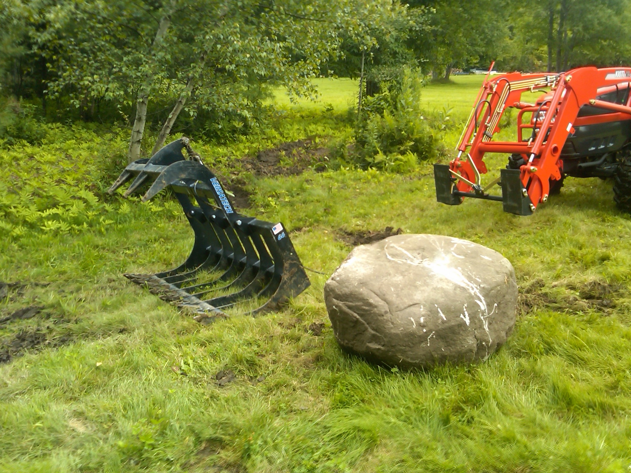

I recently got a grapple for my L3700. I looked at numerous different sizes and shapes before deciding on this. .. I bought and installed a WR long 3rd function valve. ( very easy ) and it was about 800.00 with all hoses brackets and connectors. I then turned to the grapple choices, Keeping in mind how often I would be using it and what for, I decided in a skeleton bucket design, that is also known as a rock bucket. (72" wide. ) single lid and the back is see through which is a enormous help when picking up stuff. The bucket itself is a Tomohawk brand, it is not "industrial strength but more that adequate for my needs. Because it is significantly lighter than many other type buckets, it allows me to lift heavier objects.
