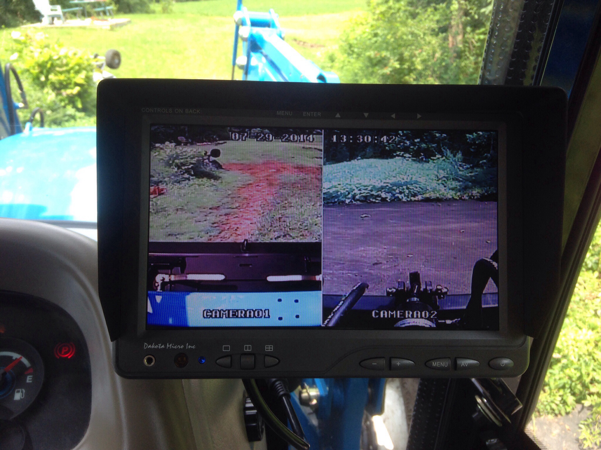

My tractor is 88 hp and has 3500 lb lift on the FEL. I have had zero problems with my Titan bucket. It locks up tight on the SSQA and has replaceable teeth and I haven't bent or broken anything, yet. I'm no steel expert but it seems to be of good construction and the welds look fine but I have no idea on the country of origin.
Putting a camera on the front of the tractor speeds up the stump removal exponentially, that's for sure.

That is a lot bigger HP wise than my tractor, but I think I should be ok. I read on another post that the lift capacity for my loader is 3050 lbs, breakout is 4360 lbs. I try to stay less than 2000# because it is old, and I have already had some frame cracks re-welded.
What type of camera did you use and where did you mount it?
   / Grapple and stump bucket recommendations for a Ford 4600 W/ 735 loader #16
I bought an AgCam, mounted one camera on the rear and one on the brush guard. Cameras are high quality and rugged, monitor is so so but resolution for both is average at best. I still haven't been able to dial in the color yet. Price was high ($1600 retail) and I think there are much better options for a lot less money. Search out backup cameras. Good luck!
