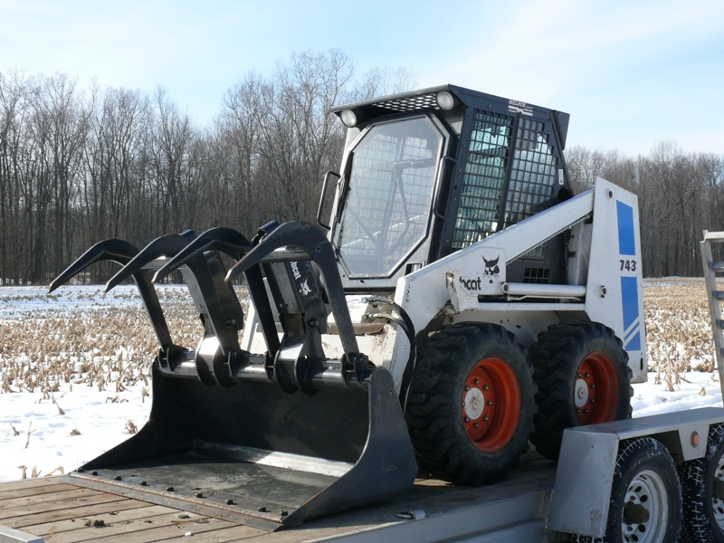

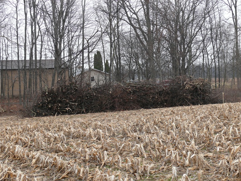

Went through the same delimma a couple years ago, cutting dead Ash trees, the brush was piling up so bad one couldn't move around in the woods. I had used the grapple rake type and while it worked good, small stuff fell through the bars while moving a load and branches were forever poking back at the machine causing the brush to become stuck in the rake. In & out of the loader quite often to remove debris.
Ended up getting the Bobcat industrial grapple bucket, solid back and bottom. Hangers are few an far between, I can also do dirtwork if needed while in the woods without changing attachments. I did add teeth to the bucket so I can rake with it.
As you can see in the pic, there was quite a bit of brush to move.
Ed

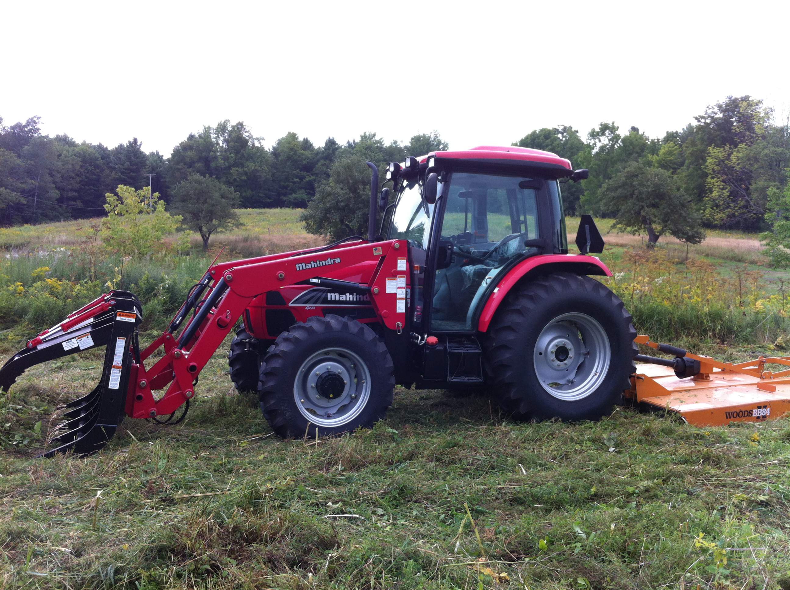

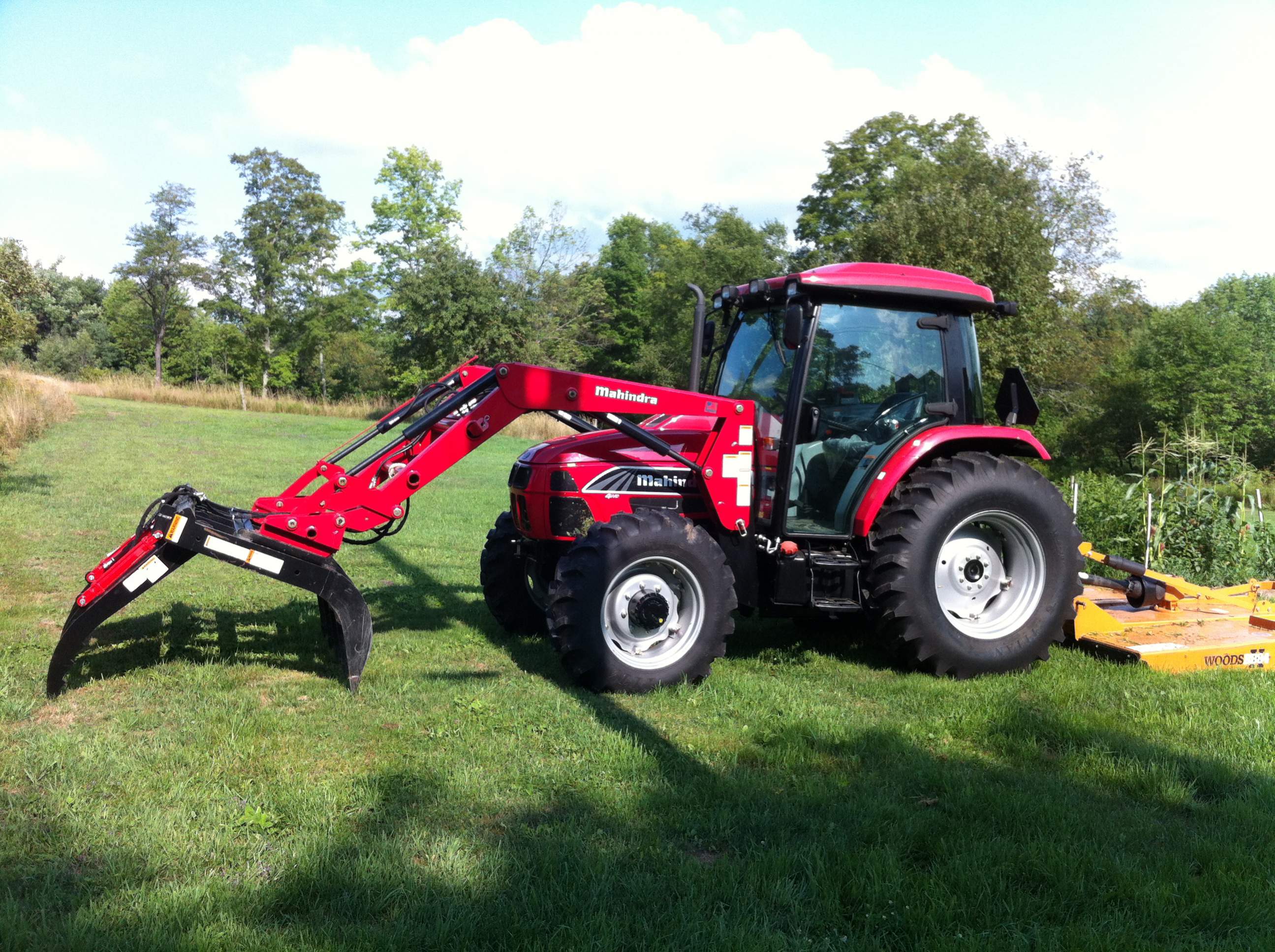

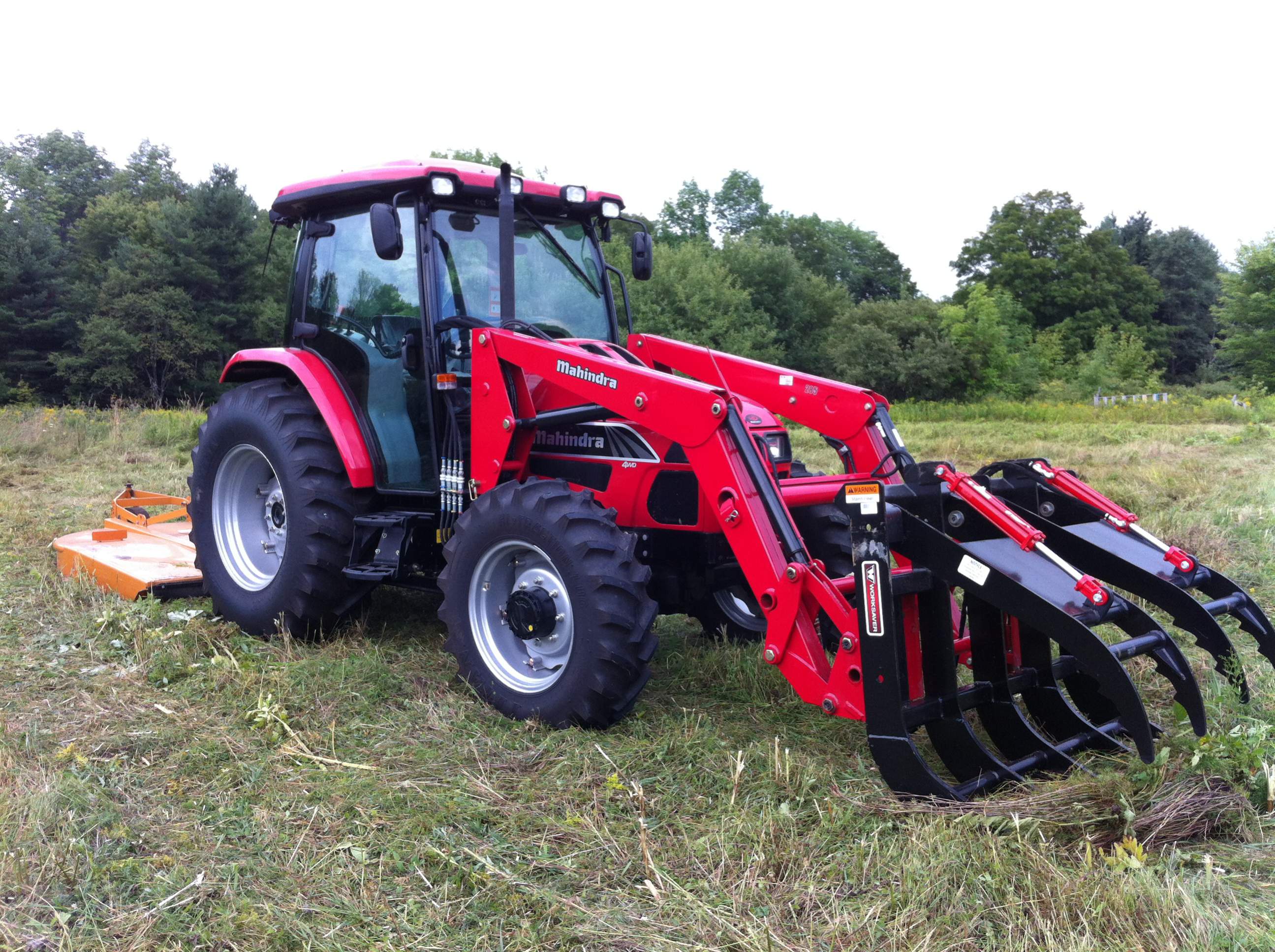

I went with the Split top grapple rake by worksaver - Worksaver Split Grapple for Skid Steer and Front Loader
I've pulled very large rocks from the ground as well as move a number of logs, stumps, branches into piles with it. I've recently cut a number of fields I've never been on before and used the grapple to slide on the ground to help flush out objects that would have hurt the brush hog. I looked at all models out there and finally decided on this one due to the heavy duty build and the split top allowing you to grab odd shaped items. photo14.jpgphoto17.jpgphoto12.jpg

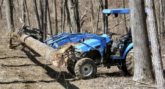

I used a bolt on grapple because I didn't want to give up the use of the bucket but still wanted to be able to lift fallen trees and large rocks. I consider the grapple to be one of the most useful additions made to the tractor.
