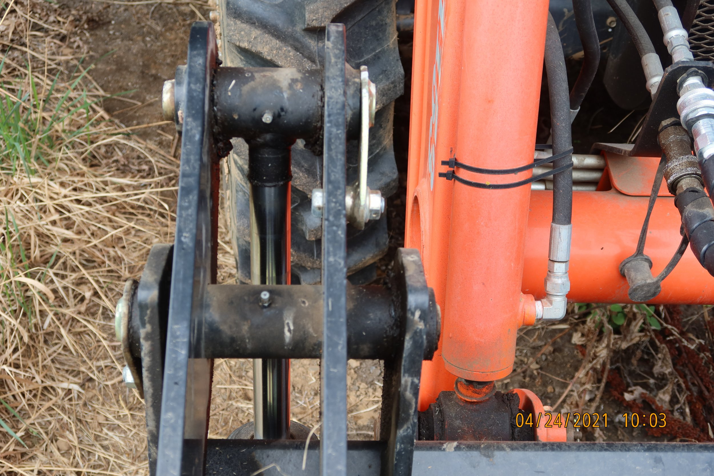

If I were building my own - the pins would be bolts. Six sided head with washer on one end - nylock nut with washer on the other. As you can see in the picture I posted - Land Pride, like many others, uses some form of bushed out head on one end and a keeper system on the other end. Seems overly complicated, but it works.

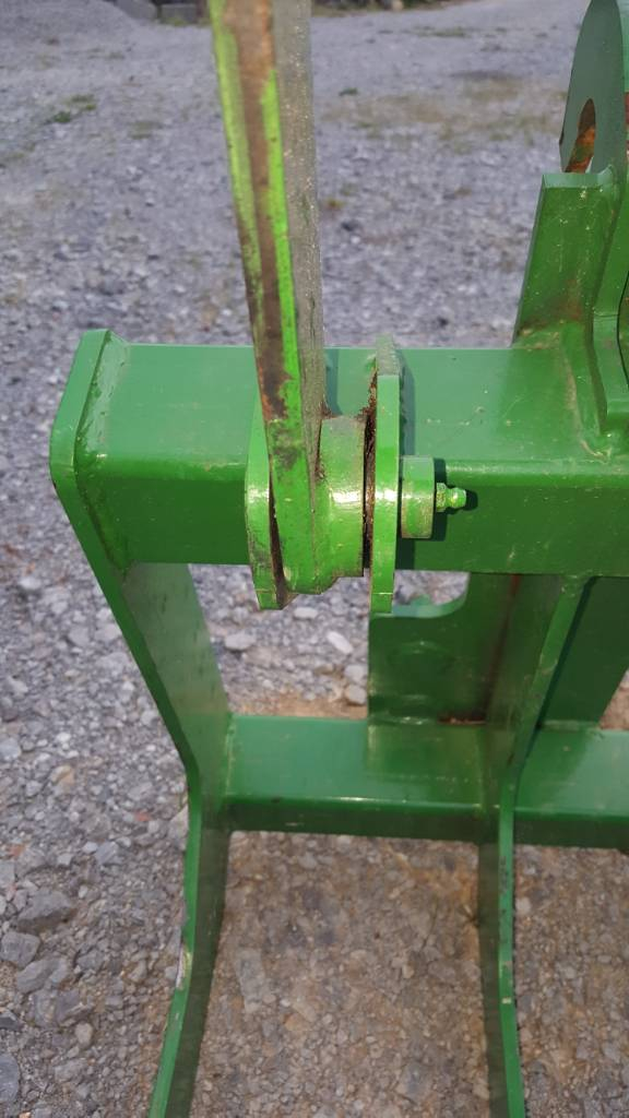

WHOA!!! Greasing. This is how it's been done on my Land Pride grapple. The carrier pipe is drilled & tapped and grease zerk installed at the half way point on the carrier pipe. I grease - grease comes out both ends of the carrier pipe. I call it a carrier pipe because I don't know what else to call it. What you are seeing here - the back connection> where the hydraulic ram connects to the upper lid. The forward connection> where the upper lid connects to and pivots on the body of the grapple.

Mine grapple is not built like that, so I must bore each pin, for a zerk at one end

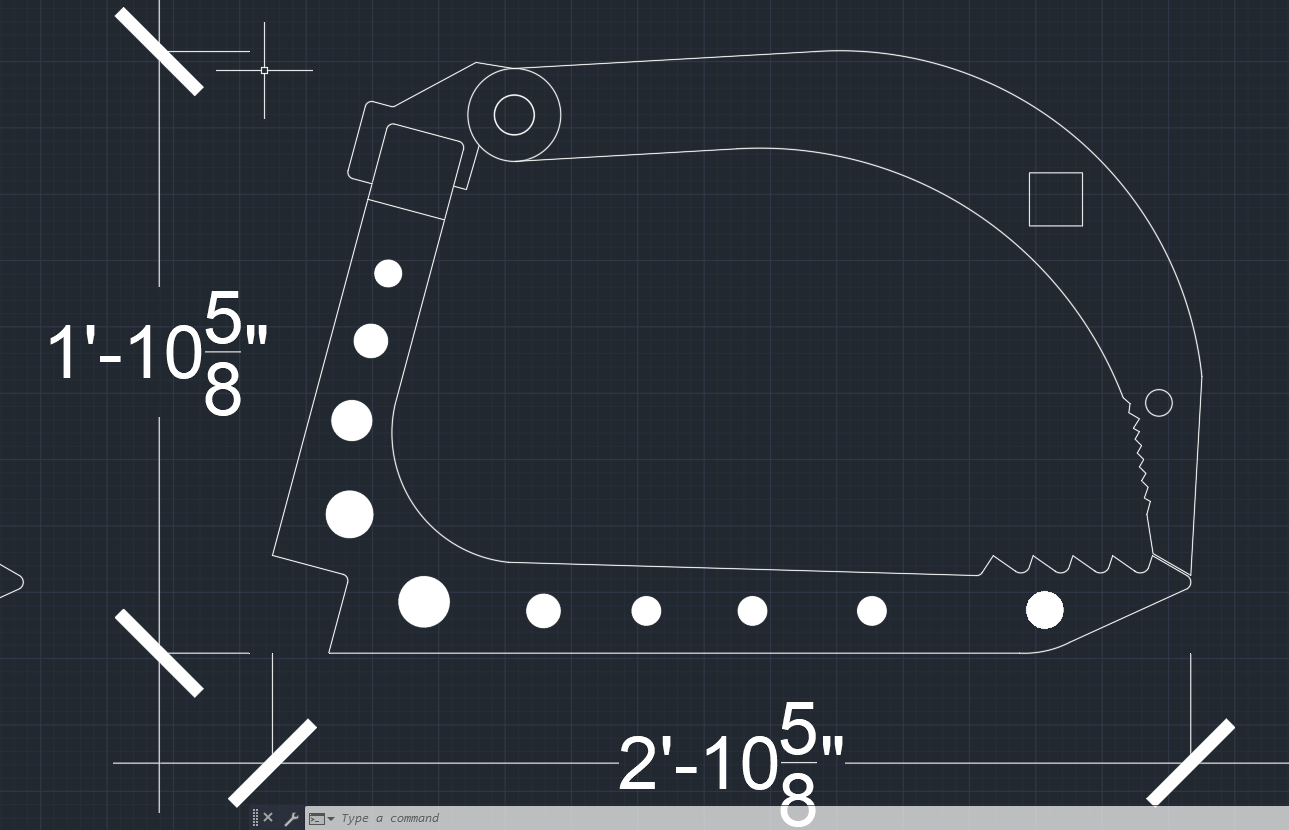

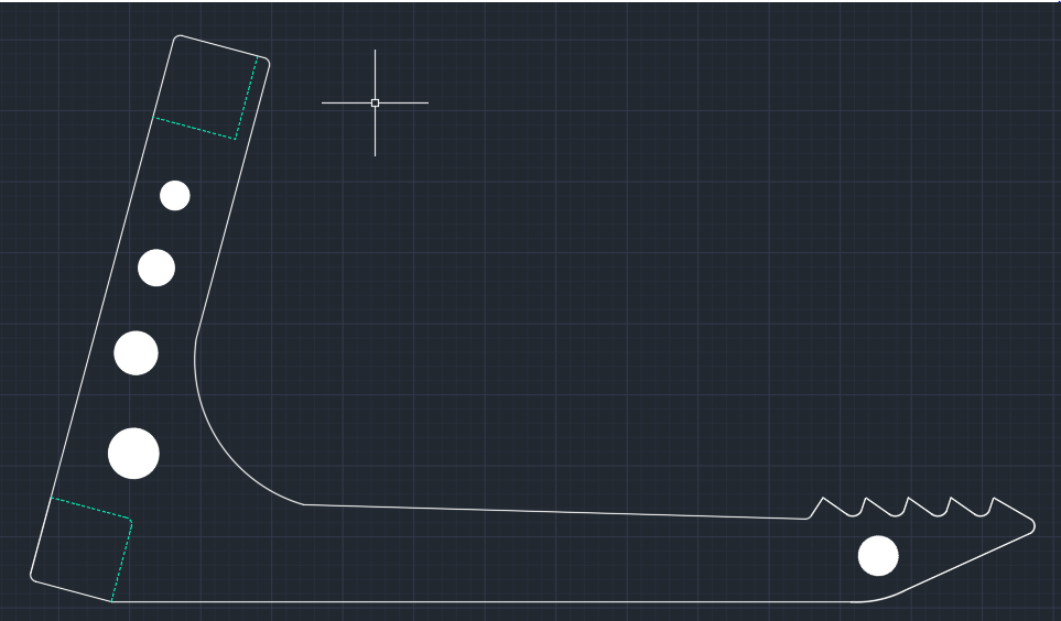

This is my design so far. I'm still working on proportions and I'm trying to make sure I have enough thickness in the right spots. This is modeled after multiple grapples I've been able to find and I think it's the right size. I struggle a bit with the overall lower tine length and the total jaw opening. The outer tines will be a little different and will be slightly thicker in width. The cylinder bracket I'll have to fabricate based on what I'm seeing after it's built. I planning on using a 2.5"x6" cylinder.
/ Grapple build question #32
I think this are good looking tines. More important than steel thickness is gussets. My grapple has them on every time. And they are stout.
