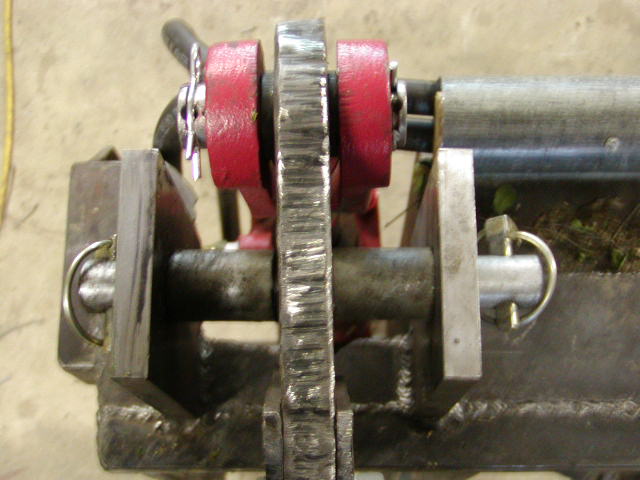

We built our grapple 10/12 years ago. We did not use any bushings. I think our pins were 1" and we welded a pipe coupling to each side of our 3/4" material & installed a grease zert into each coupling. I remember we had to drill the coupling out to 1" & it left a portion of the thread in, so I guess it was a 3/4 coupling. We haven't noticed any wear on this part, but the hydraulic cylinder is wearing, where we did not have any zerts. Will have to replace the ends of the cylinders before too long. This will be the red part of attached picture.
