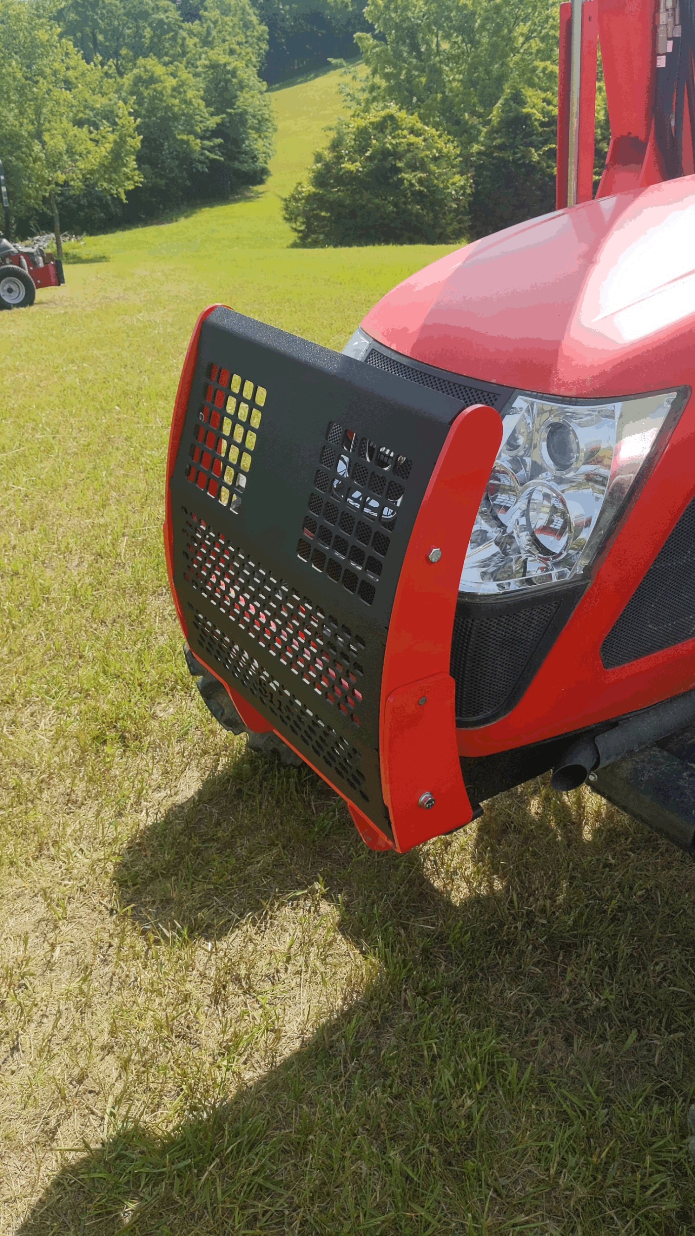

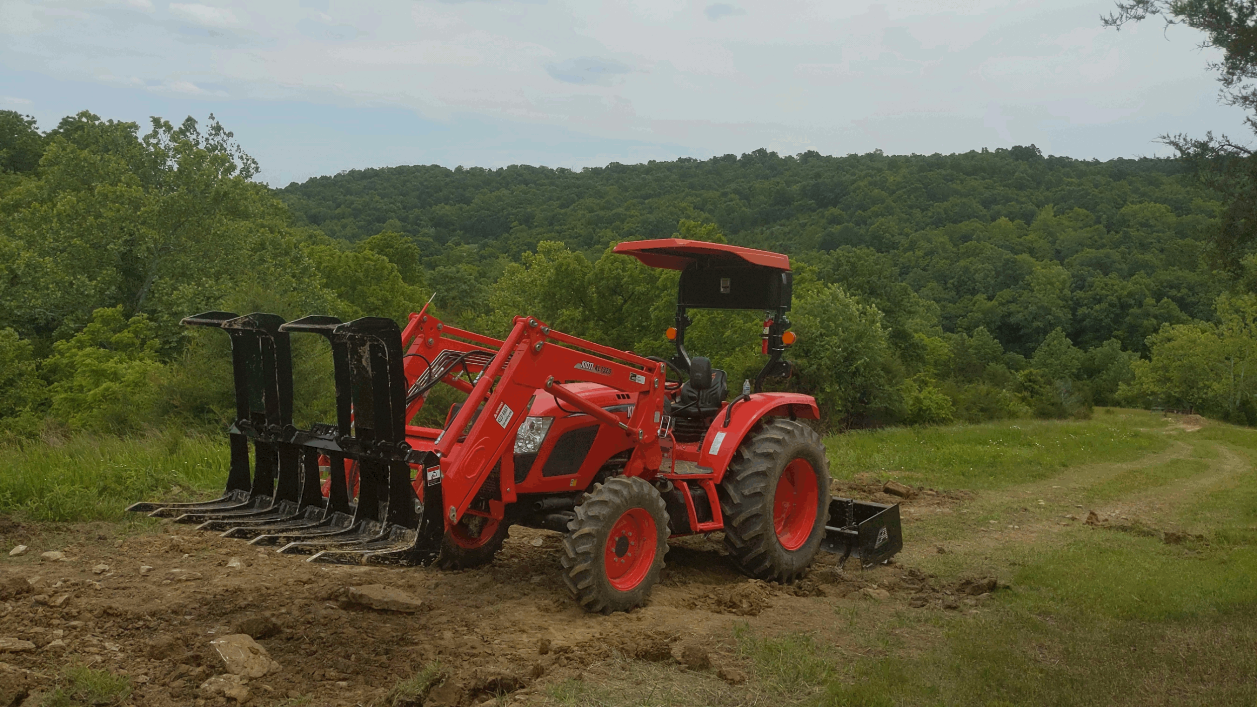

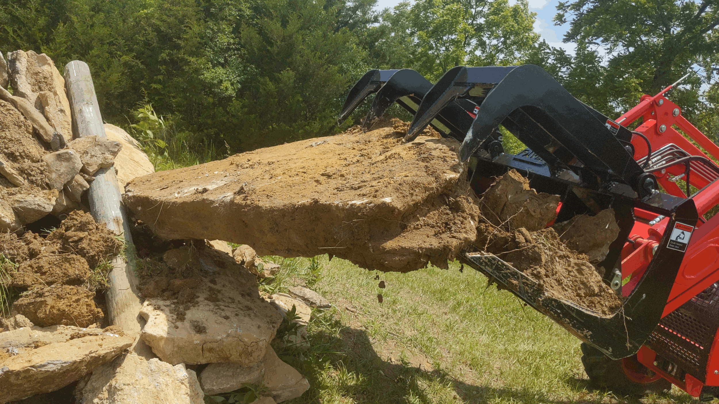

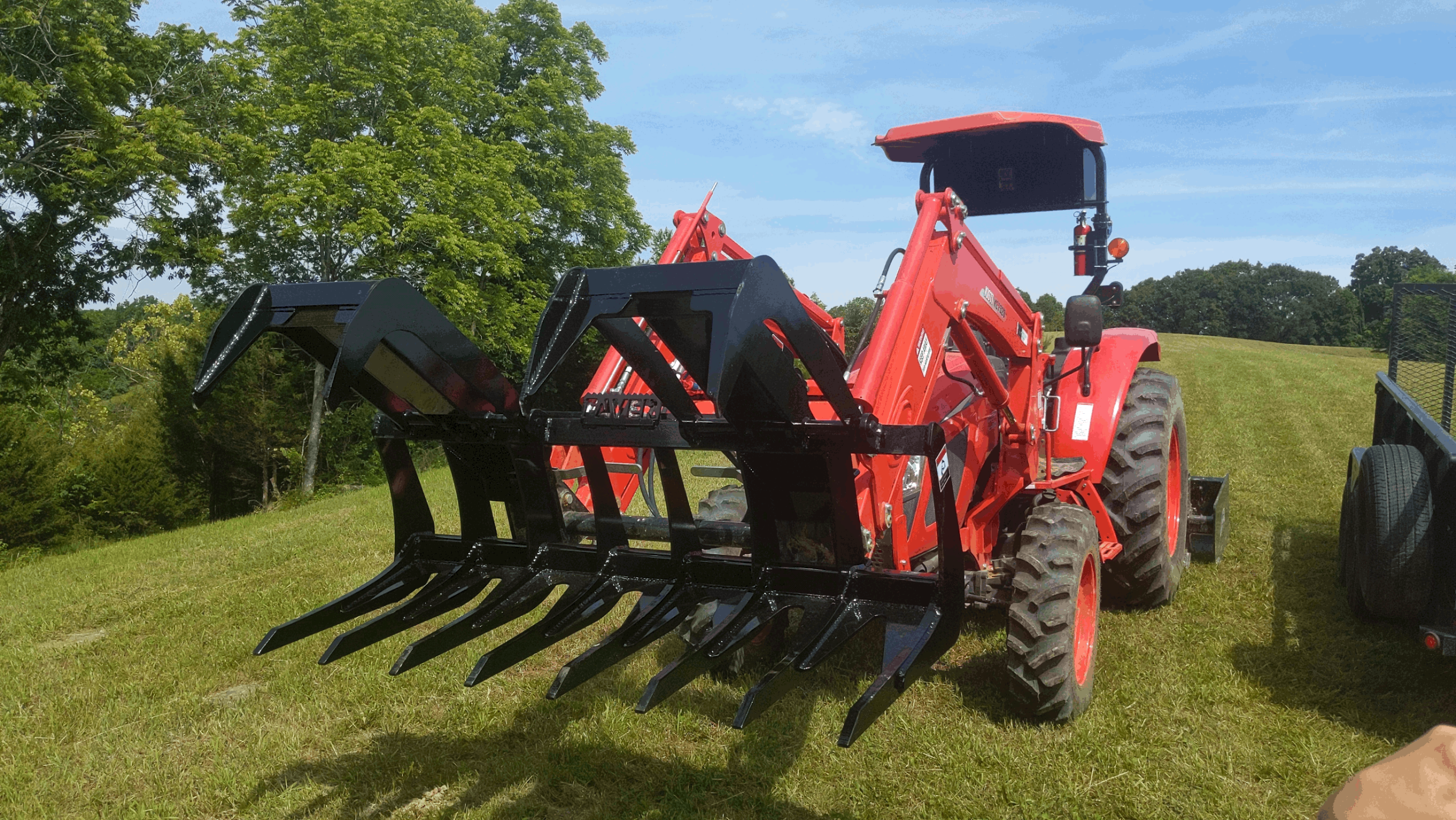

After much research and saving, I finally got into the grapple game. I never doubted anyone who told about them being a game changer, but I never thought it would be so great. I love this thing. I got a Faver SCX-728.
I also took the advice to buy a grill guard. Before I evening installed the grapple, the grill guard saved my grill from a stump that rotated in the bucket and smashed mud into the brand new grill guard. 😀😉 Thank you Lord!
I got mine from Five Eleven Designs off of Ebay. It is very stout and well finished. Here are a few pictures:
   / Grapple choices #9
I have the Land Pride SGC0660 and I have been very pleased with it. Works good to pick up pine needles that I have raked up.
   / Grapple choices #10
David - you have some really fine looking grassy meadows. Glad to hear that the modified grill guard did it's job. Some folks just have to learn the hard way.
