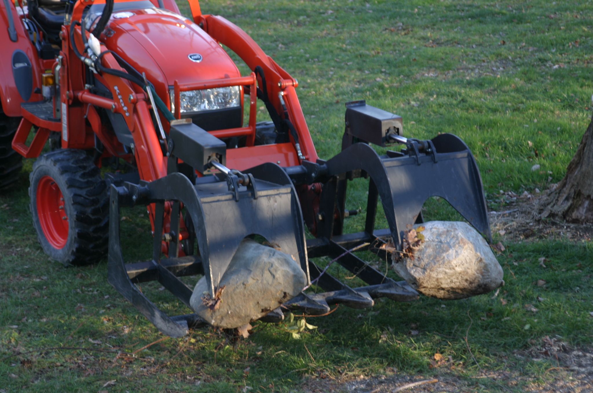

They clamp uneven loads. I won't say better, because I don't want to start anything.. :D
This is not a light duty, it's actually a little too heavy. I just took the pic because I knew I could never do it twice.

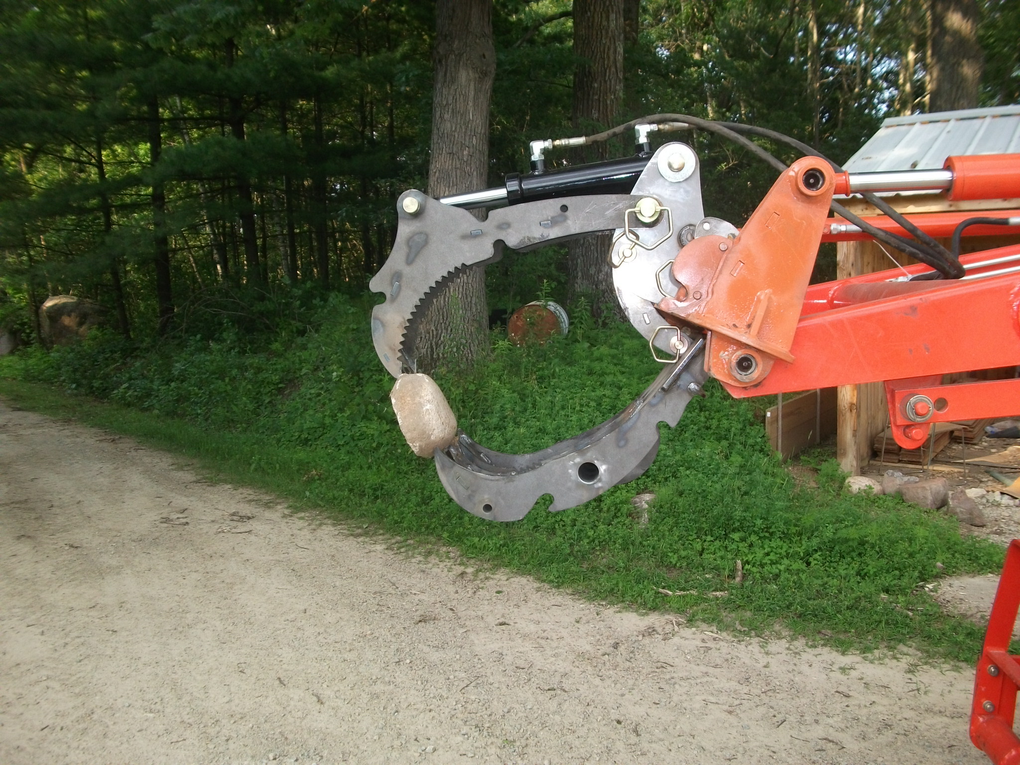

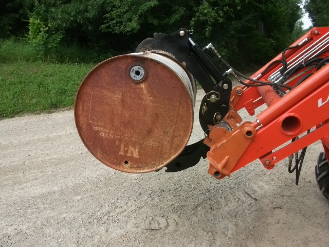

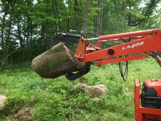

My preference is narrow. One vs. two cylinders has more to do with width. Get the one that fits your needs, there are countless variations out there. Weight has an effect as well, a #600 grapple can lift less than a #400 grapple on the same tractor. This is what I built, it weighs #100 and I have lifted 800-900 lb. rocks with it. I'm more then happy.
That is one beautiful grapple! I hope to be able to fab stuff like that one day.. my MIG unit is on the way.. :thumbsup:

/ Grapple cylinders #11
yeah, width ways. Here some pics.
Nice job of design and fabrication!
