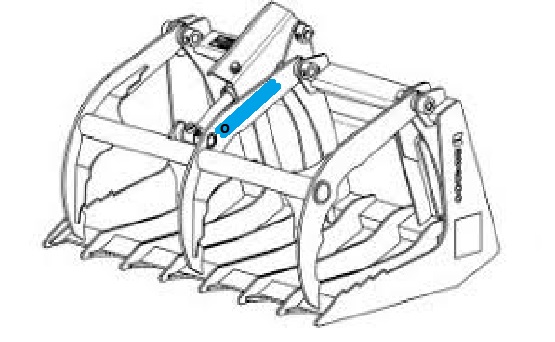

What I recommend is a small L bottom and make a removable bracket that would slip up onto the lid to pickup and clamp a single log for cutting.
Thats actually a good idea. Never thought of that adding a bracket to clamp a single log. The L bottom would be super easy to build. It would kind of give me the best of both worlds. Large enough to haul several logs at a time yet versatile enough to just clamp one log.
Gave it some more thought. For clamping one log, something in the center of the lid:
Pivot forward:

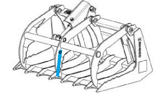

Or pivot up:
