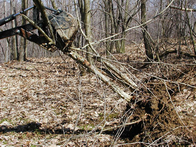

   / Grapple designs? #9
<font color="red"> This ones a keeper - not to find materials for a much stronger version. </font>
It turned out I had some square tubing kicking around that was just right for the next version. Tuesday I got it finished and gave it a pretty good workout. I started by ripping up out few little thornapples then grabbed a small white rock that wouldn't budge. So I dug around and worried it a bit and in 5 minutes I had that darned iceberg outa there. Impressed I was!

   / Grapple designs? #10
Then out with a few more thornapples, which I found came out easier if I grabbed on high up and wiggled and pulled and tugged.
