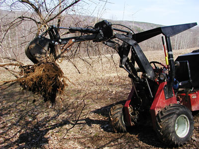

Then I ripped a few pesky honeysuckle. Gotta love that soft spring ground - sure is great for showing off!

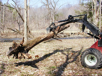

Having done in a hour and a half what would have taken two days with the bucket and a chain, I got in a little fishing.

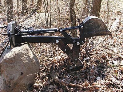

Yeah, sorry about the delay here, I've had, shall we say, an "eventful" past couple of days. More on that later.
Yes, this is the PowerTrac minihoe. Attached is a side view of the hoe with its bent boom and my thumb attached. The kink at the butt end of the boom doesn't show in this shot. I've roughly straightened it and am working on some temporary braces down from the top of the quick attach to the boom about where my thumb bolts on as a way to make it useable until I decide how to do a permanent fix. Next pic...
Sedgewood

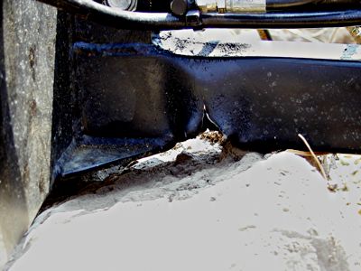

Here's a picture of the kink in the boom. That, sadly, is 3 inch square tubing with a 1/8 inch wall. It's clearly not up to the job and while the attachment to the quick attach held ok those little 3 inch gussets seem a bit on the small side. I kinked the tube while rocking back and forth and lifting that ol' 8 inch pople stump. My guess is the force generated by lifting while pushing was the culprit here. This thing just wasn't designed for such heavy duty. I want to upgrade it for just this kind of thing though - the productivity is awesome.
The guilty tree was an 8 inch by about 30 foot pople growing right against the corner of a house. In ten minutes I had pushed it over (Not to overstate it the pople is a weak tree with a compact root ball), grabbed the stump and wrestled it free of the ground, then dragged it butt first 500 feet and set it atop the burn pile (had the boom held I would have grabbed it in the middle and carried it like I had with the one that preceeded it).
