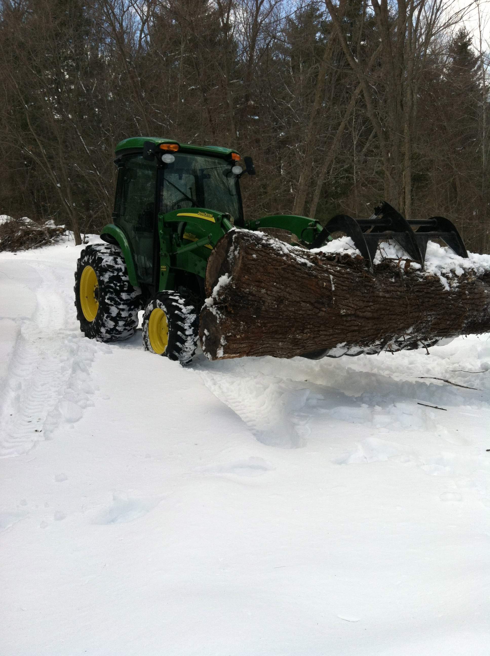

And the basis for your statement is??? Do you own one? Have you seen one?
My statements are based on the fact that I own one. that I'm using it on a bigger, heavier, more powerful tractor than it is probably intended for, and that I damaged mine through my own negligence. And by the way, I was probably abusing it in the worst possible way-using the grapple to pull on a large buried bolder. And by the way, the tube really did not fail-rather the weld on the back side of the tower cracked.
Last point, if you truly believe that all items, machines whatever, should perform the same, and have the same degree of durability regardless of price, I guess for sure you don't believe in the old adage..."you get what you pay for". I knew I was buying an "economy" grapple. I was more than satisfied with the value I got. Agsin, show me something else for the same money.
another shot of my junk Econo wildkat in action
Don't get excited. My basis is it failed and has failed many times before. This was broken header was posted two years ago. That's why I did not buy one. You like yours? That's great!!!!
