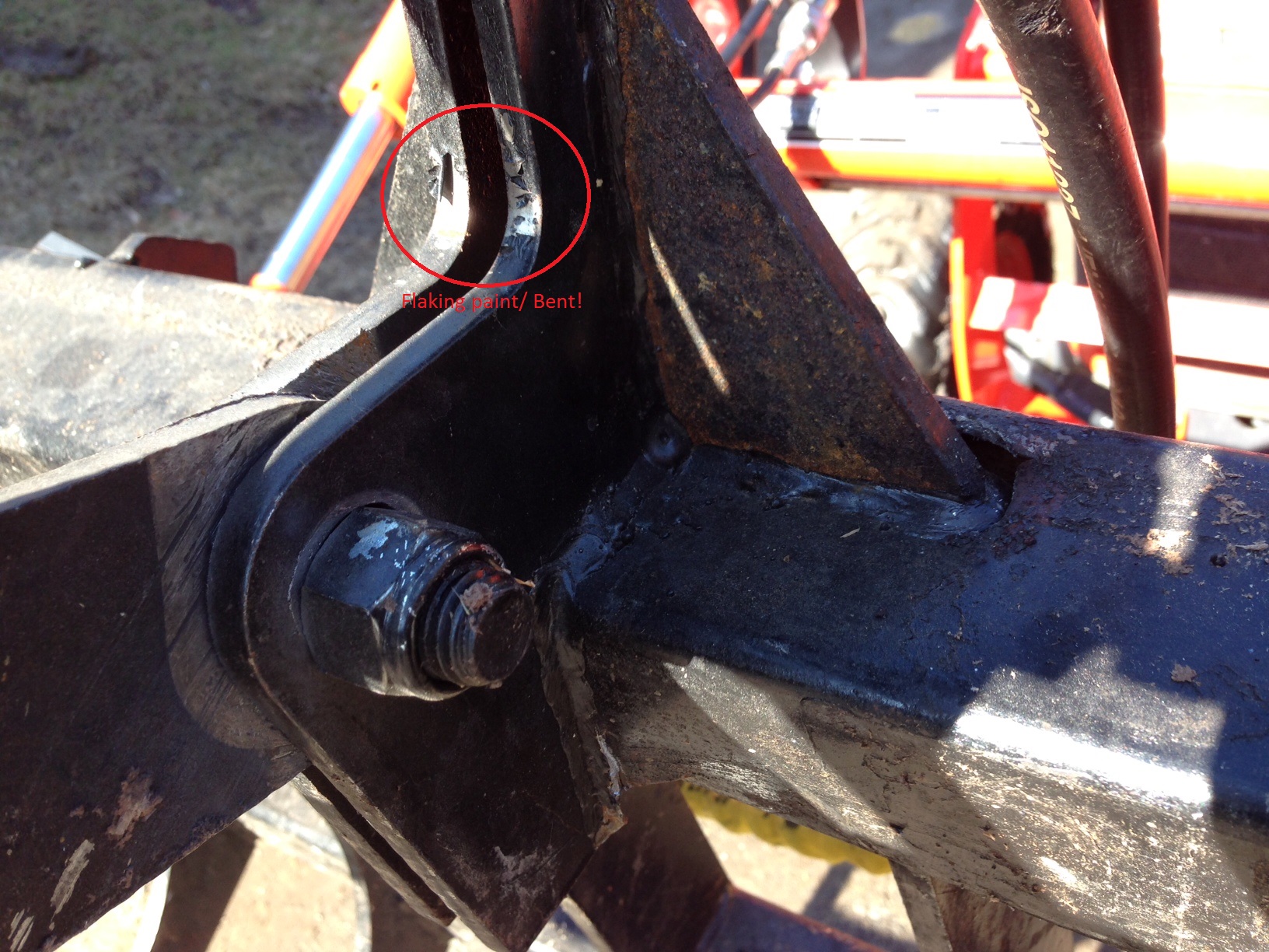

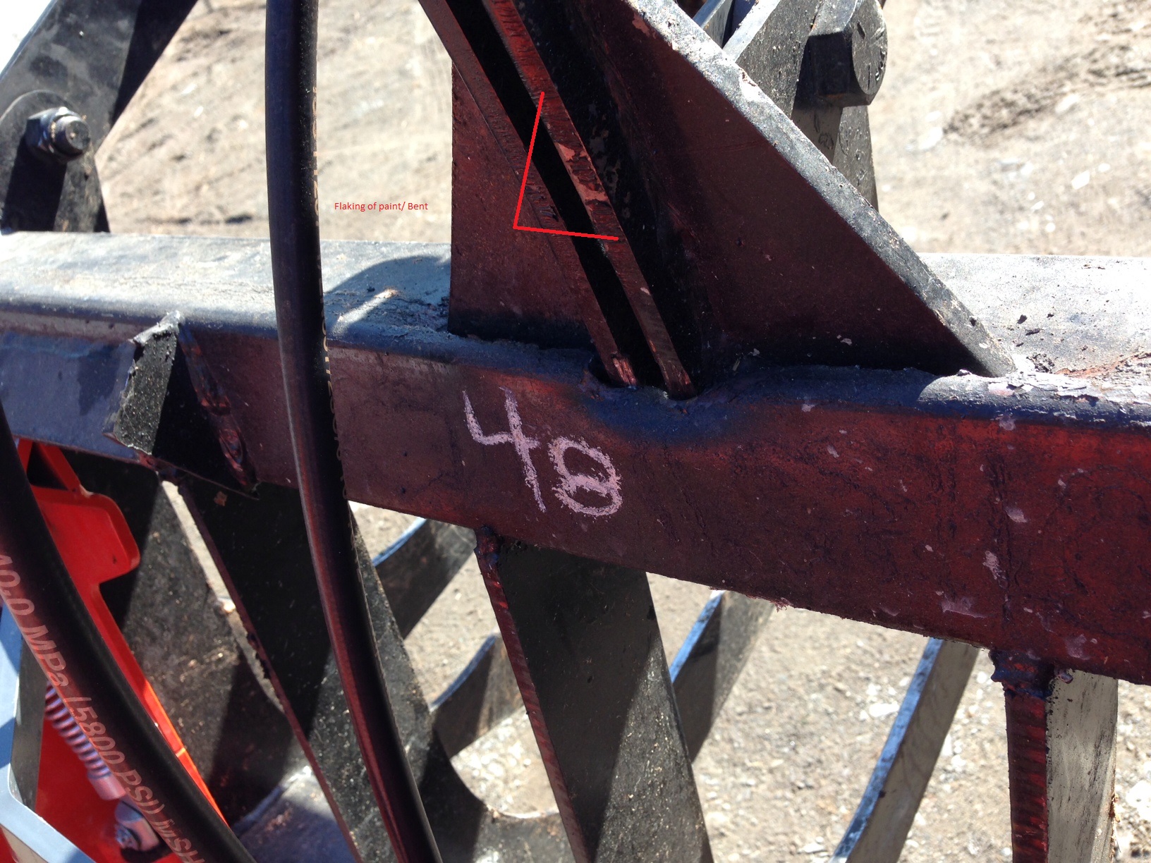

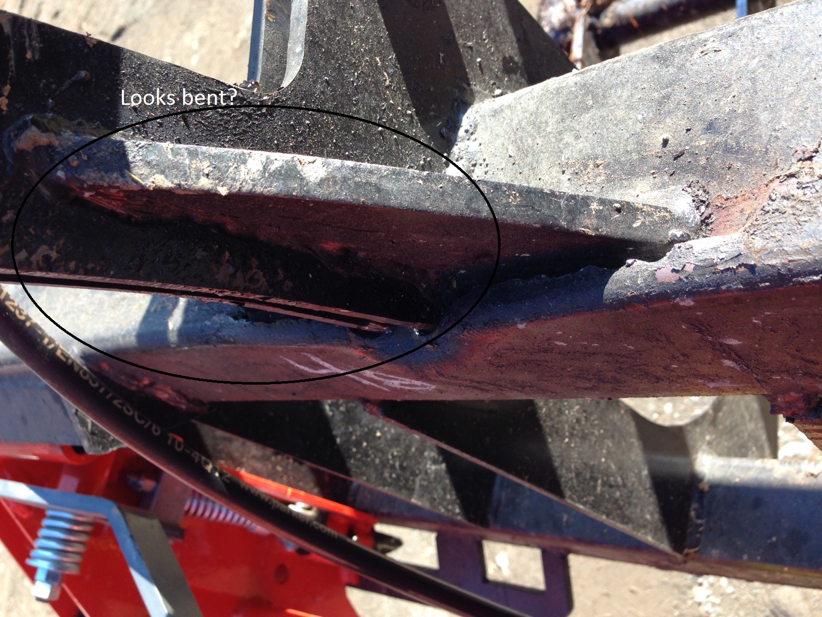

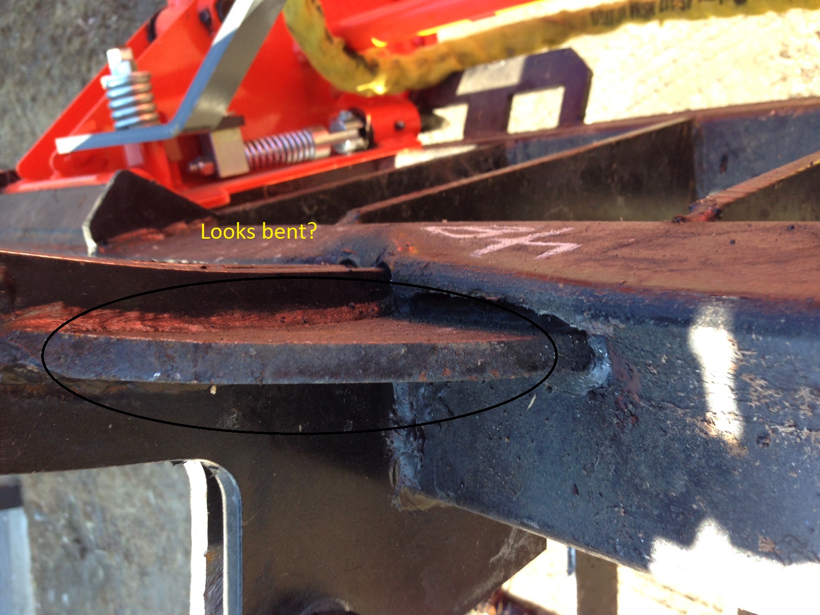

. I wouldn't say the weld itself failed but it tore the metal right at the edge of the weld. .
I would say that you correct.
The square beam wall thickness is way to light to start with. It should have been reinforced with at least 3/8" plate between the tower and the beam, would extend the
reinforcing at least 10" either side of the tower.
Would also have added a V shaped plate from the lower part of the tower to the beam.

Yes, I agree. There has been no pushing with the upper jaw. I'm almost 100% sure this damage is due to the force of the cylinder opening the jaw and bottoming out against the "tower" and crossbar before the cylinder stops engage. I'm curious what the company's reaction would be if they saw this thread.
bhh
Looking at the photos, I see exactly the oposite. Damage on Closing pushing the tower back, compressing (shearing) the cross bar in the HAZ (Heat effected zone, a common failure location)
Think about it, you describe the symptom as no longer being able to CLOSE the grapple. This suggests that the mechanism has been sprung OPEN as in closing on the load.
Not that it makes a difference on the failure, but you should know what forces you are dealing with.
(Plus, a cylinder has much less force in retraction than it does in extension due to piston area. This comment without quantification)

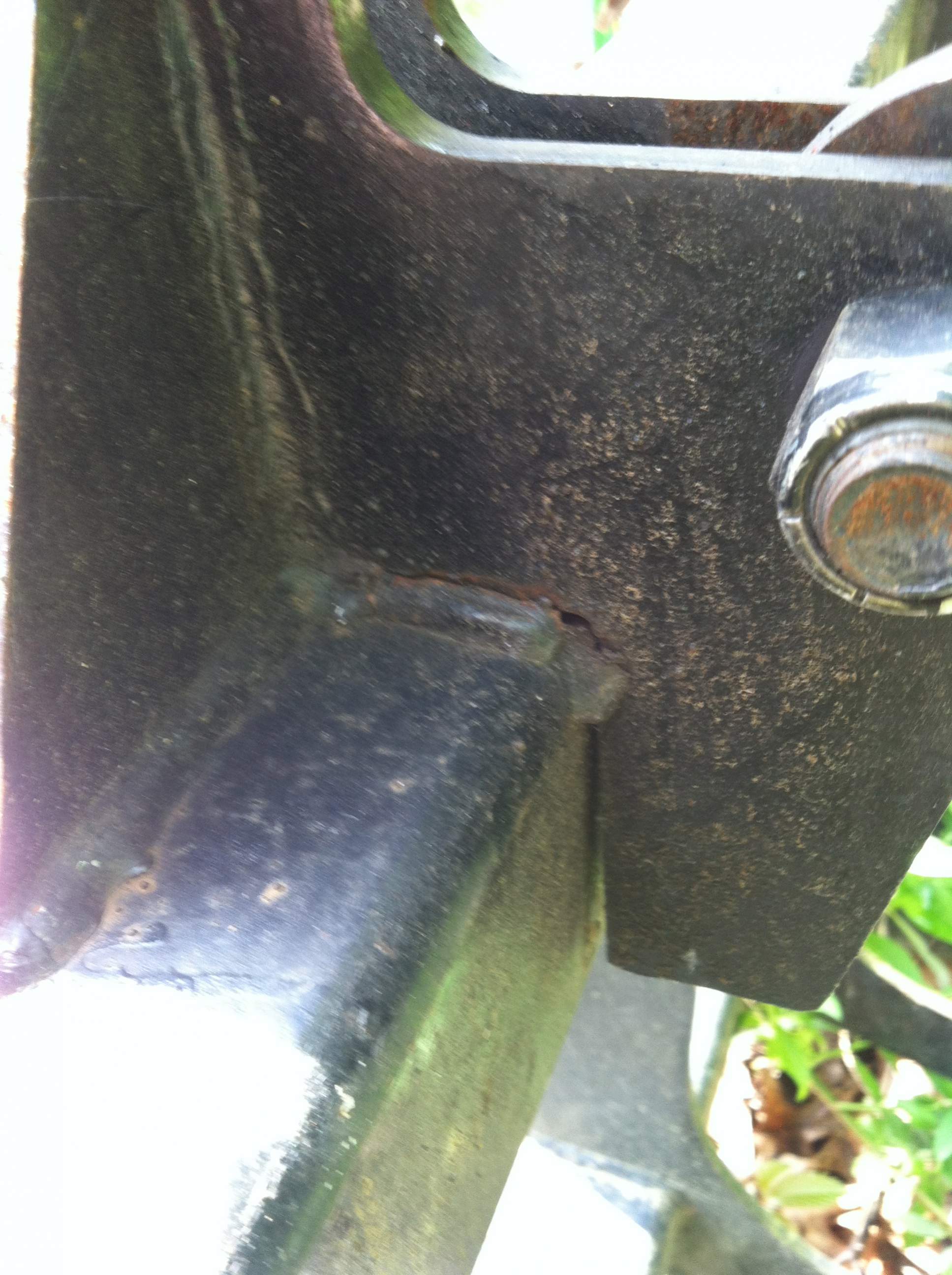

IMG_0775.jpgIMG_0776.jpgIMG_1361.jpgIMG_1362.jpgIMG_1363.jpgWow do i feel guilty- I'm one of the wildkat 48 boosters who has published many "endorsements" on this site. My point- **** of a value. I paid under 700 bucks delivered to Mass. And guess what? I broke mine too! Not wildkat's fault- my fault.
A lot of good comments here by CalG, Puckginder 85, and Island Tractor to name a few. I don't know how you damaged yours, but I suspect the hydraulic cylinder had nothing to do with it.
What I did was foolishly try to "hog out" a good sized boulder by rolling the grapple forward, opening the jaw, then lowering the upper grapple on the lip of the rock and backing up-and I'm talking about 60 HP (4720 cab), loaded R-4's, and about a 500lb weight block that is adorned with about 60' of 3/8 chain. Next thing I knew the grapple in the "closed position was about 10 or 12" from closure.
Remedy? I took the cylinder off and used a heavy chainfall to pull the grapple to the closed position. then I did a half assed repair by welding the back side and adding a couple of gussets to front. I will beef up the back side when I get a chance with some angle across the top,
Attached are pix showing the two breaks, and three shots of my quicky fix. Also a couple of pix "in action". IMO still a good value! Just have to use your head

The more I look at the pictures the more I see wrong. The tower itself is bent. That's some pretty substantial metal to bend, especially that direction. Something isn't quite what it seems to me. Either the ram is way too big for what its being used for or it has way too much leverage on that tower and literally bent what looks to me like 3/8? steel at least.

While chaining the jaws together then trying to raise the jaw to pull the tower back in place sounds like a good idea, remember you will not have the same tonnage in that direction due to the surface area lost by the space the ram occupies so it might not work. If it was mine to repair:
- Disconnect the cylinder
- Cut the cylinder mount/tower off.
- Cut out the deformed portion of the tubing & weld in another piece.
- Use 2 - 2' lengths of 3/8" angle iron to cradle/sandwich where the cylinder mount was cut off. You will have to notch where the flats are between the upper & lower horizontal tubes.
- Weld the cylinder mount back in place.
- Use 3/8" angle iron to go from the lower tube up to the cylinder mount on both sides with one edge of each facing the tractor.
- Weld a piece of 1/4" wall square tubing between the upper & lower horizontal tube in front of the angle iron you added & tie/weld it all together.
- Consider strengthening the tubing at the pivot points as well.
Point to remember:
- Assume the spacing for the mounts were appropriate for the cylinder when you first got it. ie: The grapple closed completely with the cylinder fully extended & the grapple would open fully with the cylinder fully retracted without the grapple hitting a stop.
- When you have a load in the jaws you have to use your judgement as to how much pressure to use while clamping the load. Odds are the cylinder is too large a diameter for the build. I have a 2.5" cylinder on my grapple & I have to make sure I don't over do the pressure. A lot of the grapples I see only have a 2" cylinder for this reason.
- To allow you a safety margin, consider exchanging the current cylinder with a smaller diameter one. (This will also make it move faster. - A plus!) Yes I understand it should have been designed to withstand the force of the cylinder they supplied with it & the repair will be much stronger than it was to start with. However it is easy to get distracted or if someone else is using it to apply too much force.
Wish you the best. Overall it doesn't look like a bad design, they just failed to have an adequate mount point. Redo it & it should last you a long time.

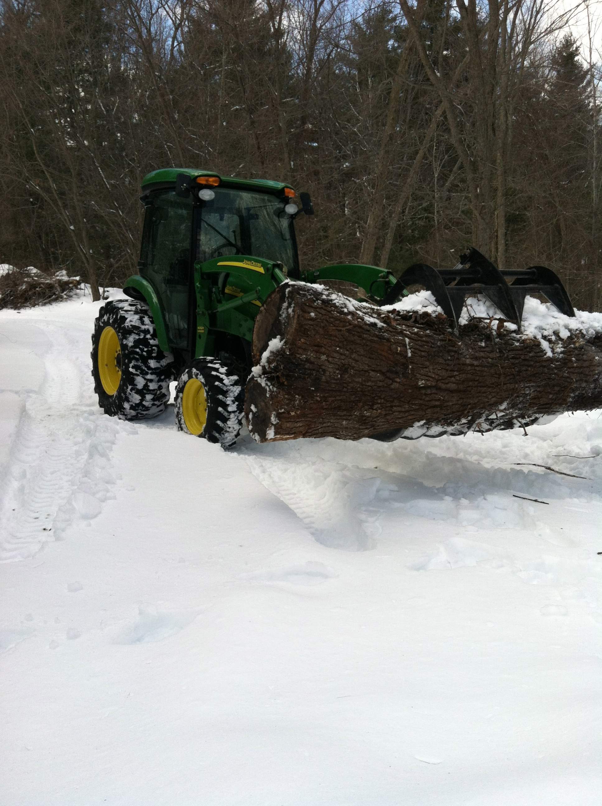

I have had an equivalent size and style 48" 300lb grapple now for about 7 years. I used it first on a CK20 with 1000lbs lift and for the past five years it has been mounted on a DK40 with 2700lbs lift. I've beat the crap out of the grapple clearing trees, boulders, stumps and roots. I have accidentally "pushed" with the upper jaw when trying to push a tree over. No damage to the grapple. I managed to bend the very tips of the upper jaw when clamping on a 2000lb chunk of granite I pulled out of the ground. (easy fix, heat and then gussets to better support the tips). The basic grapple is as true and stable as the day I took delivery. It is constructed of 3/8" mild steel tines and ?3x3x0.25 square tube and some heavy ?2" pipe between the tines for support. It is the same basic style as the Wildkat. Mine is a Millonzi (out of business, principle died) and cost $500. I have never heard of a WRLong OBG style (similar) breaking. I don't recall hearing of the Markham grapples breaking. I'm pretty sure all of those grapples of very similar design and weight are built with 1/4" top tube. The top tube is what is failing on these Wildkats so I have a hard time imagining that it isn't simply inappropriate 1/8" material that is the cause.

BHH, sorry to hear about your grapple failure. There is way to much hype on this forum of the economy grapples. This shows what happens when you actually use them. Like you said it is not much of saving once it breaks. I remember a few threads on here of people having the same problem with the Wild Kat grapple and they said the main tube is 1/8'' wall. If the main tube on your grapple is 1/8'' wall it is a design flaw. It shows how much R&D went into this grapple. If Wild Kat was supposed to call you back they did not I would call them again, I would not give up too easy. They need to at least know this is a problem with their product and correct it before they sell anymore. Someone earlier suggested chaining the lid shut and opening the lid to bend things back into place. This may bend things back close to new but since that main tube has already been bent once it won't take much to bend it again. I think the only way to fix it is to put a whole new main tube on it. While you are at it you may want to add a cylinder protector to the lid.
The more I look at the I the more I see wrong. The tower itself is bent. That's some pretty substantial metal to bend, especially that direction. Something isn't quite what it seems to me. Either the ram is way too big for what its being used for or it has way too much leverage on that tower and literally bent what looks to me like 3/8? steel at least.
View attachment 367830View attachment 367831View attachment 367832View attachment 367833
I think it has too much leverage and the main beam is too thin.
