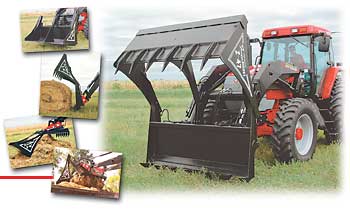

So, looking at projects for spring, summer and beyond,I think I need a grapple for the 400cx loader on the JD 4520. I have a 4in1 bucket, but it just does not do tree limbs well. Also I want to be able to lose some of the dirt I built up when making the debris piles last fall. Anyway, looked at a "BoDozer grapple" borgford.com and it looks well built. Perhaps too well built for the few times a year I need one. The wife unit sputtered and gave a general error code when I mentioned the price ($3600). I see units for skidsteers on ebay for $1000-2000. I can fab my own mounts. anybody know any brands/dealers which are better or worse than others? I thought about making the whole thing, but time to design and fab mounts is one thing, designing and fabricating the whole thing is something else.

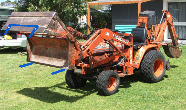

I know what you mean about the 4in1 not being good for picking up tree limbs, but $2000 is a big expense for something you say you will rarely use. Have you considered adding a couple of bolt-on teeth to the 4in1? I'm comtemplating something like this myself. The 4in1 opens wide enough but it sometimes has trouble keeping limbs in the jaws. A few teeth would make a big difference I think... and cost almost nothing. ... say 4 bolts and a few feet of steel.

Units are quick to install and don't require additional hydraulics. They fit right on the ends of your loader arms. BC-3000 Unit is around $825 (estimated price as I am mfg, local dealer may differ). I've seen these in action and operated them myself - a really slick solution for limbs. It'll take a several day job down to just hours. No chains, No bucket to get in the way or scoop half the topsoil into the burn pile. We currently fit about 80 non-westendorf loader models. You can submit a fit request on our web site at Front-End Loaders by Westendorf: loader for tractor, shade canopy, wagons, manure & landscaping equipment. -
