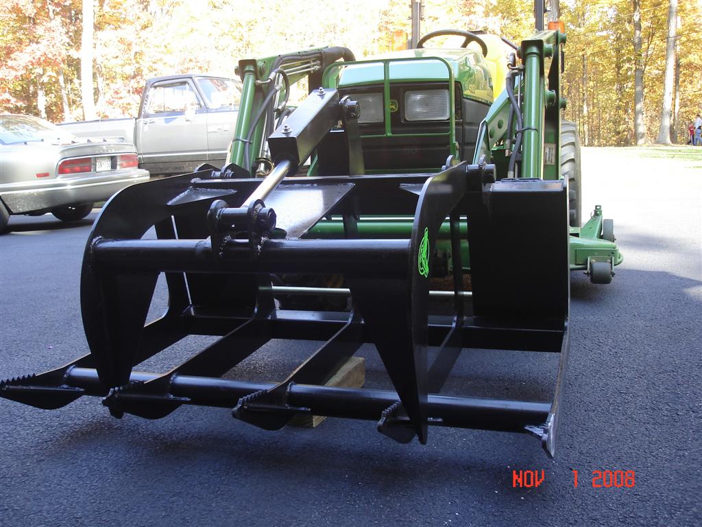

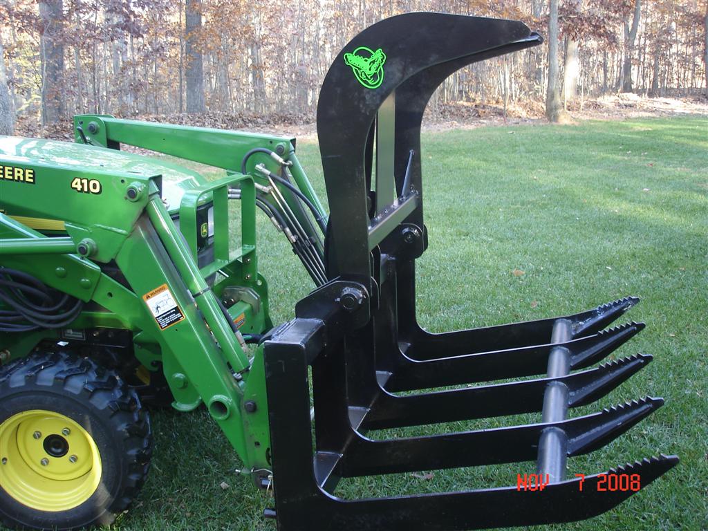

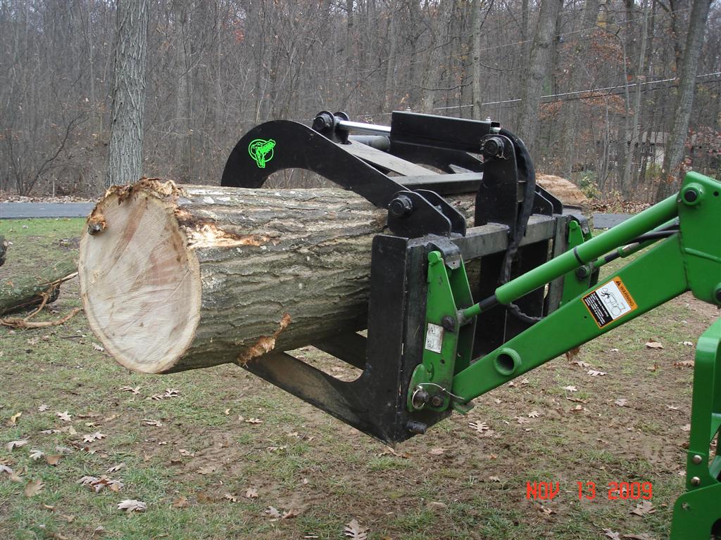

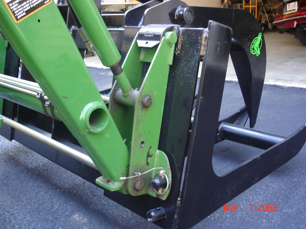

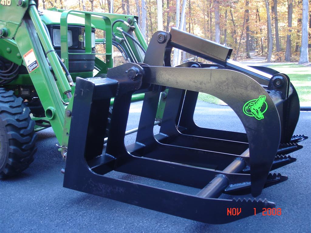

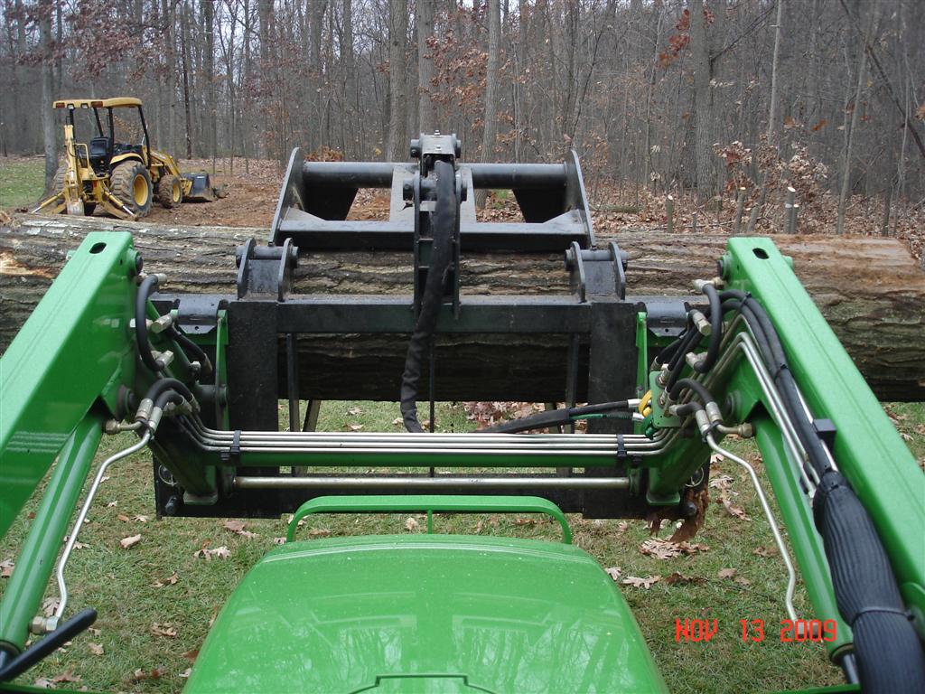

Your 419 loader already has the JDQA (John Deere Quick Attach), both WR Long and Gator Attachments make a light duty grapple that will replace your bucket. You will also need to add hydraulic's to your machine to control it.
Here is some pictures of mine on my 410 loader, it's the LD-48 from Gator (used to be Markham till they sold)
Do a search on these terms for HOURS of reading, then come back with specific questions.
