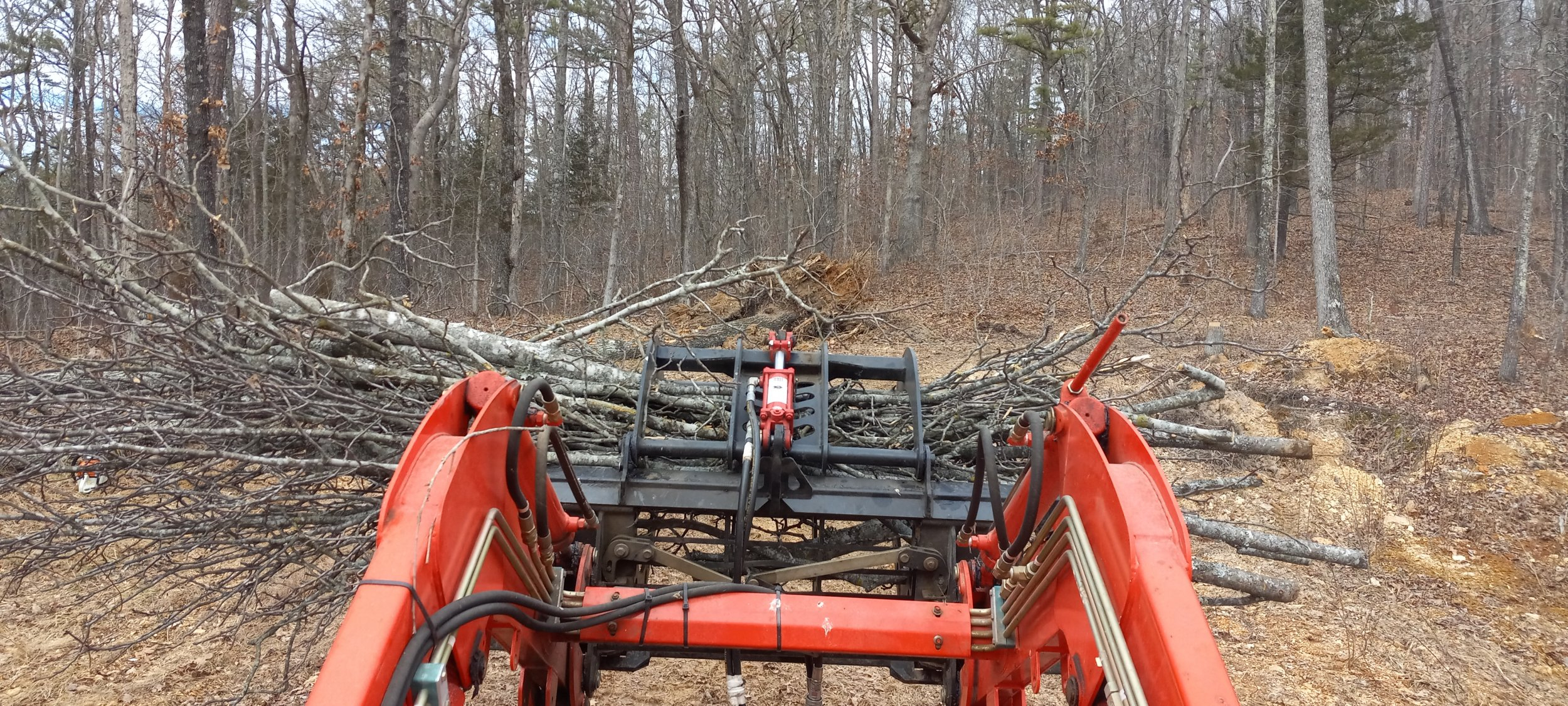

   / Grapple for Kioti DK40se (41hp)? #15
I just got a Titan/Iron Craft 60” for mine. So far it seems to be everything I need. I ran hoses to my rear remotes, so no 3rd function valve.
