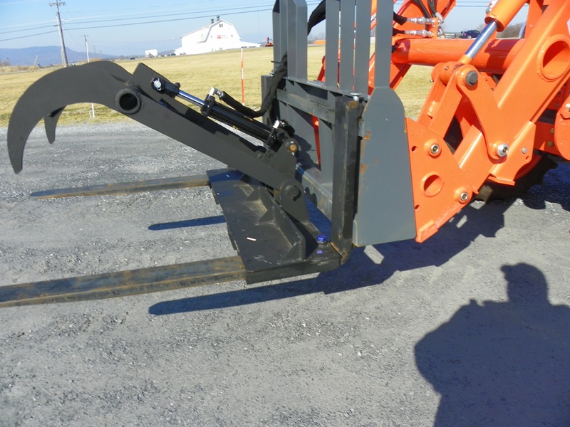

If you have Pallet Fork here is a grapple I got. It side on the forks. Fast to take on/off. Much cheaper.

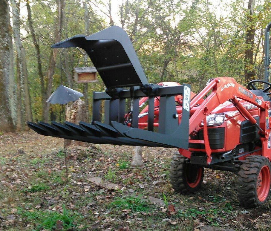

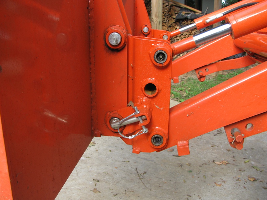

I've got the WR Long OBG2 48" single lid. I previously had installed the Kubota B1658 pin type QA adapter and the OBG2 that I got had the pin type mount. I use the grapple to plow through dirt to break it up, push through brush for clearing, and pick up and move logs out of the woods. It's about the same width as the front end of the tractor and can get into some pretty tight places. It only takes a couple of minutes to switch between the grapple and bucket with the QA. EA is a great place to deal with and you can save some money if you buy the grapple and valve kit together. You might even qualify for free shipping. If you want to get the Kubuta QA, you need to ask the salesperson at the dealer. The parts guys don't sell them.

Here's a pic.
