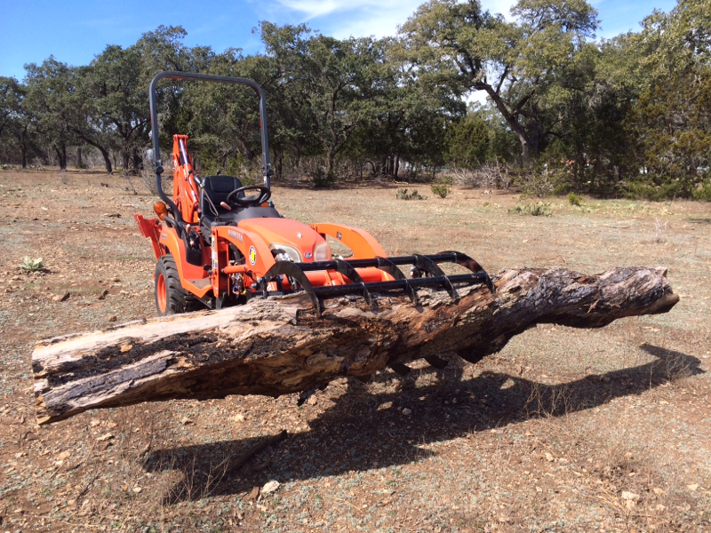

Congrats 4shorts. Here's a pic from way down south of me picking up a cedar log last week. These things are great. A neighbor cut down a lot of low hanging limbs and I was able to clean them up in very short order. I plan on using it too place a lot of rocks in a wall I've been planning.

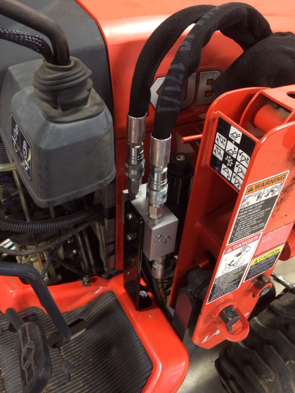

4shorts,
One of the changes I made when installing the grapple was to reverse the 3rd function valve as I felt it kept the floorboard area cleaner. I also modified the method LP used to mount the joystick knob by removing the locknuts and cutting the Allen set screws so they would be flush with the mount (chose blue Loctite to hold them). I'm also debating whether to shorten the joystick a little but need more time in the seat before that irrevocable decision is made.

Wow great photo. Nice looking set up. I bet it's sure handy. I really like the BX models. Thanks for sharing. :thumbsup:

4shorts,
You have the BX24 and your brake is on the right side so you did good doing it that way. My brake is on the left side so I have a little more room for the 3rd function valve. I also did a little bit of an unconventional install when it came to the hoses. I got a video up today on it. I did shorten the joystick shaft by 2". It feels better that way. I'll be making an aluminum cover for the valve as well to "clean up" that area.

4shorts
Super video on the install. That will help a lot of new LP grapple owners with their installations. I at least got all the parts except my bracket for the 3rd function valve reused the carriage bolt. I sure could have used your video as the LP instructions were less than stellar and not illustrated very well. One thing that really surprised me were the LEDs on the valve. Since I put mine in reversed I never even noticed them. Duh. I really like what you did with the long hose as I am less than enthused with the normal setup. I've had to tie the loop away from the rear tire and there is very little to securely connect to under that plastic fender. Reversing the hose bracket looks like something I will do as I think the extra hose down low will help although it has not been a problem. I did a direct pin installation as I have not yet committed to the Kubota QA. Now that I have the grapple I think I will get one as I see other attachments in my future. I also see a certain hydraulic thumb for my backhoe. Hmm... With the 3rd function valve already there one only needs a couple of hoses and buttons.

4shorts
Thanks Lowell. It's a long video and really only intended for someone who's about to purchase and install the Land Pride kit but I do hope it helps others out. Doing videos is a bit of a pain in the butt for me because I'm the type that likes to start the job and dig into it and the video thing sort of inturpts that but I hope it do help others out.
I looked at those instructions and they were vague at best plus I really wanted those hoses up under my skid plate so that's why I went that way. I'm happy with it and I'm comfortable there won't be any problems with it. The one thing I will be doing is fabricating a aluminum cover for the valve set up. One reason for doing it is for a cleaner looking install and the other reason is protection of the valve.
Ya that's right! You reversed the valve so you didn't see the LEDs light up. Hey that's no big deal, I won't see them either when I put the cover over the valve :laughing:
