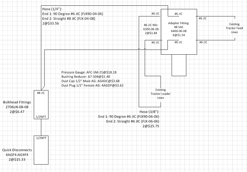

You need to sit down, and start drawing or make a spreadsheet or how ever it makes sense in your head. For example start at the remote, You will need an AG Male Quick Disconnect. It will likely have a NPT 1/2 inch female so you will need a 90 degree NPT male on one end and a JIC likely 6M on the other. So, your next hose would need a 6F on each end.. so far so good. So on the far end of the hose, you got to decide what does this hook to? Are you using bulkheads on some bracket at the location for the break in the loader.. are these bulkheads JIC 6m to 6M ? what are you using for QD's at this location? just start piecing it out piece by piece and write it down and draw it out. This will tell you what you need.
   / Grapple Hyd Hose Routing and Questions #12
i used Visio.
Also, used discounthydraulichose.com.
I wanted local too, but they were literally 2x as much..
DHH was easy to use and had a real nice, but simple, website.

i used Visio.
If it helps......
Visio can work:) Or just paper and pencil or paint or what ever makes sense for the user. The point is you need to "write it down" so you can plan the next step and if need be go back and forth as you check what is available at the price you want to pay vs what you are going to need to plumb it all together.

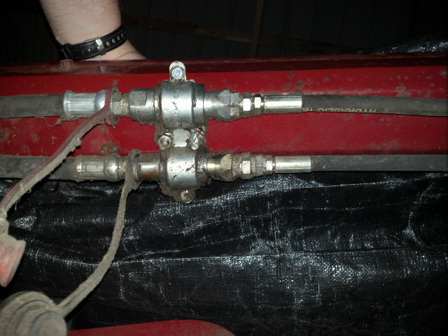

I'd love to see a picture of that all set up and complete.
No problem. Here it is (on a hay baler), I am not using the "tongue" that came with it and instead ran a pair of bolts through from the back of the metal its mounted on.
The 1/2" hoses from the tractor (would be 3/8" if I did it again) are on the left and the 1/4" hoses (to the cylinder) are on the right.
I like it better than a bulkhead fitting as I can disconnect the hoses by just pulling on them and connect them by pushing in on the hose (no need to fuss with a collar to connect or disconnect the hoses.
