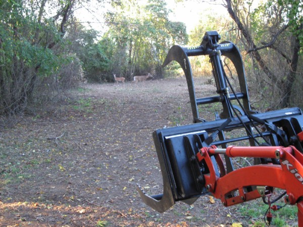

Thank you very much for posting the pictures. I do not always get to see the valve kits installed on every loader. The dealers install the bulk of the valve kits and they will just drill out a hole larger or make some modification to the bracket if it does not fit up exactly. Also they don't always let me know if there are any issues. We have well over 100 valve kits and the main differences are the mounting bracket, hose length, hose ends, and other items like the nuts and bolts. My goal is to make these kits as easy as possible to install and that all the holes align, hose ends are correct, and hose lengths are correct. You've helped me with your post. I'm going to make an adjustment to the hole pattern for this valve kit and with your picture I'll know exactly how to do it.
The generic bulk head plate is the 1/4 x 1/4 x 4. On some loaders I'm able to find a few bolts to mount a bulk head plate to, so I try to do that. The picture on our website is of a Kubota B26 with a TL500 loader and that one does have a few bolts to use.

Thanks, Nelson. I know I promised you pictures of my install when I was working on it and never got back to you. Sorry for that. I glad you found the pictures helpful. Maybe your next customer that's installing on a Mahindra 2615 with the ML106 loader will have an even easier time with the installation. All told, it wasn't very difficult, just a hassle to ream the holes out a bit to make it fit.
And, I think you have a typo in your message... shouldn't that be 1/4 x 4 x 4 (instead of 1/4 x 1/4 x 4) for the generic bulkhead plate?

No, it didn't. So I called Nelson and talked to him...and ordered a second WRLong grapple:D Of course, I had to have a dealer actually do the ordering, but Nelson talked me through (again) what I needed:p

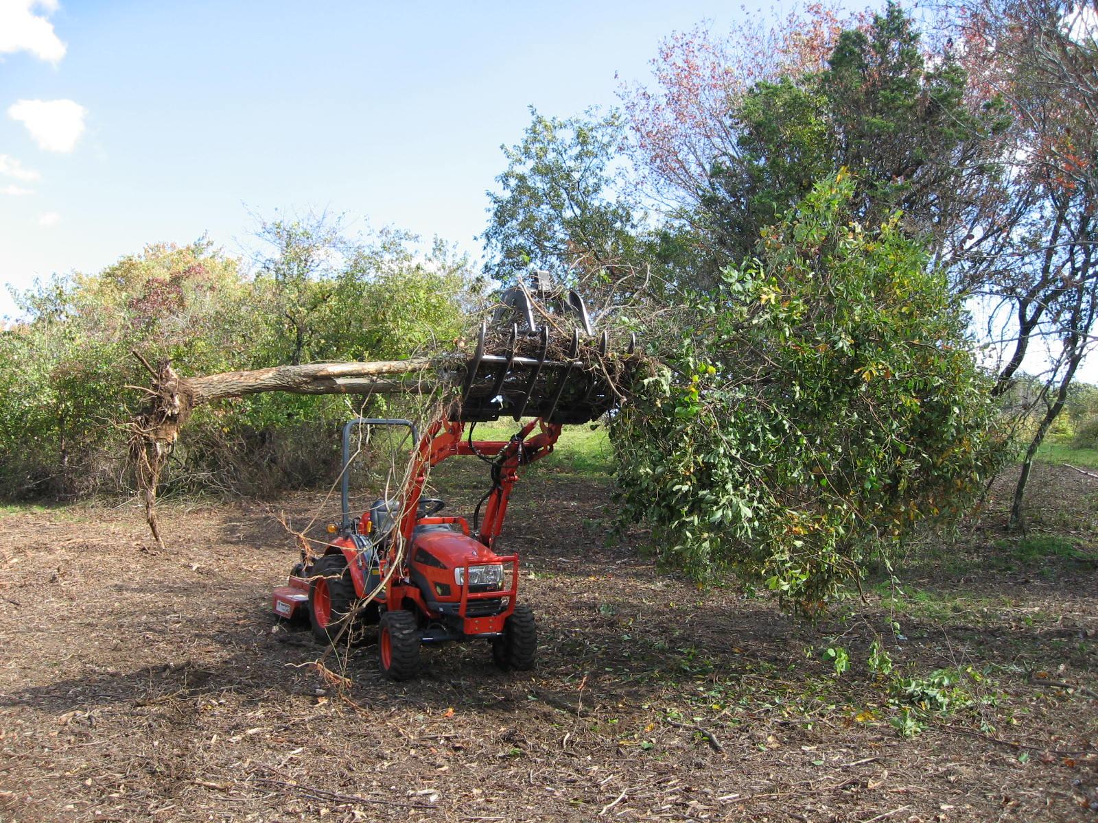

I decided on the add-on grapple single kit since i am mostly looking to pick up dead wood and tear out mountain laurels. My bucket already has a tooth bar. Talking to different dealers the WR long seemed to be the most reccomended. I also like how it bolts on to the sides of the bucket rather than welde on the top. -Keith
