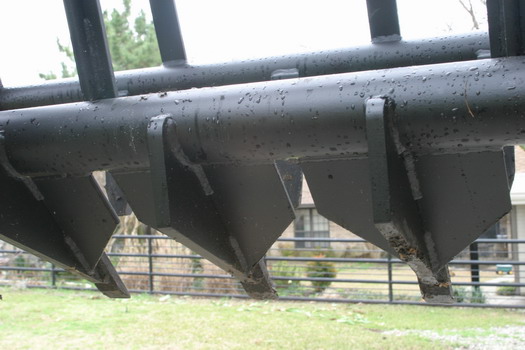

My advice on the width is to go with the same size as your factory bucket. My 542FEL came with a 72" bucket so I went with a 72" grapple. You could go a bit larger if you are just handling light stuff, but I want to dig roots with it.
There were a couple of things I was after in a grapple and this one was the closest to matching them. I wanted a heavy, strong bottom with hardened steel teeth with a large, but not too heavy clamping bit for large piles of brush. Here is a close up of the bottom section. The vertical supports are 3/4" thick steel. I've uprooted one tree with it so far and it showed no sign of bending.

My tractor came with a 84" bucket. I wanted to be able to comb small brush off of the ground and out of the grass. It just seems like 84" is pretty wide. Seems like one might get more than they bargained for. I don't know.
I think the width has plenty of advantages in the piles.
The teeth in that pic do look strong. They also look like they are designed close in to the loader lift pins which should make it real strong.
