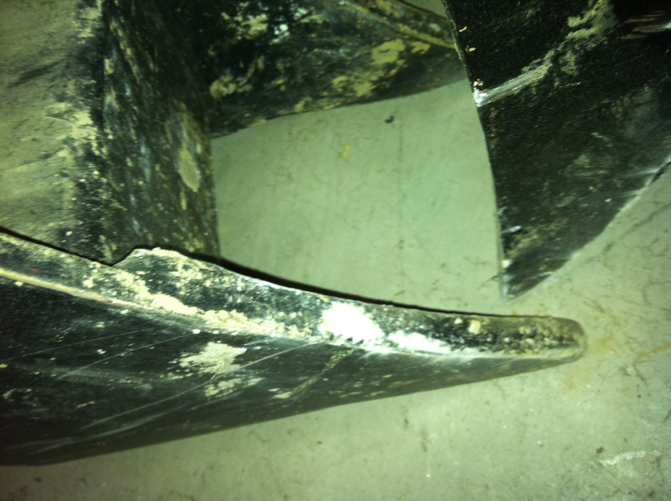

I'm going to do what brewdog did for the top jaw, on his ,he had some triangular web pieces cut and welded in. I can see that yes it would have been nice to have had it made out of 1/2" T-1 but I'd lost a lot in what I could lift. I still think that it just needs a few tweaks to it and it will be everything I need in a grapple.
First One,
I took a couple photos of my Grapple with the modifications tonight for you. I should of posted these sooner, but I had to go to the cold Barn and I've down with a nasty cold. I can pick up one inch twig with my grapple or a 1000+ pound boulder. The lower reinforcing plates are cut to go back to the main square tube cross member and fully welded all the way around. You can see I've been using mine all last fall and haven't had one bend at all. Hope this helps you out.

First One,
Was your grapple 3/8" or made out of 1/2" ? I'd like to think that I can get mine welded up so it won't bend thanks for the pic's I'm going to try and do something like that. Hope you kick tha cold soo, and thanks again.
   / grapple not what they said ! #54
First One,
Mine was made out of 3/8" steel. It's plenty beefy everywhere else except the tine tips, they see enormous stress from the weight of the logs, especially when you are pulling a log sideways with the tractor. Good luck and stay healthy.
