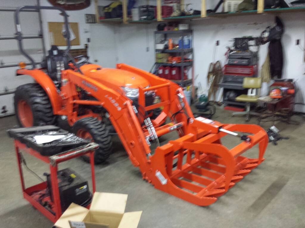

Looking at several and like the clam shell style. Many list as root rake but I'm not going to try and bend the FEL arms trying to do something like that. Skid Steer Attachment Depot has a 72 inch which looks like what I'm thinking about. just as a pic only of style. Do plan to call and ask some questions about their product
Skid Steer Tractor Loader Attachment - 72" Root Rake Clam Grapple - Ship $199 | eBay
Its a clam shell and is 600 pounds. Can get the extreme which weight is 900 or so pounds, but that also reduces the amount it can pick up.
The thing I'm looking for is the style. Want something to pick up brush, trees and some rocks, but no need for digging in the dirt, have other stuff to do that

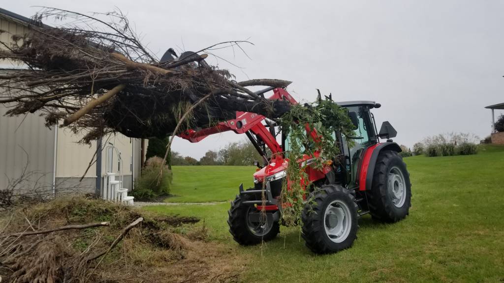

Ive use both styles and went with the opposite style with the longer tines when I bought one for my own. I like it because it cradles the brush pile etc rather than having to crush it to hold it. Just slide up under it and drop the lids down tilt back and go. With the clam shell type if it was brush that was starting to get rotten when you went to hold it tight it left a lot of debris behind.

I also have owned both styles and for brush, trees and rocks, I recommend the dual lid, L bottom style, this one is called a rock bucket:

I got the same one just smaller and single lid. I love it, they are built pretty stout and do a great job on brush clean up and log hauling. 20181010_210218.jpeg

I have the clam shell type. Didn't plan to dig with it, but find myself digging the tines into the ground quite often to grub up roots. Running the rake through dirt isn't going to cause more stress to the loader arms than shoving a bucket in. The L style types will carry more stuff around on their flat bottom, but I think each type are pretty comparable in ability to grab and transport piles of cut brush.

Small cut brush piles, maybe but raked up dead brush not with mine. Once the clamshell compresses the pile, stuff falls out the bottom:

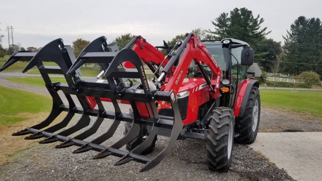

I built mine on a Bobcat LoPro bucket. Dual lid.
I greatly prefer a solid bottom. I very rarely use my FEL bucket.
/ Grapple Opinions Again #17

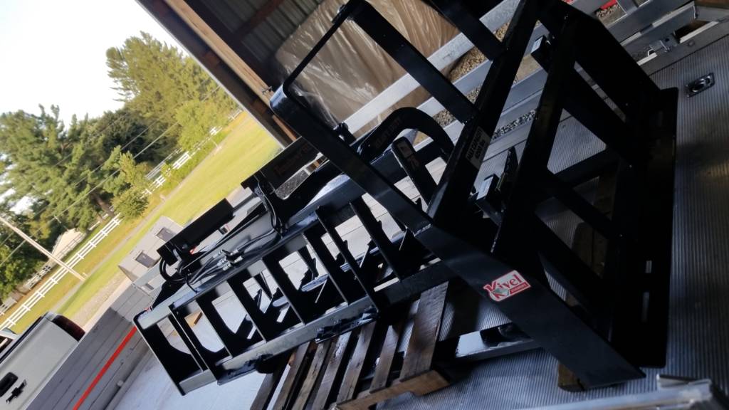

To the OP, you dont want that grapple with a 9540...way too light. It has 3/8" steel. You want something with 1/2" steel and dual lids. I have a 78" Tomahawk. Best bang for the buck. Greasable hinges, 1/2"steel, very well built. I paid $1250 in Pa.20181026_114133.jpeg20181026_112729.jpeg20180830_172918.jpeg
/ Grapple Opinions Again #18
Good point. Don't make the mistake of trying to save weight and end up with a Grapple that your tractor will overpower. A tremendous amount of force is exerted in Grapple use.
