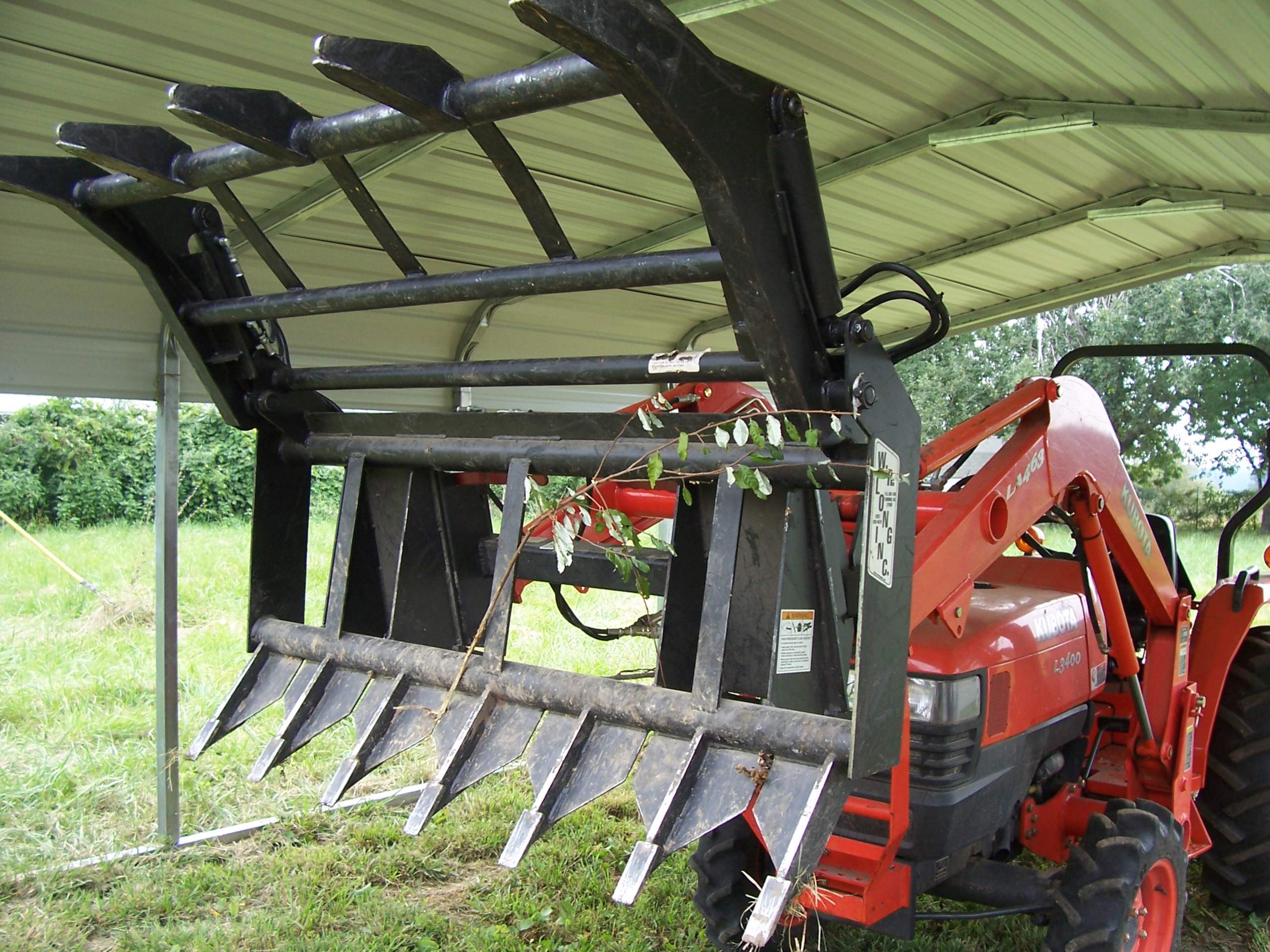

Thanks to the info from here and other sources,,,

Thanks a nice looking root rake brush grapple and valve kit.
Nelson
W. R. Long Inc.
   / Grapple Photos #14
Nelson
W. R. Long Inc.

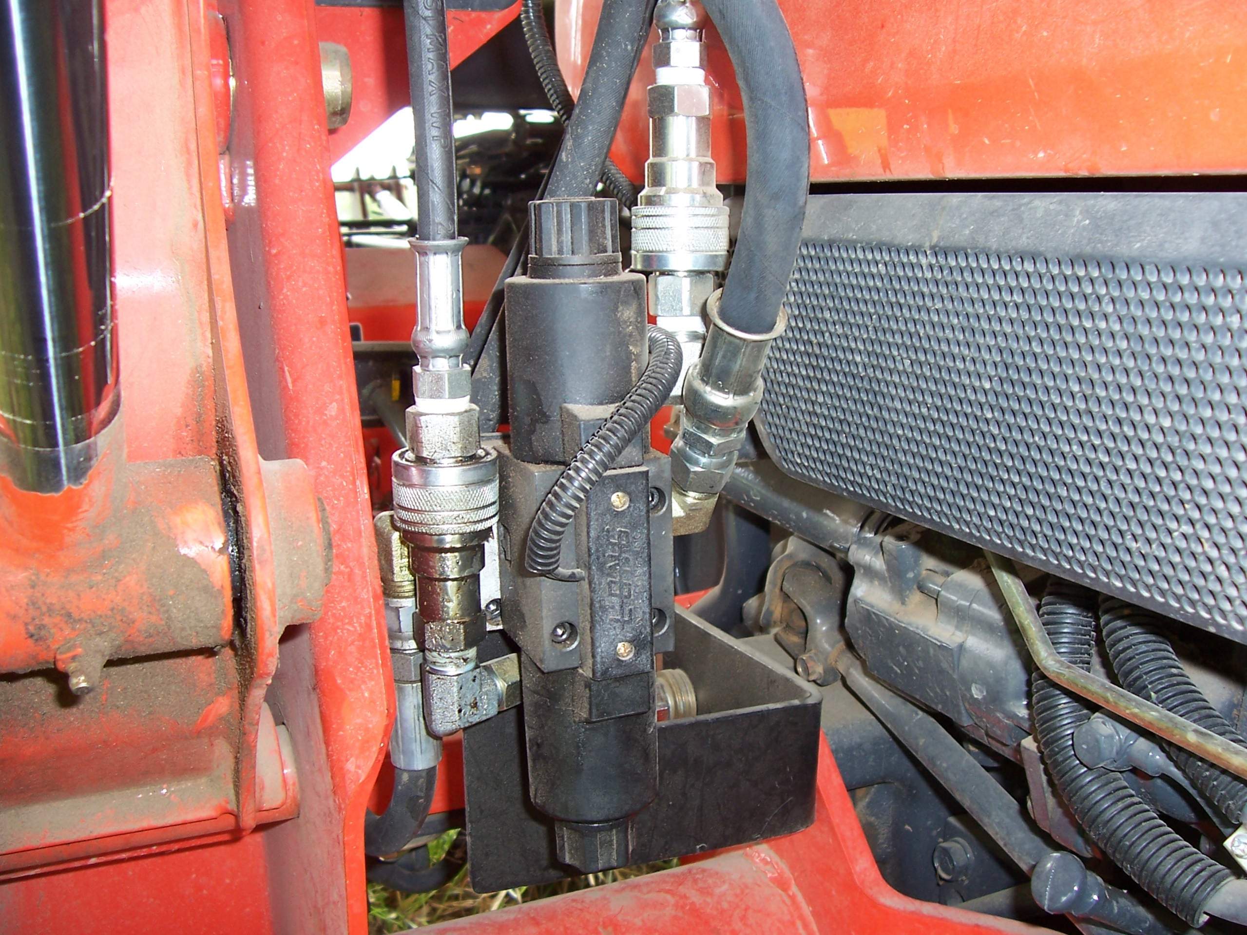

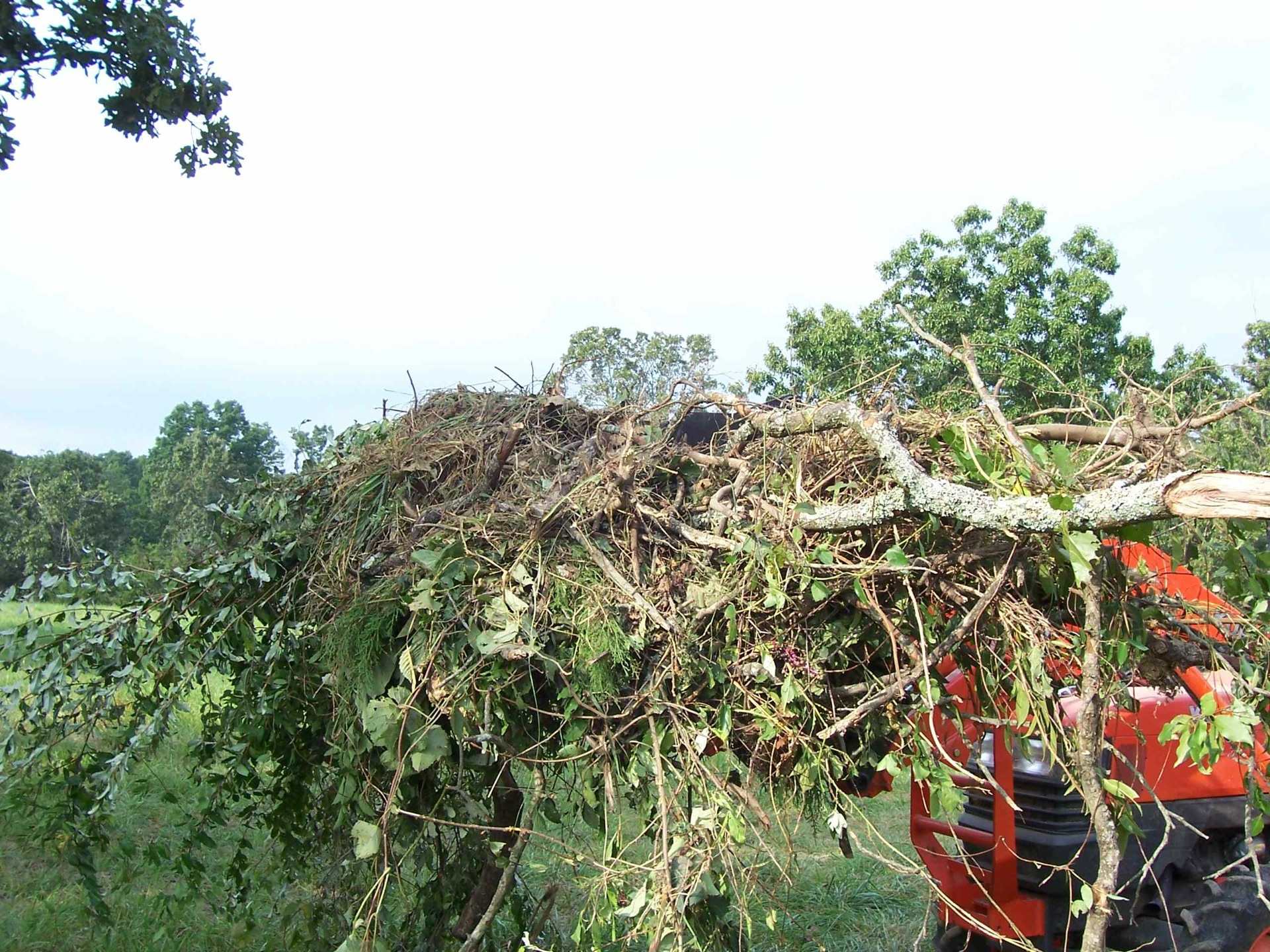

It works great. I could not have imagined how much faster clearing brush and saplings is with this over trying to use a bucket. It even pulls weeds. I almost opted for a bolt on bucket claw, I'm glad I spent the extra cash. My only complaint is the solenoid valve and connectors. They leak. I can hear the valve and see the drip from the connectors. A buddy told me, "All quick connects leak.". Not so. I will change the connectors to Parker, but wait on the valve. I just unload all pressure on the system when I park. I guess I should call W.R. Long, but I've been having too much fun working with this monster and I don't want to take it apart to send it back.

Thanks Nelson.
I received the new couplers but just got around to installing them today. I ran the cylinders to bottom in both directions and held pressure for a few seconds. The couplers are dry as a bone.
Do you want me to send the defective ones back?

   / Grapple Photos #19
Were the QC's you were using a matched set, from the same manufacturer?
   / Grapple Photos #20
Yes they were. I spoke to WR Long and they had received a bad batch from one of their suppliers. They shipped me a new set of QC's, everything is dry as a bone now.
