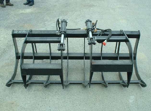

Anyone know anything about these. Lot cheaper than ANBO or Long, but no clue as to quality. (I'll cross post in attachments forum.)

it is a VersaTech brand grapple and it is 66" and weighs 500 lbs.
The guy's name is Dave and they buy them and resell out of a warehouse in upper NY state.
His number is (315) 247-3731.
I asked him about a 48" version, but we got cut off as his cell was not getting good reception.
If you look at the pic, the ends could virtually be cut off making the bucket approx. 52" wide. This would be better for us 425 users and would probably save a little weight too. Something in the 400 lb range would be good.

<font color="red">VersaTech brand grapple and it is 66" and weighs 500 lbs. </font>
It's the size and weight I'm looking for. It clearly wouldn't be as strong as the W.R. Long or Anbo, but maybe can take all our hydraulics apply.
Tempting. I'll have to consult Bubenberg.

True, but I would think that it would be plenty strong enough for a 425??

As I look at various root rakes, I've concluded that the first thing to do is make a PT to universal skid steer adapter, with a 20 or 30 degree tilt built in. I suspect it won't add too much more weight than welding and gusseting a PT plate to the rake itself. I'm leaning toward the Versa-Tech, which is light, but haven't yet ruled out W.R. Long or Anbo. As usual, the search process is probably the most fun I'll have with the implement. /forums/images/graemlins/tongue.gif
