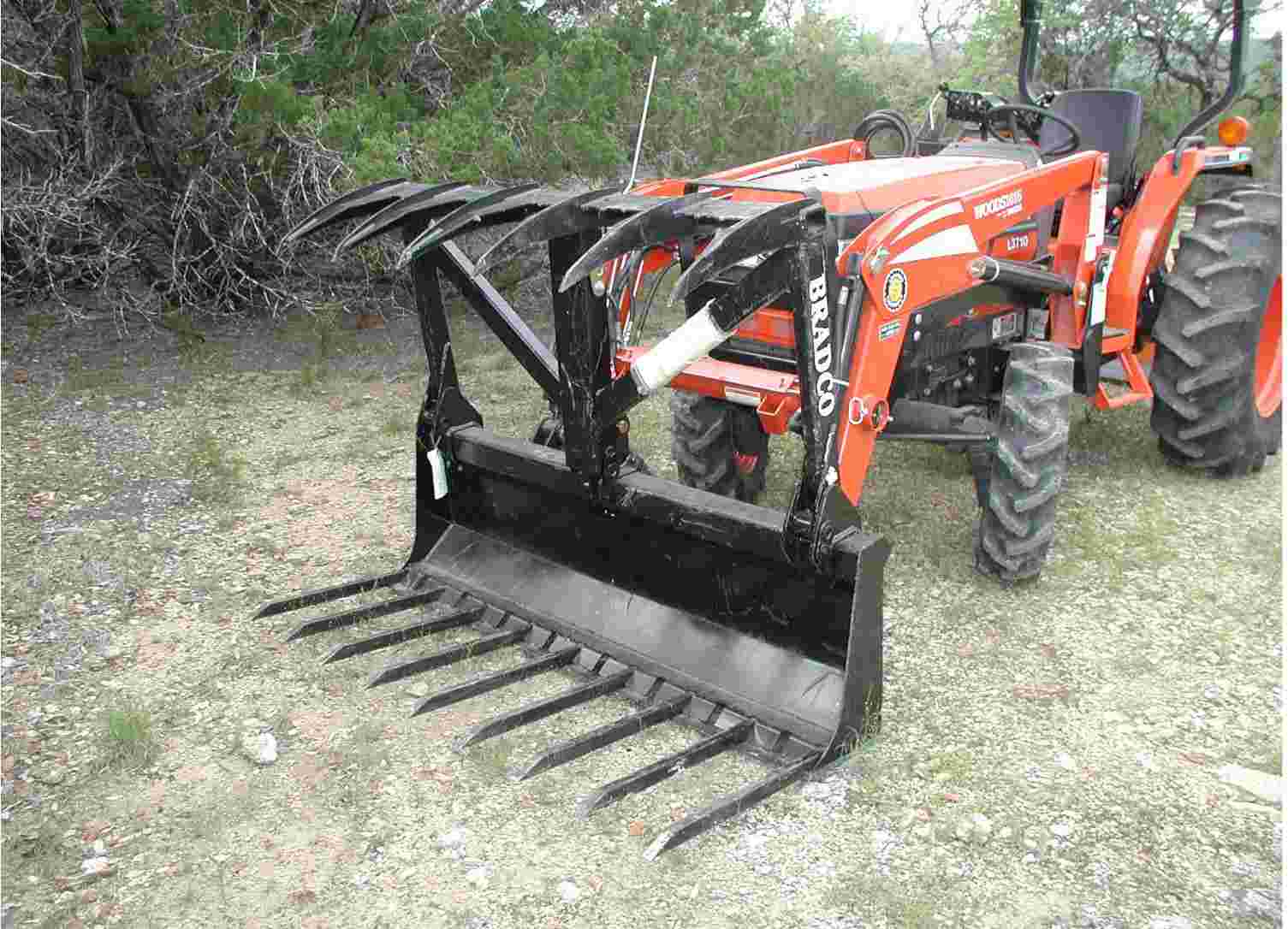

Attached is a picture of my grapple. I have found it invaluable. I constantly use it to move large rocks, and brush piles. It has the quick attach system like skid steers. I can change to the normal bucket in about 3 minutes. My grapple is a Bradco, and my FEL is a Woods 1016. I think the attachement is pretty big, sorry for the inconvenience.

Brent, thanks for the image. what is the weight of the grapple rake? And if you don't mind me asking what was the price?
Have you used it to pick up any logs? This would be one of the things I would be using it for most for.

The grapple is pretty heavy, but the Woods FEL lifts more the the stock FEL. I normally use it to grab a pile of cedar. I also use it to move large rocks. The weight is 740lbs. That gives me around 800 lbs of lift with my Woods 1016 FEL. I have no problem lifting the back wheel off the ground on my L3710, and it has a 400 lbs box blade. It's really useful for me since my 40 acres is covered with cedars and rocks. Now the painful part. I think it was around $1800. But for me, it has more than paid for itself, because with my wife and three small kids, I don't have any helping hands to rig loads to my FEL. So, I just scoop under and clamp, or tilt it all the forward and "pick" up the load. I only take it off when I'm doing dirt work. Don't forget that you'll need a circuit of hydro up to the front. My dealer did that by installing a 3 way power beyond valve past the FEL controls. So, I also added top-n-tilt for my blade since it was there. So, I spent a little more than I planned up front. And I am very glad I did. Sorry for the long windedness
