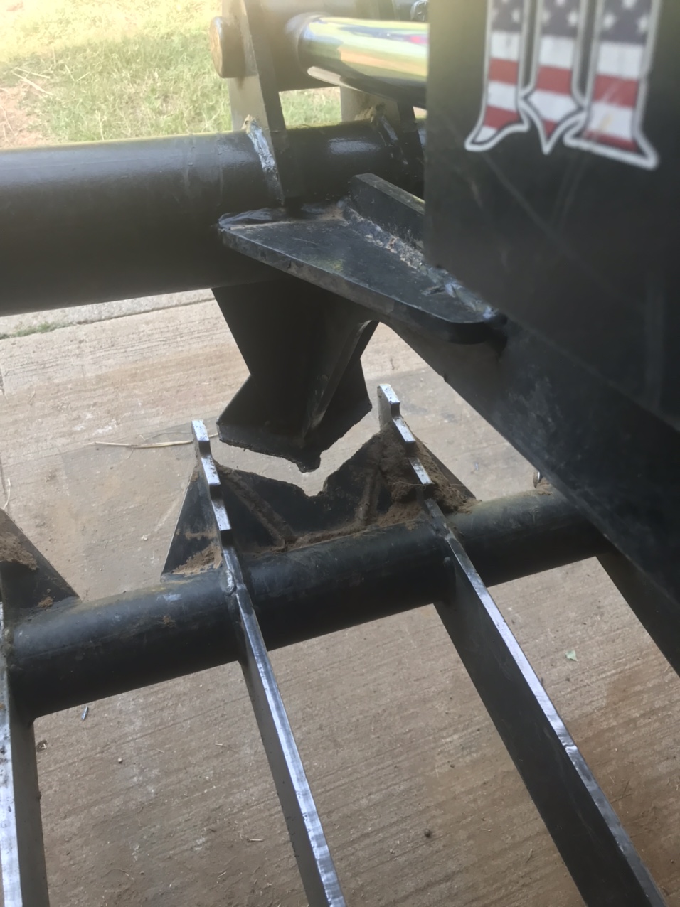

Thanks for the help with pictures, I’ll get a better one to show the modification[/
I have worked the mtl 48 as hard as my mahindra 1626 will work and it’s performing flawlessly. I did add some plate to allow to grip saplings and vines. IMG_2960.JPG
When fully closed it allows me to grip even the smallest of things. So far I’ve dug out and hauled rocks I estimate around 1000 lbs , cleared brushy areas, and hauled/burned mountains of brush.

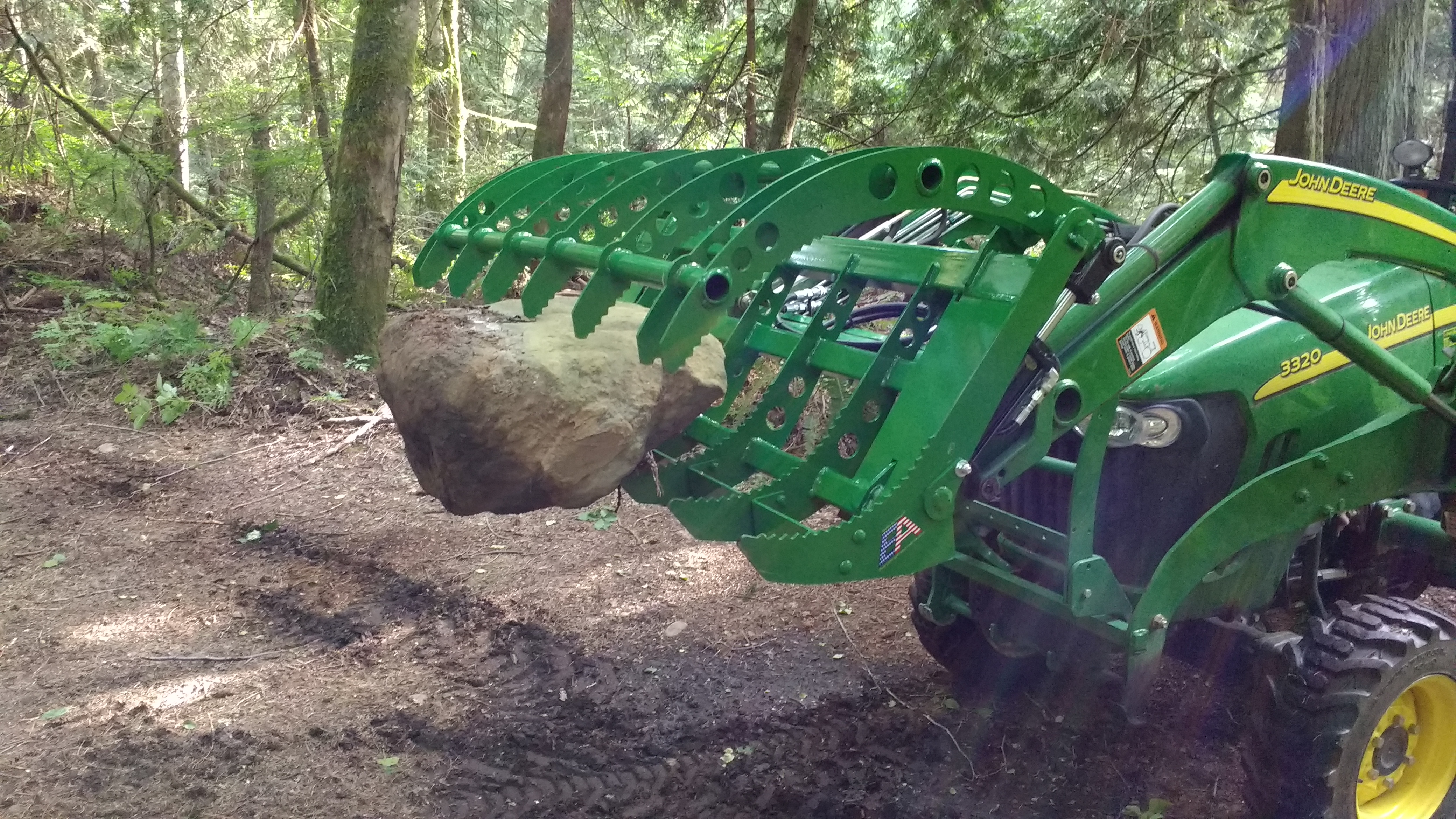

Another vote for the EA55, strong and light, well worth the wait if you don't need it right away.

Precision manufacturing now also makes a grapple called the mini 322. That and the wicked 55" are the only 2 that weight 250lbs or so...the rest are 400lbs and up that I've seen.
