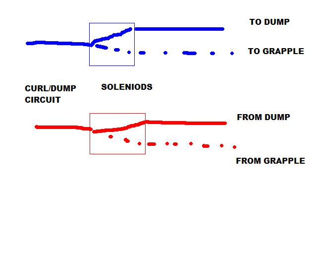

Leaning strong toward the Bradco grapple. Can anyone tell me what a Fozze (sp) valve does? Dealer is suggesting hooking up with one of these which will allow for a thumb switch strapped to the loader valve. I just flip the switch and that is supposed to divert the hyd to the grapple. Would not be able to curl and open and shut at same time, but could open and shut grapple and lift at same time. Any suggestions?

Do a search here on diverter valve - you should find plenty of info.
basically it is an electric soleniod installed on your curl/dump circuit. When activated it diverts the oil flow to the grapple cylinder. See attached
We plumbed lines from a rear remote. The diverter valve is probably easier to use. with our setup you need three hands - one to work the FEL joystick, one to work the rear remote control and one to steer. The diverter takes advantage of our opposable thumbs /forums/images/graemlins/laugh.gif
