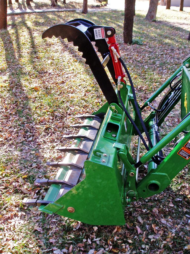

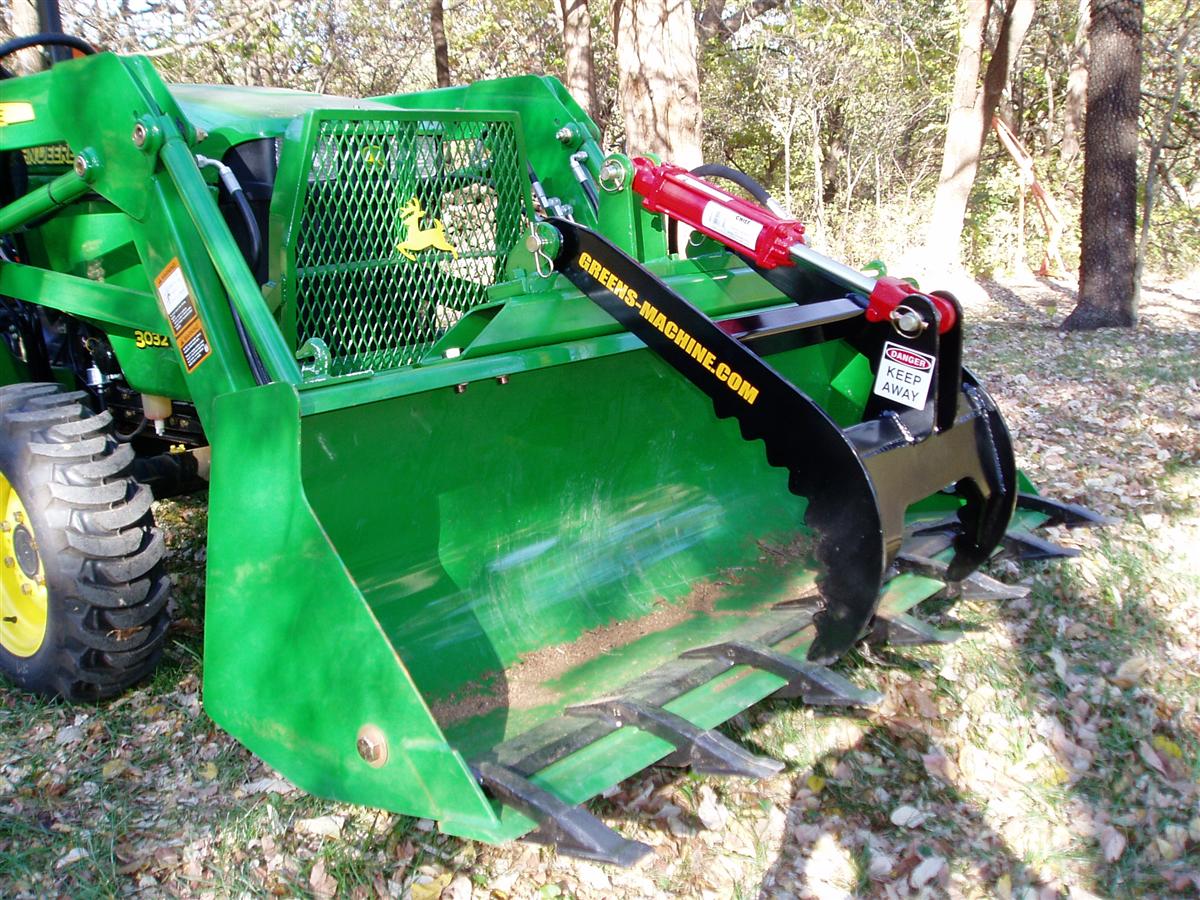

Don't know about "knowledge", but here's how I just put the same grapple on my JD 305 loader. The mount is a 36" chunk of rectangular 3"x4"x1/4" wall tubing, and there is a pair of 5"x12"x3/8" steel backing plates underneath the lip of the bucket where the bottom of the tubing is bolted. Seems to be plenty rigid so far, no bending, no problems, and no welding to the bucket required. As a bonus, the tubing also served to raise the base of the 28" grapple so the tips contact the leading edge of the bucket properly when closed and give me the maximum jaw opening possible when opened. However, as others have already said, I also recommend you add a tooth bar, makes a lot of difference when handling logs, rocks, and such.
That is a thing of beauty........but my grapple is only 20" and works perfectly mounted on top of the bucket. I could turn the C-channel upside down, and drill & bolt it on the underside of the bucket to have the strength AND the fit...........
BTW, who made the tooth bar? I did just order one, found it on eBay.....excellent quality and price.
Iowa Farm Equipment. Bought from their Ebay outlet "tractorparts247" w/free shipping (received it in three days, but it only had to go from Iowa to Oklahoma). Solid tooth bar, they make good stuff.

Yep, that looks like a winner, should do the trick just fine. You'll be amazed at the extended utility of the bucket using a tooth bar.
