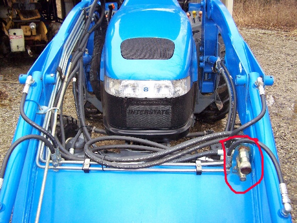

Attached is a picture of my loader. When I bought it, it had 1/2 hoses and the connectors seen in the picture. They appear bigger than anything I have used. The other end of the hoses have 90 degree elbows that are set up to hook into my rear set of hyd. I think the person who had it before my used some kind of front blade. How do I get it changed over so it will work with my grapple?

So those 2 connectors have hoses that run back to fittings that are then connected to a rear remote?
That being the case, you simply connect the fittings to the rear remote and use the lever that controls the rear remote to control the grapple.

Well, yes. In the picture it is hard to follow, but the hoses run up the loader arm on the left as you are looking at it, I then have it doubled back to the front of the loader for storage. What you can't see are the ends which, yes, go back to the rear hyd which are controlled by the remote. So yes, if I just want to operate it by the remote, it would work. But, my question is about the bracket on the loader that holds those two fittings. They are larger than anything I have used and the hose size says 1/2 inch. As posted above, it appears the 1/4 inch should be used. So, can I use the 1/2 inch hose, and can I use these fittings, switch them out, what do I do?

I think you will find that 1/2" hoses are way, way too large for your grapple application. Feathering the grapple will probably be difficult at best. All I can say is try it and if it moves too fast then go to a smaller hose diameter or put restrictors in the lines. I know for a fact that 1/4" works great and 3/8" is fast.
