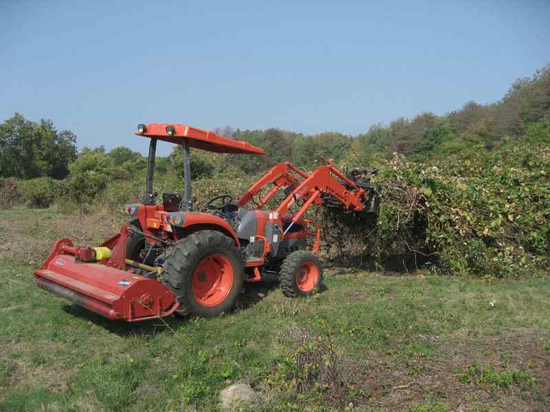

A 48 inch grapple weighs about 300-350lbs. A 72 inch grapple weighs about 700lbs. That means 350lbs less net lift capacity on any given loader. A 48 inch grapple with therefore carry more logs and trees than its 72 inch cousin as well as costing about half as much.
With regard to brush, I've never had much of an issue getting as much brush into my 48 inch grapple as I could manage. The problem is mostly that you cannot see where you are going but that would only be made worse by having a wider grapple.
Can you lift this much brush with a 72 inch grapple? Can you lift a stump this large with your remaining lift capacity on a 20hp tractor (1070lb lift capacity).
You are correct, the 72" grapple weighs roughly 750lbs.
With my L3600 I can lift the grapple fully loaded with brush and the tractor doesn't think twice about it. But I am also dealing with a larger tractor than what you are, so that makes a big difference.
What works for some, doesn't work for others.

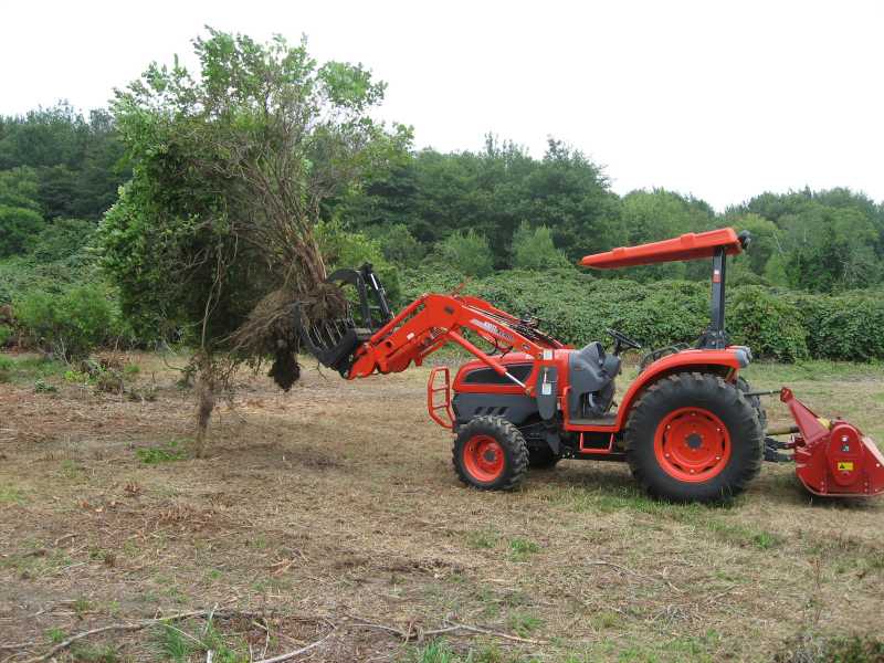

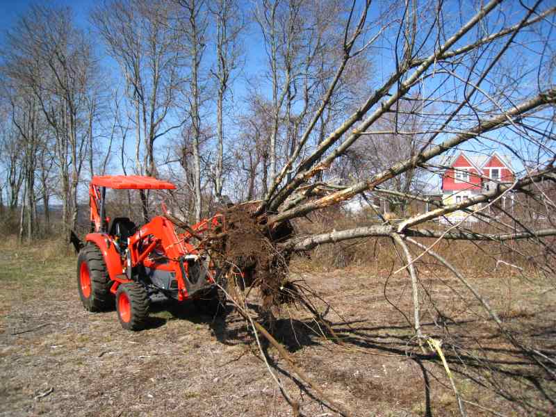

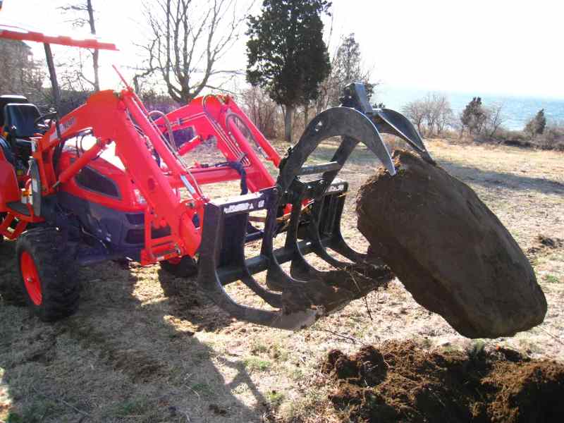

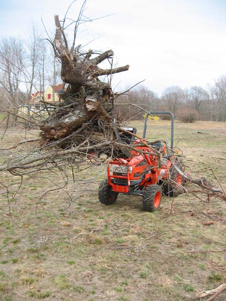

I posted photos from my old tractor. I now use a Kioti DK40se with a loader lift capacity of 2700+lbs and use the same grapple. I've never wished I had bigger and the 48 inch light duty grapple has done all I've asked.
One other advantage of the narrow grapple is when digging roots you are putting your breakout force into a smaller area and hence put more on the roots or rock you are interested in and don't waste a lot of the force on irrelevent ground on either side.
Here are a few photos from the new tractor plus same grapple:
