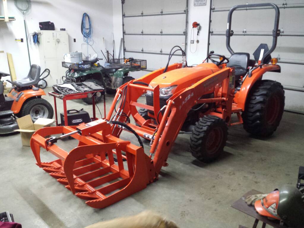

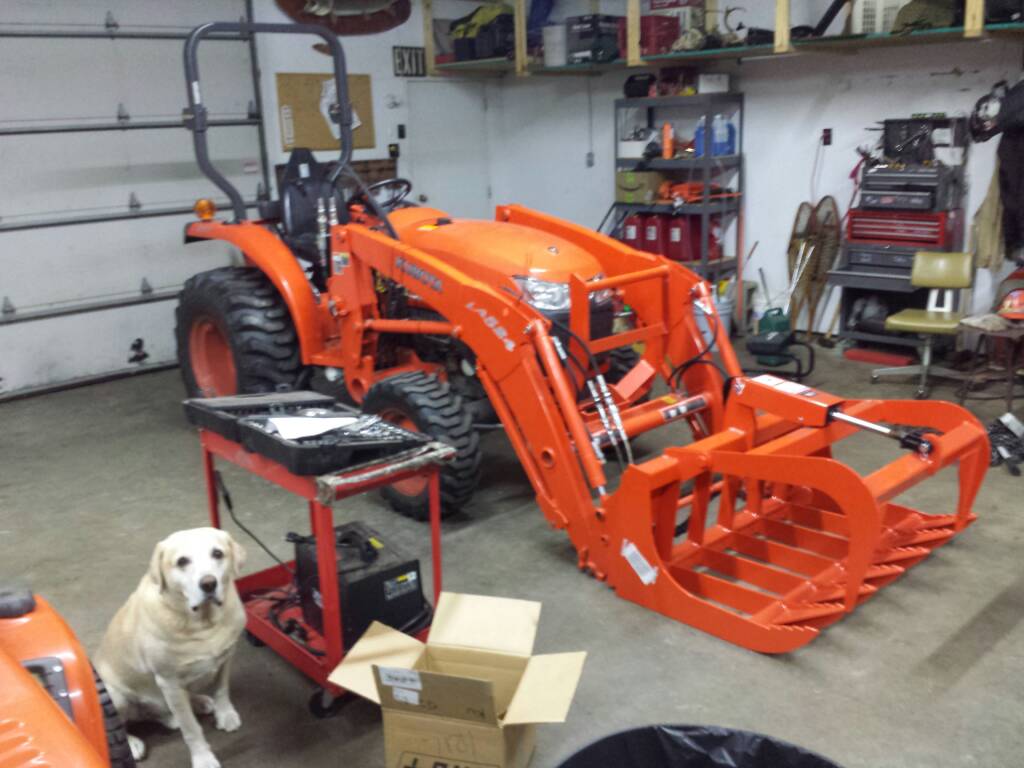

I use the grapple far more than my forks for brush/tree clean up. Not sure on your tractor size your considering but I just have a 48" single cylinder grapple from carolina attachments. Cost was only $900 and it's built here in the USA and seems to be built pretty stout. I spent about $1700 total for grapple and 3rd function. Great for brush and logs. View attachment 585859View attachment 585860
That wouldn't be such a bad option. Alot better than some of the prices I've been seeing for 3rd function install and the cost of the grapple. Every dealer I've talked to charges right around $800-1000 for the install. Then I had only found grapples in the $2000-2500 range. But guess it really depends on the tractor I decide to go with.
