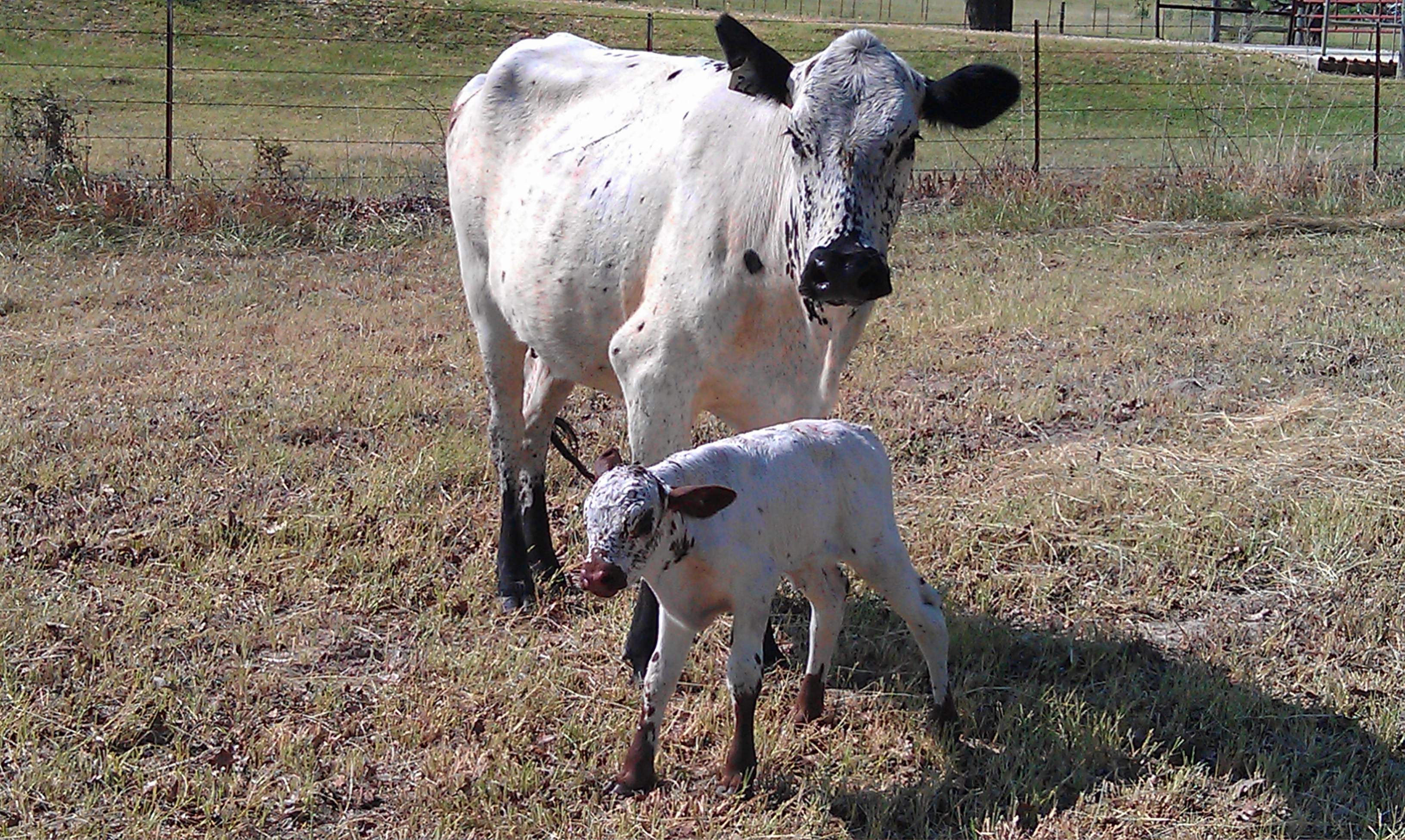

I had more longhorns but sold them,didnt wonna deal with the horns getting put in places they should be going while feeding:eek: I only kept one but she is crossed with black angus. I just sold the little bull calf saturday he weighed 310lbs and brought $542.50 his daddy was a beefmaster.
