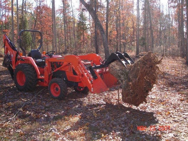

I bought a Tatro bucket grapple for $400 http://www.tatrosite.com/
and a WR Long valve kit ($600) Valve Kits for my B7800 a few year ago.
No rear ports required and I can use the QD hoses to power a hydraulic splitter when I buy one.
For a $1000 total it has been a great investment for me as I use it often for moving the maple trees I fell for firewood. It stays on all year round now.

Someone asked my to post quick instructions for installing an extra valve to the power beyond. Any detail questions would be better directed to the hydraulics forum but here goes.
dangerdockubota
The hose exiting the front of the joystick is the power beyond and formerly inserted into the hydraulic block below. Connect this to the input of your new valve. Make a hose long enough to go from the exit of the new valve back to the hydraulic block, closing the loop.
Make two hoses that go down the front loader to your new grapple.
I hope this helps.
