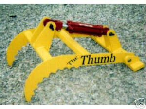

   / Grapple #2
Google "Bro-tek Thumb" or go to Bro-Tek: Tractor Add Ons. I bought one last year for a L2250 Kubota and couldn't be more pleased. I use it to hold 30' logs for wood cutting, picking up and hauling rocks or anything that needs moving. The unit is well made, inexpensive, approx $300. and can be installed in minutes. Richard, at Bro-Tek, says he can build a Thumb to fit any tractor with a hoe.

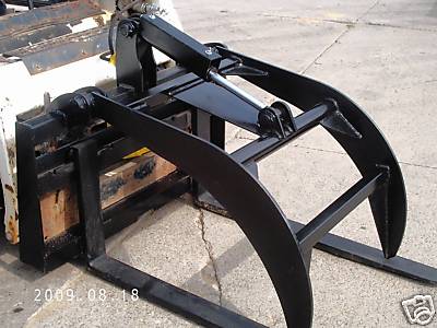

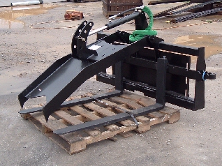

   / Grapple #7

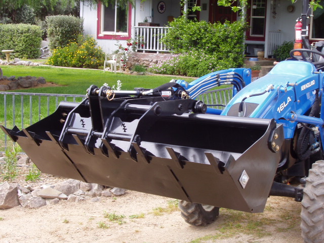

   / Grapple #8
You might want to check http://michironandequip.com. Scroll down to their grapple section, BTW they are also a Kioti dealer. I have one of their grapples-first one built by them for a NH TC-40S. They sent me an autocad drawing for measurement approval before fabrication, right on the money, a perfect full 10" hydraulic cylinder extention when closed on the empty bucket. Even if it were slightly off one way or the other, the hydraulic cylinder rod is threaded for adjustability. 24" wide, four 1/2" thick tooth arms re-enforced to 1" (1/4"-1/2"-1/4") wide at the four tooth tips.
This grapple is designed with a wicked over-bite so if you are at all thinking of a toothbar, do so now to ensure no interference between the two sets of teeth mesh.:)
   / Grapple #9
You might want to check Michigan Iron & Equipment: Kioti Dealer. Scroll down to their grapple section, BTW they are also a Kioti dealer. I have one of their grapples-first one built by them for a NH TC-40S. They sent me an autocad drawing for measurement approval before fabrication, right on the money, a perfect full 10" hydraulic cylinder extention when closed on the empty bucket. Even if it were slightly off one way or the other, the hydraulic cylinder rod is threaded for adjustability. 24" wide, four 1/2" thick tooth arms re-enforced to 1" (1/4"-1/2"-1/4") wide at the four tooth tips.
After using my root grapple for a few years, I'm thinking that that type of bolt on bucket grapple has to be the way to go.. put it on and leave it on.
   / Grapple #10
It does actually un-pin from the bucket in a couple of minutes leaving only the torque bar in place.
