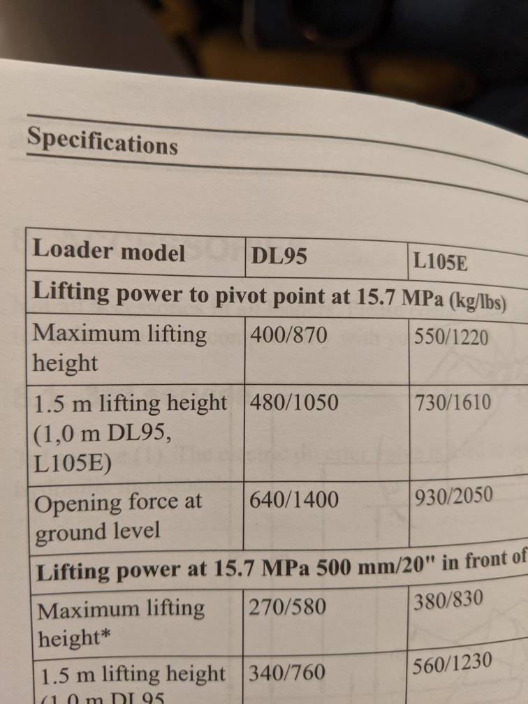

If your tractor has the DL95 loader you won't have enough lift capacity to effectively use a grapple. Even that high dollar EA grapple will only leave you 340 lbs of lift capacity.
   / Grapple!!!! #16
I think your math is off. Lift capacity at pin is 870lbs. SSQA eats 75lbs or so. Grapple is 225lbs. Even with the attachment forward an inch or 2 your still in the neighborhood of 570lbs or full height lifting capacity. IMG_20191019_185530.jpg
   / Grapple!!!! #17
I think your math is off. Lift capacity at pin is 870lbs. SSQA eats 75lbs or so. Grapple is 225lbs. Even with the attachment forward an inch or 2 your still in the neighborhood of 570lbs or full height lifting capacity.View attachment 625330
I was working off the 580 lb capacity 20" forward of the pins.
