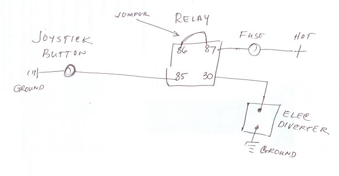

Thanks for getting back to me PineRidge, I have a relay already, just not sure how to wire it up, so if you could send me the diagram.

/ Grapple #67
I hope you don't take off points for neatness. /forums/images/graemlins/grin.gif

I'll give you an A+ for neatness. Thanks PineRidge, now I can fully complete grapple project.
