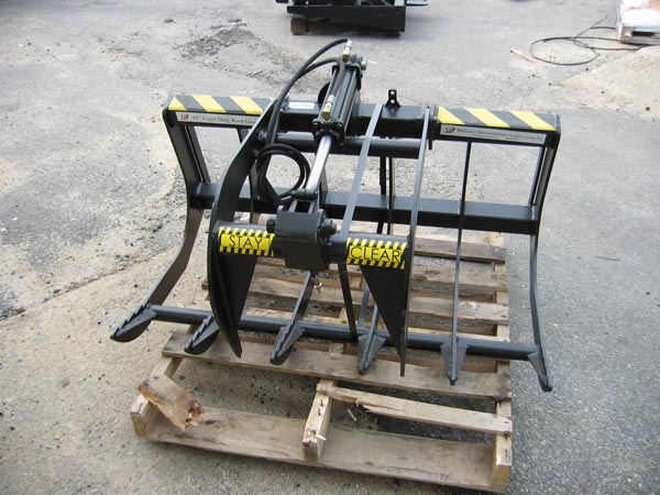

With some designs of light-duty grapples it is possible to bend them if you don't apply the force in a straight line -- so be careful of pulling sideways with the teeth, or carrying heavy loads pinched with only one tooth...
I bent one of the outside teeth (or fingers or whatever you call them) on my PT's grapple bucket trying to move a big log sideways by articulating the tractor. Note that these teeth have no lateral reinforcement in the last 12" - 14" or so...
http://loonlanding.info/2_IMG_0053.JPG
   / Grapples Galore #78
No lateral reinforcement for the last foot or so will certainly cause problems when you do put a lateral force on the teeth. Most grapples seem to have more reinforcement than yours. I think mine has reinforcement up to about 5 inches or so. Still, the type of operation you describe is exactly the kind of lateral stress that no grapple is really designed for. They are engineered strictly for up and down, forwards and backwards forces, not lateral. Then again, that is exactly the same as an FEL so almost anything that could damage a grapple could also damage or torque FEL arms.
