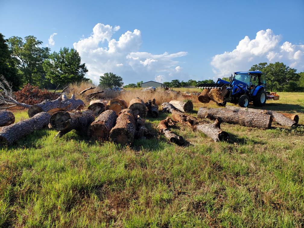

Took a while to move these. First job with the new workmaster! 20200624_181156.jpg

Nice looking setup. :thumbsup:
