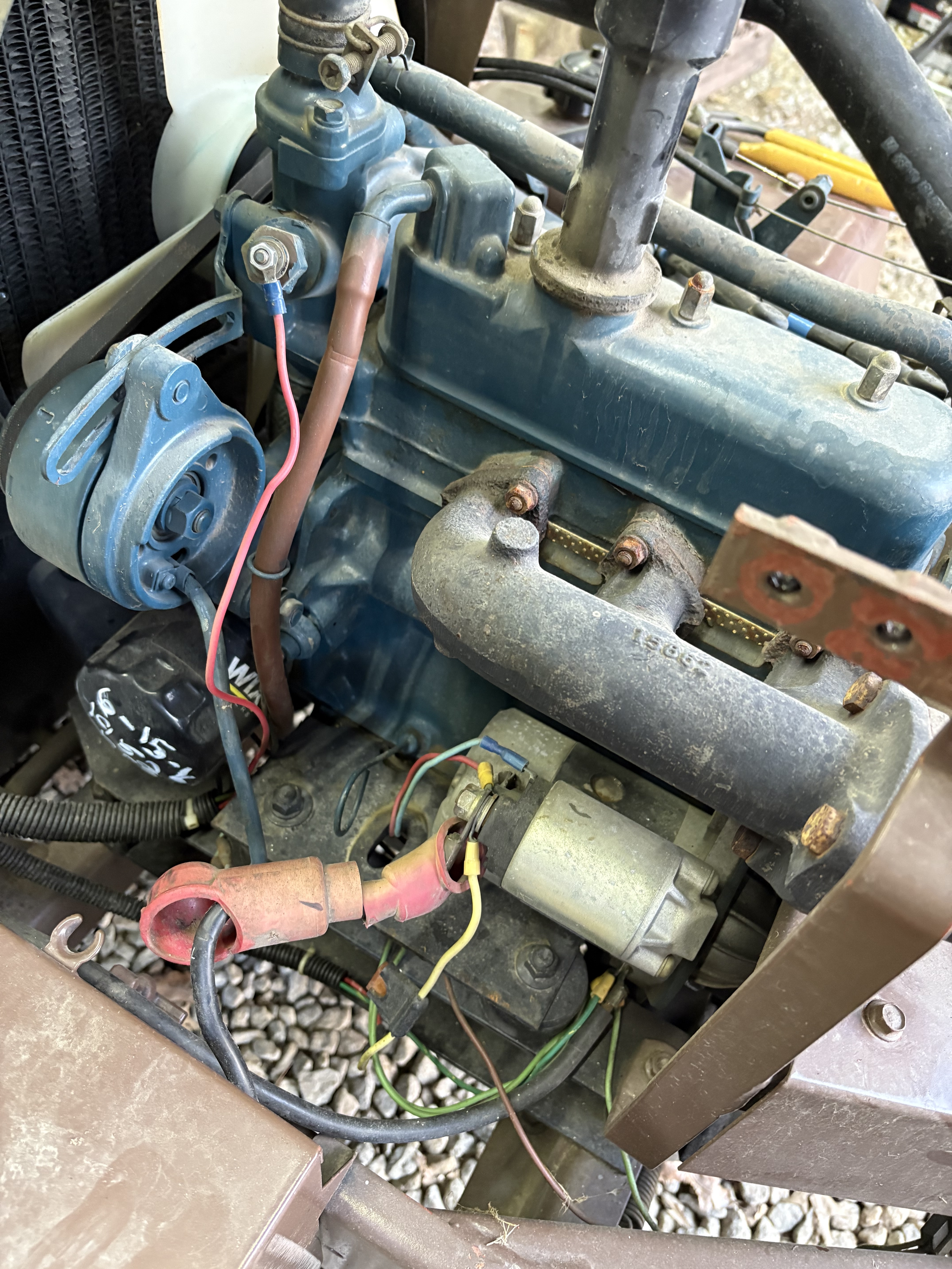

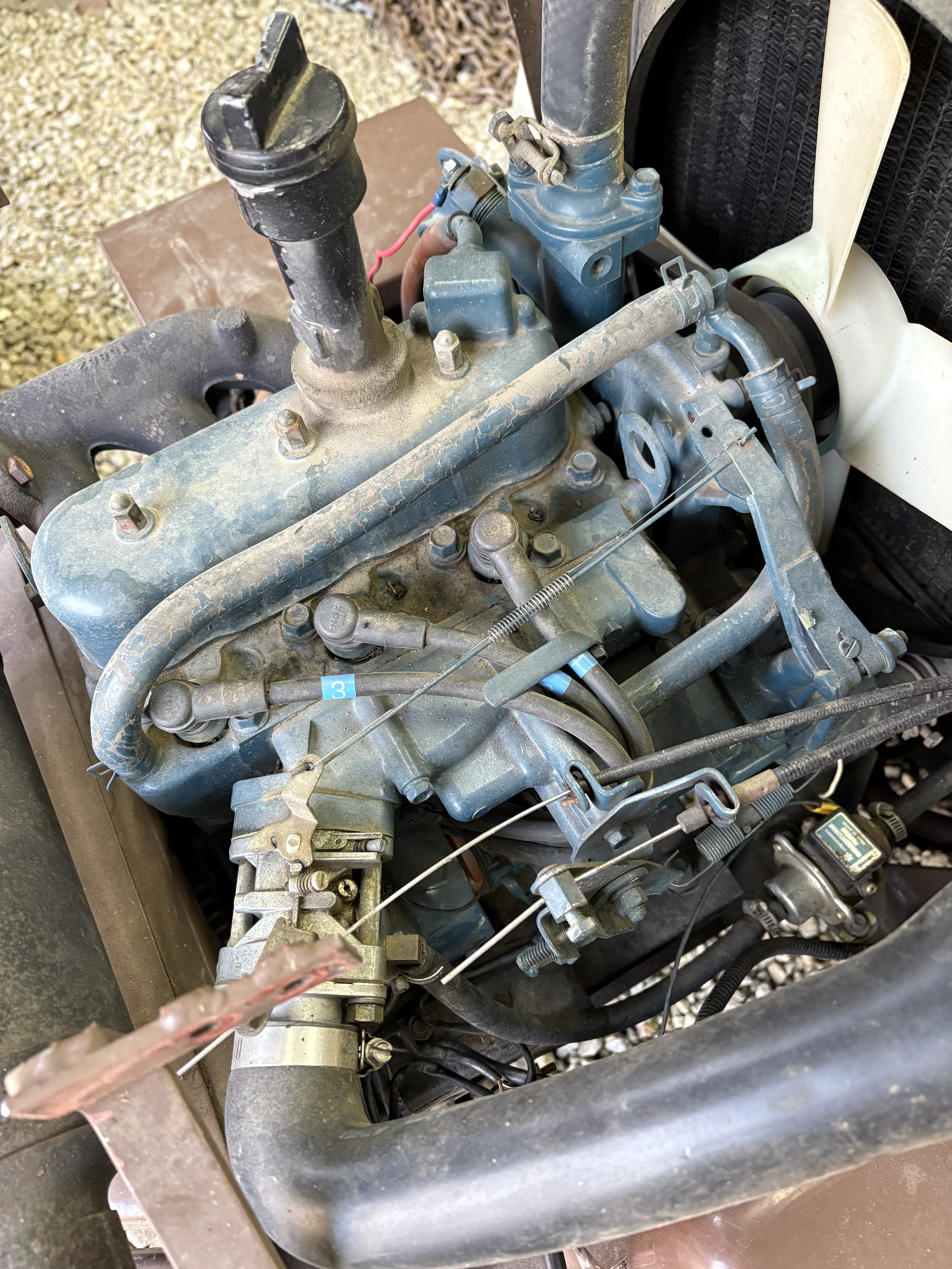

Here are a few pics I could get today

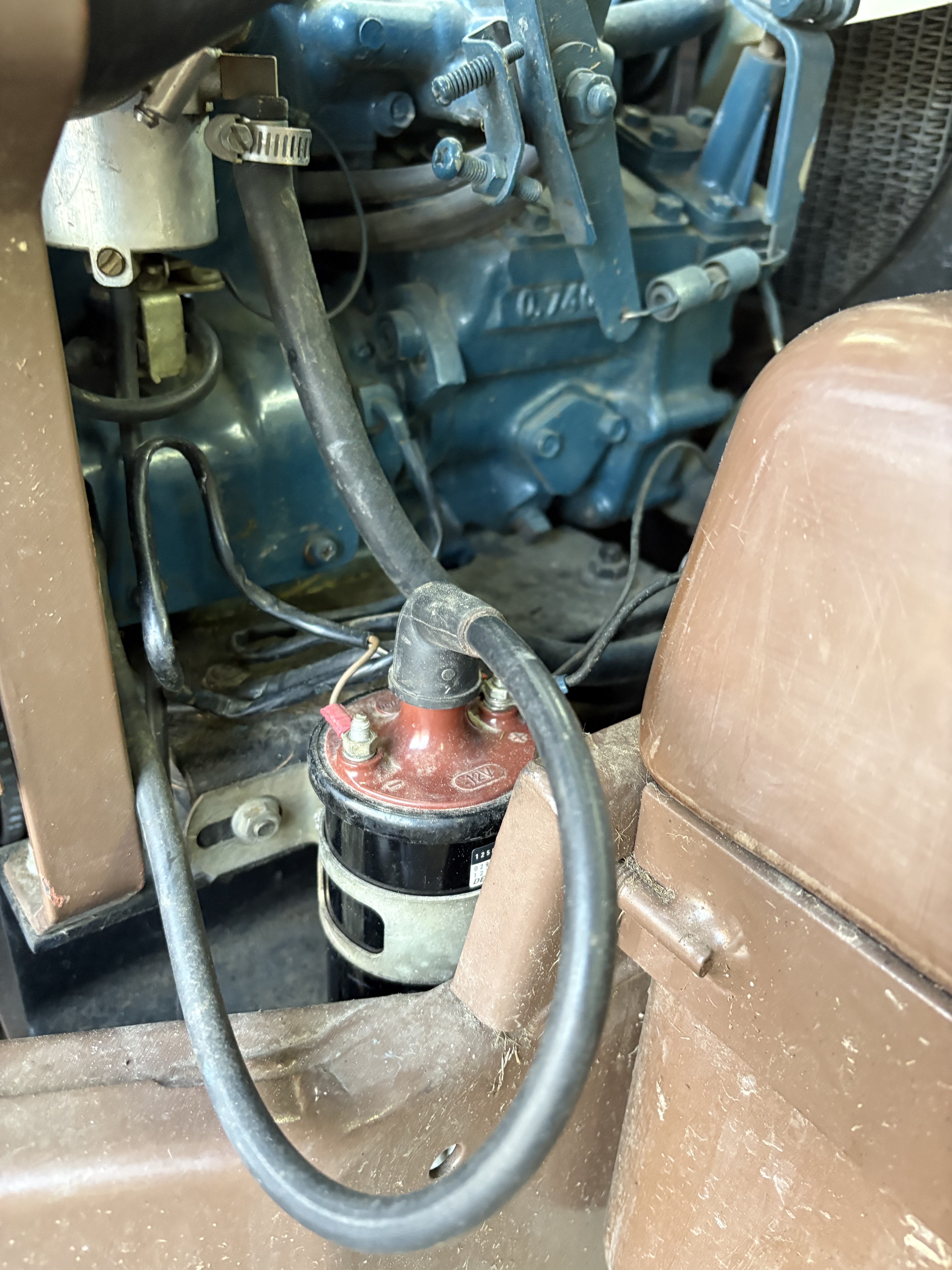

That coil doesn't look original. Quality is suspect. I'd try a new (good brand) one.

Have put 2 different coils on and both test out good per meter and testing.

Just watched a YT video on a mower with the same symptom. Turns out (in this case) it was a faulty gas cap that wasn't venting. After a time of running, it creates a vacuum lock and won't let gas flow to the carb. Try drilling a hole in the gas cap, or in the filler neck right below the gas cap to vent it.
No guarantees, but worth a shot.

I thought about the fuel pump. I took the hose off and it’s pumping fuel to the carb. So shouldn’t be the gas cap. It’s stuck right now in the drive, so hoping it was an easy fix

Vent clogged in the carb? It needs atmospheric pressure on the bowl.
I don’t believe it’s fuel related. As spark disappears after warm or hot

A common problem with tar-packed coils is they warm up and internally short much more frequently than oil-packed ignition coils (wow, now you know I'm old school if I know that, smile).
That said, this thing doesn't have a pickup coil or electronic ignition, does it? They too can work fine when room temperature but then have an open when hot and fail.

I tested the coil with meter both cold and hot and had same readings. Coil was actually cold to touch when it shut down.

Well I checked all grounds, switches, relays and safety’s. All check out. I replaced the plugs and the distributor and seems to run great again. We shall see. Thanks
