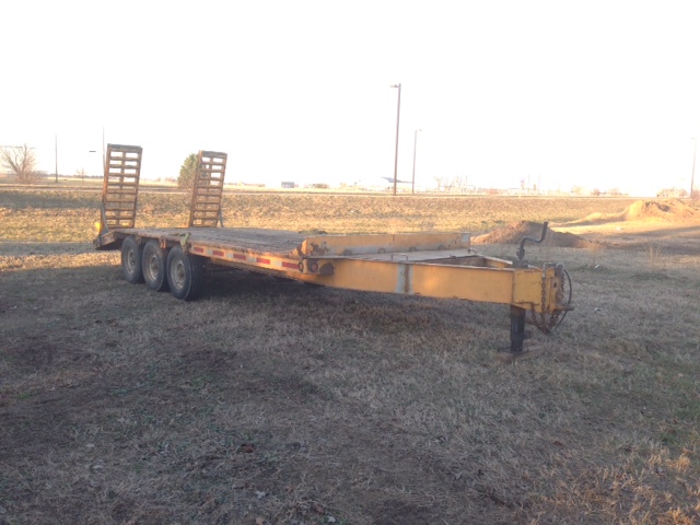

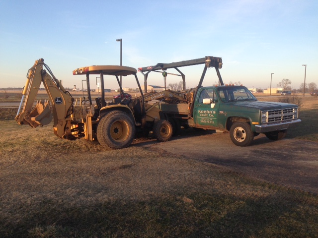

Went for a walk in the cemetery after dinner. The grave digger equipment was there today. Here's what they use.
A JD110TLB, an older Chevy 30 truck with a vault crane on the bed, and this trailer to tow the TLB.
The TLB has turfs on the back and R4s on the front. It also has a 4-in-1 bucket. There's a stack of plywood in the back of the Chevy that the TLB bucket is rested on to keep from disappearing overnight, I assume. That, or keep the truck there, or the tractor there, or something.
My guess is a larger dump truck towed the trailer and TLB there.
