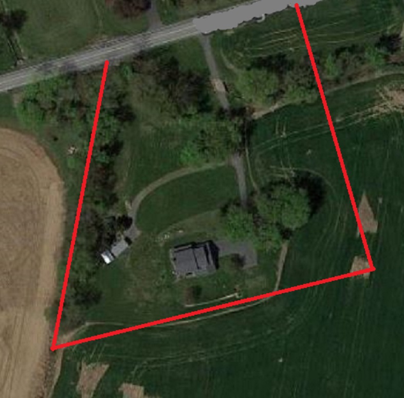

We took out the rocks and trees on the right, and put down gravel just to past the bend where there is a bridge. Maybe 500 feet. We used 125 tons...

Garandman, you're site looks almost exactly like mine, except my circular drive has an island of (4) Loblolly pines, and (1) White Pine. I wasn't excited about the amount of soil and trees that were initially removed, but after driving my truck in and around the site, quickly realized that elbow room is good!
