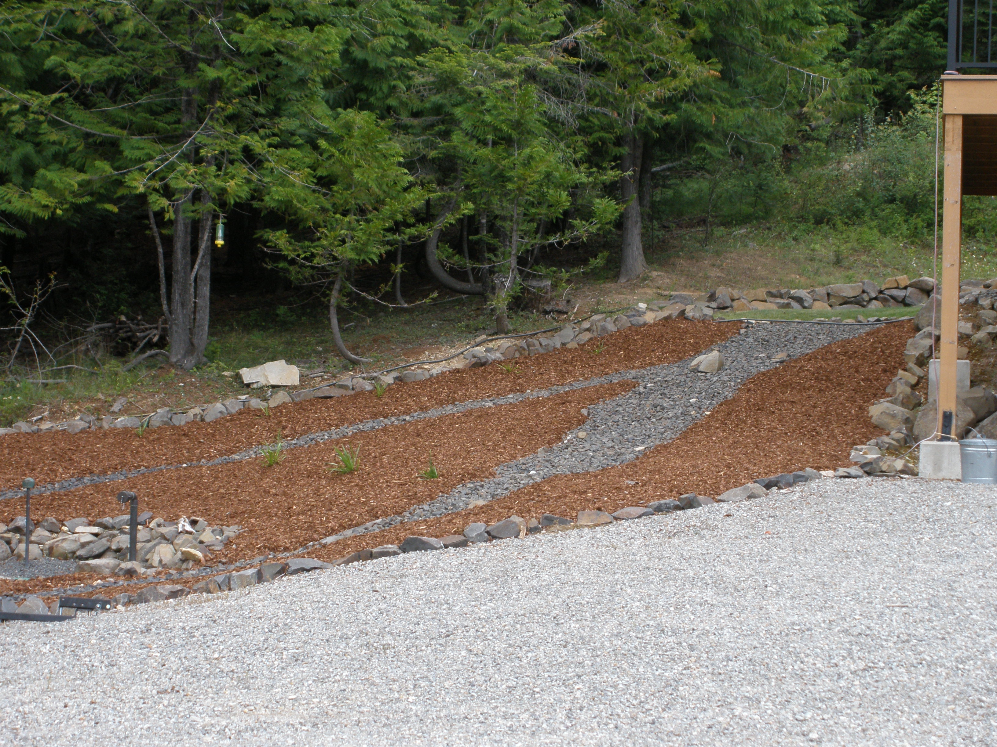

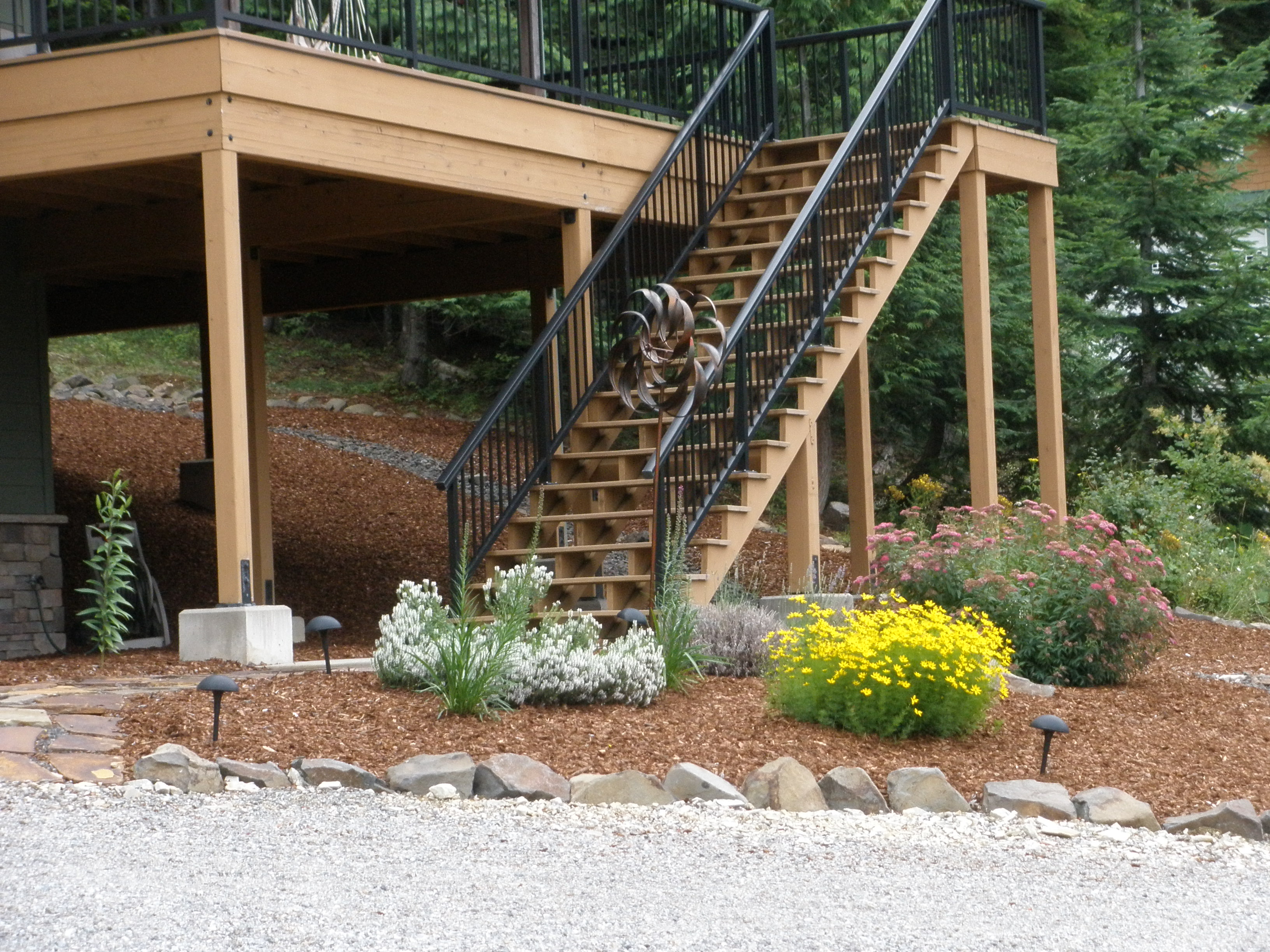

   / Gravel Driveway Do-Over Advice #28
I used basalt rocks about head size and smaller as a border. I followed the contour of the driveway, I think it gives the border a natural look, my way of not having to place them exactly in line. My gravel stays out of the bark and visa versa. I stay a foot or so away when plowing in the winter and if I move them (another reason for the natural look) they are easy to move back in the spring. The small amount of gravel I do get in the bark is easy to hide by raking the bark over it. It would be a little different for grass but much better than what you have now. I would recommend a shallow trench about 2" (round pt shovel wide)along the driveway to set the stones into to help hold them in place. Granted I am not a professional landscaper or mason but where I live only my wife and our visitors see it.
#29
View attachment 473862 View attachment 473863
Looks nice!
