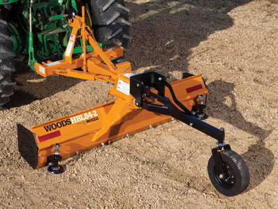

Well, I think that's a good list. I had a hydro, now I have a 12x12 shuttle. I like them both and I think either would work for you. There is some plus or minus - under over on your list. If it were me this would be my list:

  7. 7' or 8' Heavy Duty Rear Blade WITH Tail Wheel (you need the weight AND the tail wheel - Landpride, Bush Hog, Woods or??)The tail wheel takes out the woops

The Tail Wheel is the most important option on your list.
