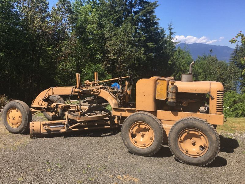

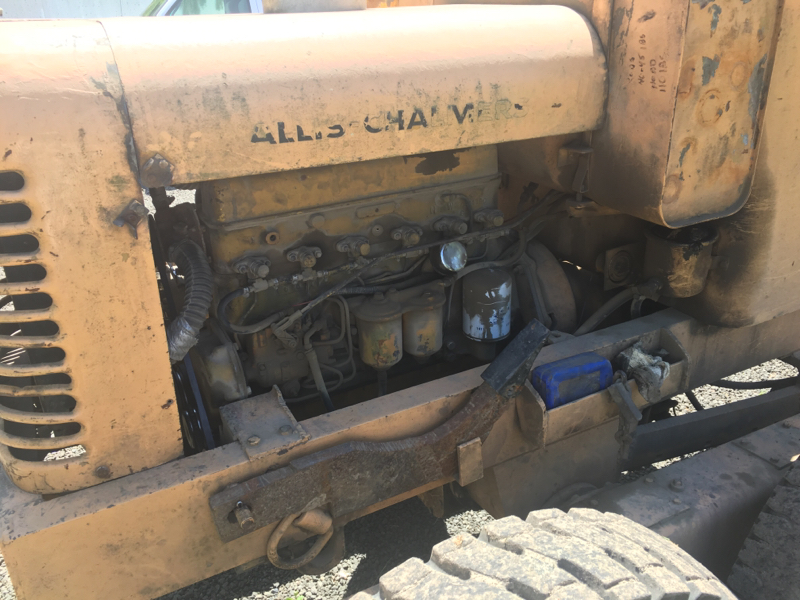

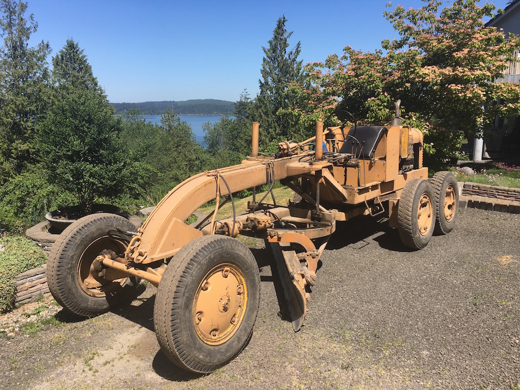

Guilty here as I admit I haven't used the search engine but just finished grading my shared gravel driveway. It is sloped and about 1000ft long 14ft wide and develops a bad case of washboard bumps over the course of lousy driving skills mostly by visitors. Anyways we graded, added 5/8in crushed, graded again, watered and then Vibration rolled it. It is very nice now. The neighbors are interested in using some kind of natural binder to cut down dust and maybe lengthen the time between major maintenance. The driveway is crowned nicely and we have great water control along its borders but the washboard bumps are brutal on one of 80+ year neighbor lady who has metal plates in her back. Here is the grader... Aliss Chalmers. Any guesses on year?
Anyways, does anyone have experience with adding natural binder? Looking at applying liquid Magnesium Chloride as one possibility.

1963?

I love old iron...I would totally rock that.
   / Gravel Driveway Maintenance thoughts? #5
A great piece of old iron. I see you have found that a motor grader is the best method to maintain a long gravel driveway. Certainly wish I had access to a piece of equipment, such as that, to maintain my mile long gravel driveway. I would guess that it dates back to mid to late 50's.
