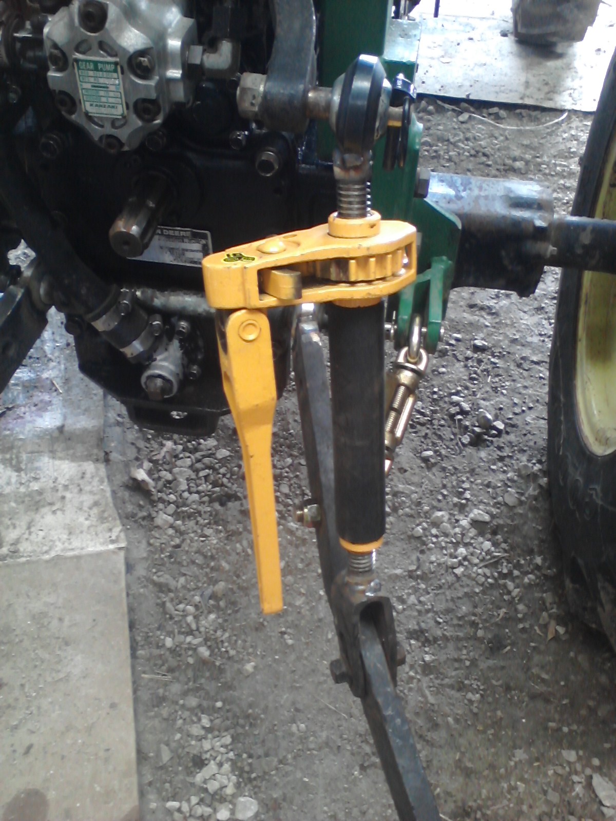

I made an adjustable side link out of a rachet binder with a folding handle. Makes adjustments quick and easy.
